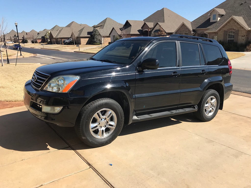

Hey everyone, just picked up our GX last Friday to replace our 3rd Gen 4Runner in anticipation of our little girl that's due in June. I've already learned a lot reading the forums, and am glad there's an active community for these rigs as well. First step for me is addressing the rear suspension issues that the car seems to have despite the dealer saying that it had been checked over and is good to go. I have a set of Moog springs on the way and am planning on getting the Metal Tech lower kit, but am trying to find a better solution for the upper spring isolator. Anyone found a solution other than spending ~$150 on 4Runner isolators? Looks like they're 6.5" OD and 5.25" ID. Thanks for any help, here's a pic of the new (old) rig.
