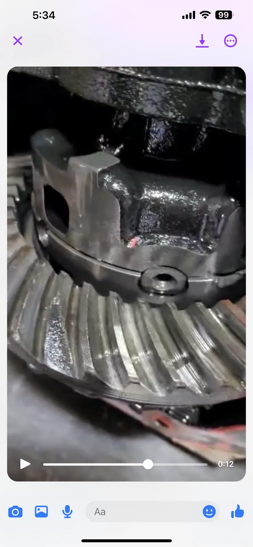

Had a clunk when I bought it, and lo and behold noise coming from the front Diff. The one thing I can’t fix myself (setting up gears is just beyond my skill set) so it’s in the shop to get that sorted.

There are a few bushings that mount the front differential that have been the cause of clunks... more likely the culprit vs caused internally.
Thanks for the heads up! I’ll have mention it to the guys at the shop for sure.
I figured the front end should be stout, but you never know how the last guy treated it.
I very much agree with @hoser Front diff bushings are very common issue on the forums. Good chance they have never been replaced and are already in bad shape and/or dry rotted.
Update. Diff is out, 2 teeth broken on ring gear so I’ll have to rebuild. Everything looks good so just ring/pinion and then a rebuild kit(bearings/shims and whatnot). Anyone have a good source on parts? I’m in Canada if it makes a difference. Rock auto has what I need, but wondering if there are better options?
