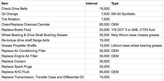

So I just got a new to me 2004 LX. I always buy used, and as many do, baseline all maintenance soon after acquisition.. Well, in trying to get my head around this one and perhaps being a bit overly detail oriented, I created a maintenance schedule on Google Sheets which I will share. I've added a couple things to it besides the factory recommended based on information found here on Mud.
Please take a look, feel free to grab a copy from the link to use, and I'd love any advice on items I should add to it. Here's the link (which, if you use the link, you can add comments too which could prove interesting)-
LX 470 Maintenance Schedule
I should add that its a work in progress...

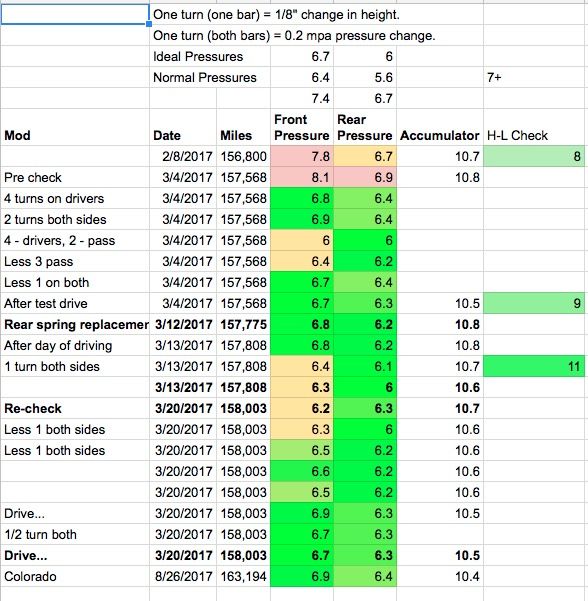

This is nice! Well done... I took a different approach, and I'll say yours looks nicer.

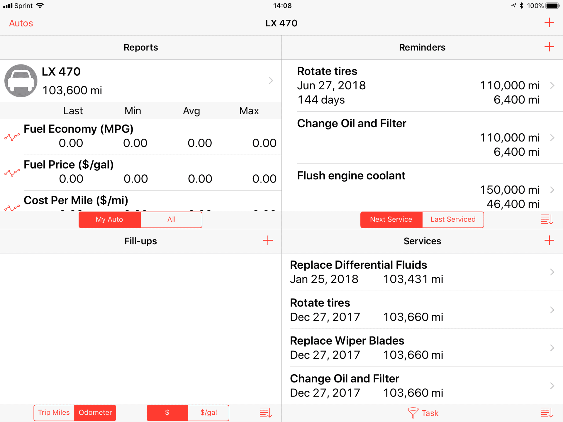

I’ve used an app on my iPad called simply “Auto Care” for a few years, but decided that the spreadsheet approach would work better for me. Some may find it useful though.
Here’s a screenshot. It just became cumbersome to make the entries. I’ll update the spreadsheet to go at least through 200kmin the next week or so too.

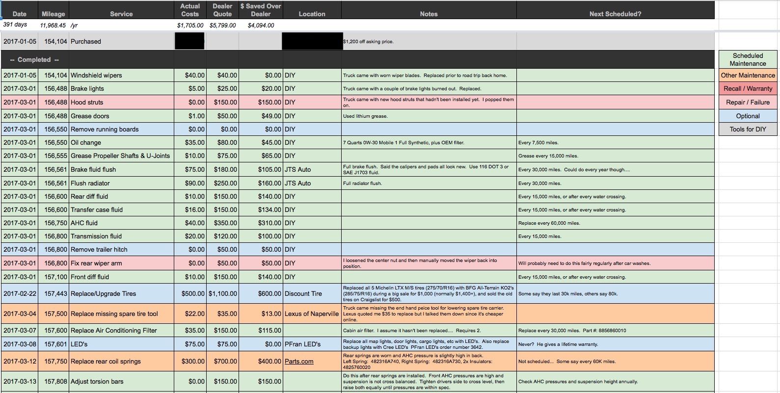

I’ve been massaging it more, with the checklist part going through 150k Service. I also included Heater T’s, fuel induction service, and replace Power Steering Fluid at 100k. None of these items are on the maintenance list included with the owners manual, but we’re either done on my truck, or highly recommended service here on Mud (Heater T). I added some part numbers and quantities as appropriate. Still a work in progress, like everything in my life...
Please take a copy, and leave a comment if you’d like. If there’s anything else I should add, LMK. I’ll keep adding to the checklist. I imagine at least through 300k.
I’m wondering should I put things like accumulators at 150k or something like that should just be a repair as needed.

Why do u replace spark plugs at 30k when they are rated for 120k?
Why replace driveline fluids too soon too?
60k miles sounds more reasonable but ur vehicle usage might deem it necessary to change sooner, but 15k is way too soon i think
Also, ur prices for driveline fluids are very low, what oils do u use and where u get them from?
Thank you!
