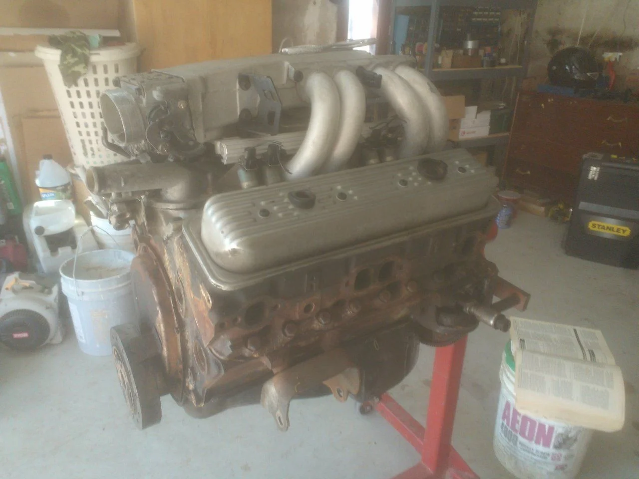

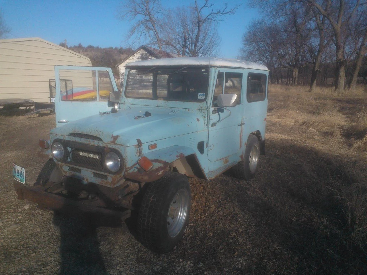

First off i have a 74 fj40 my dad bought in 78. When he retired 4 years ago he gave me it and drove it up untill a year ago. The fj is now on its way to being ressurected. I have a 350 t.p.i. w/700r4 thats going in it. Willpost pics soon.

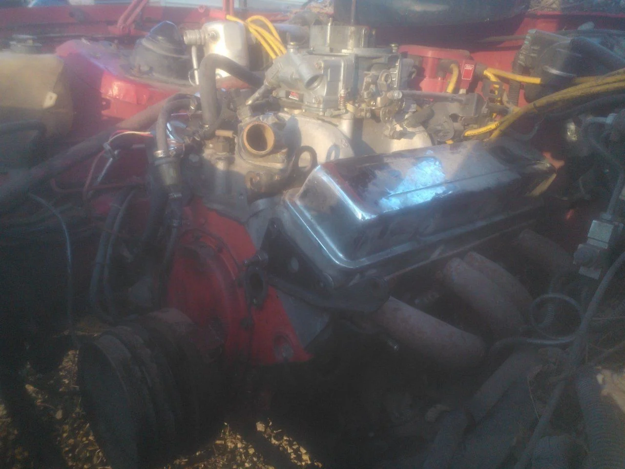

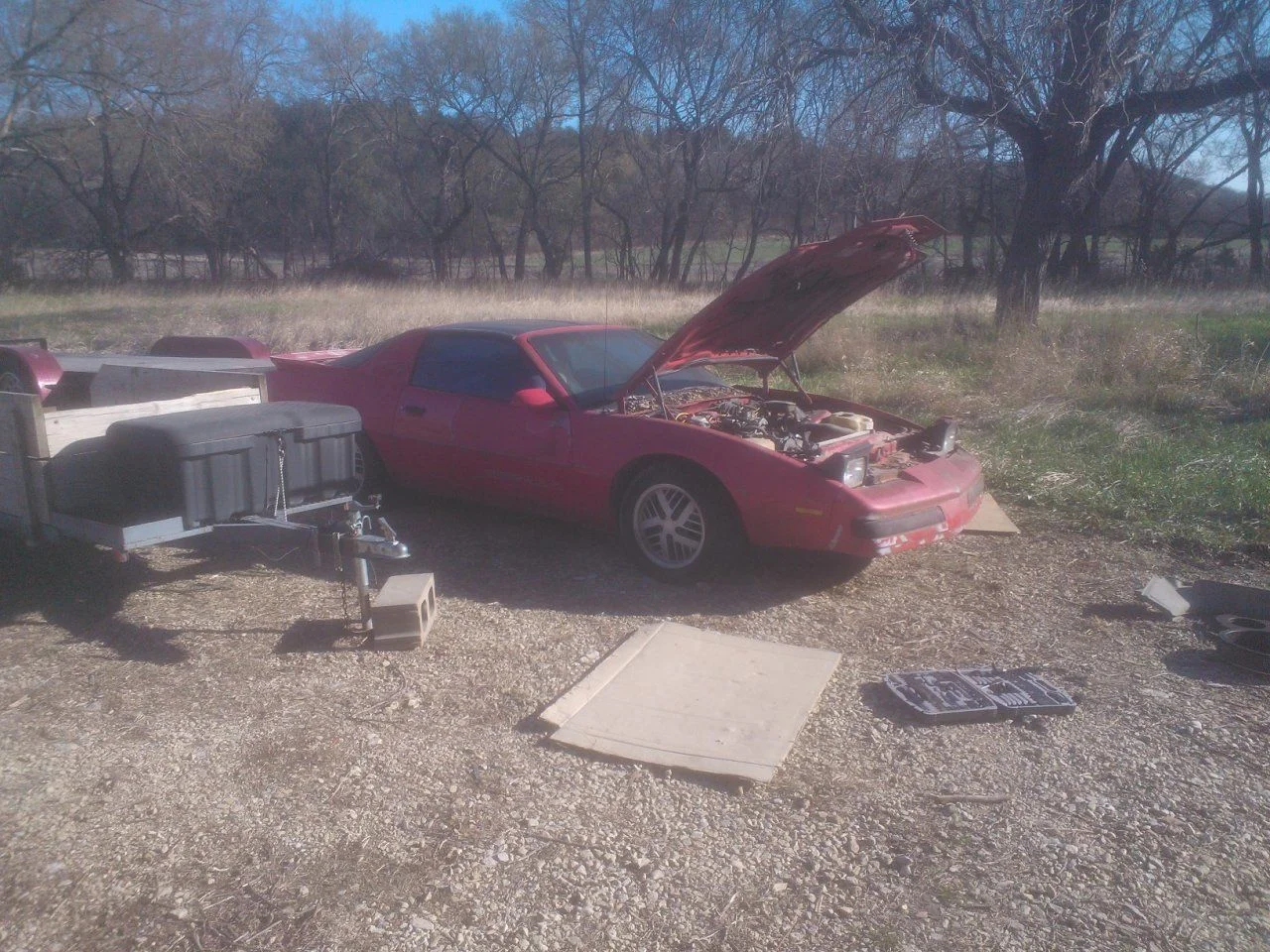

Got a new donor car with a built up 350 with Holley heads and aluminum rockers between the tpi and that I have pretty much a full awesome engine. Power steering gear box, steering column, and seats I am going to use also.
So the lunati cam and the flat tappet lifters that were in the second engine were trashed. I am still going with the tpi fuel injection anyone have any cam recommendations im boring 60,000s over also, if that makes any difference. I kinda would like roller letters too maybe.

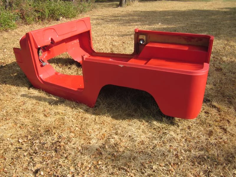

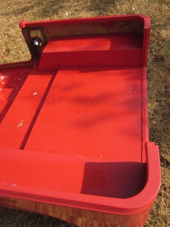

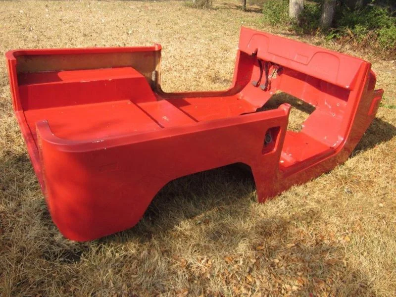

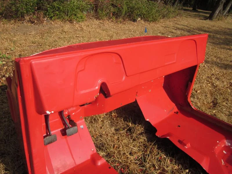

I have a fiberglass tub for sale
