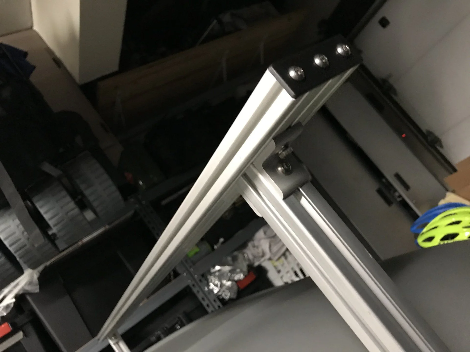

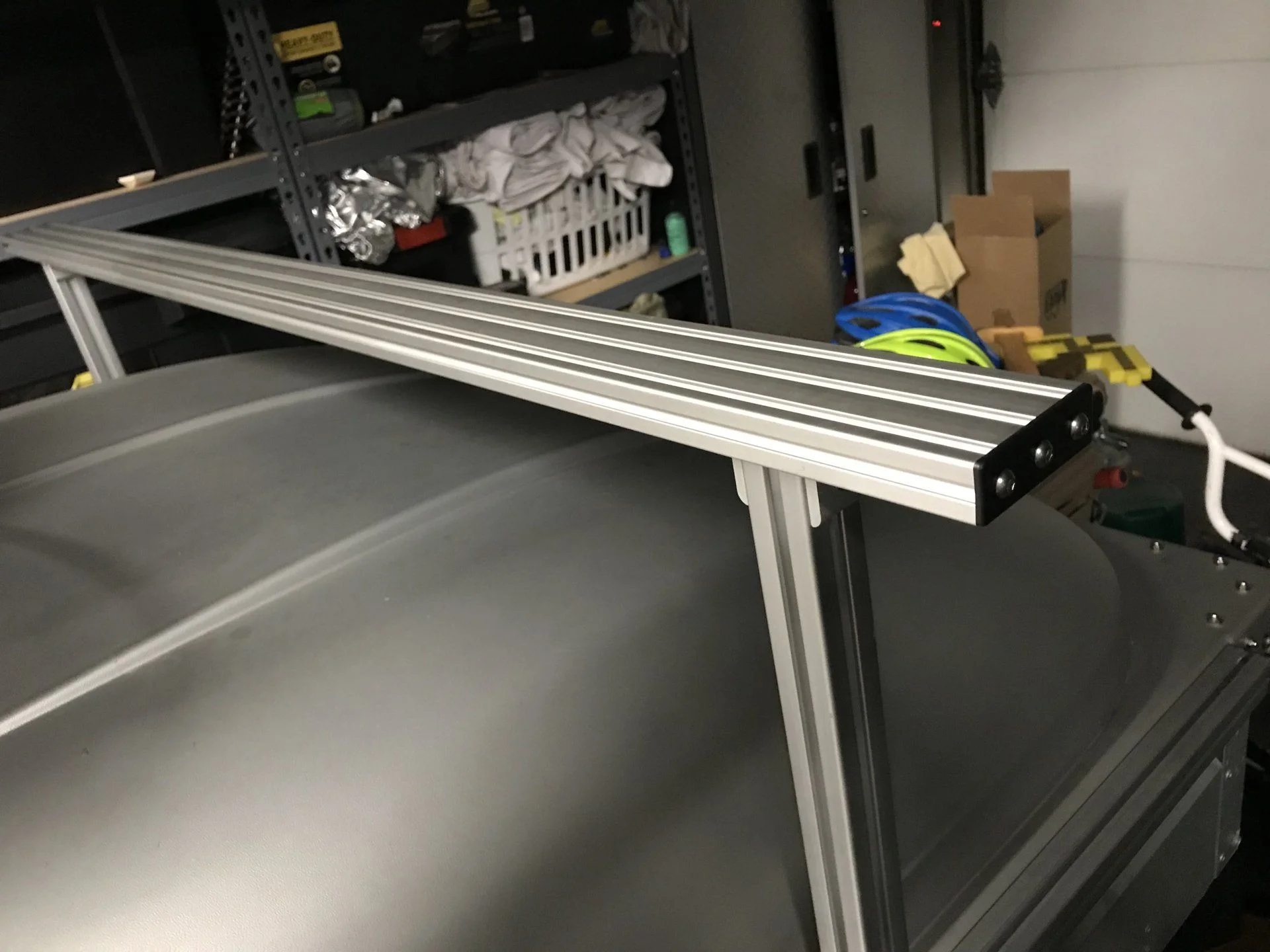

@Sir Velo here are the new 1x3 10-Series (note not 15 series) crossbars in place of the Thule aeroblade crossbars:
@perkj You could probably sell the Thule crossbars to defray much of the cost of the 8020 lol I have some of the plastic strips to cover the open channels if you want any, for some reason I bought more than I'll ever need.
@Sir Velo The Thule bars will be going back to REI. Wish I had thought of the 10Series 1x3 when I placed my origional order as I would have saved about $30 dollars in shipping :bang:. That said the 10-Series cross bars with shipping were under half the cost of the Thule bars :)
