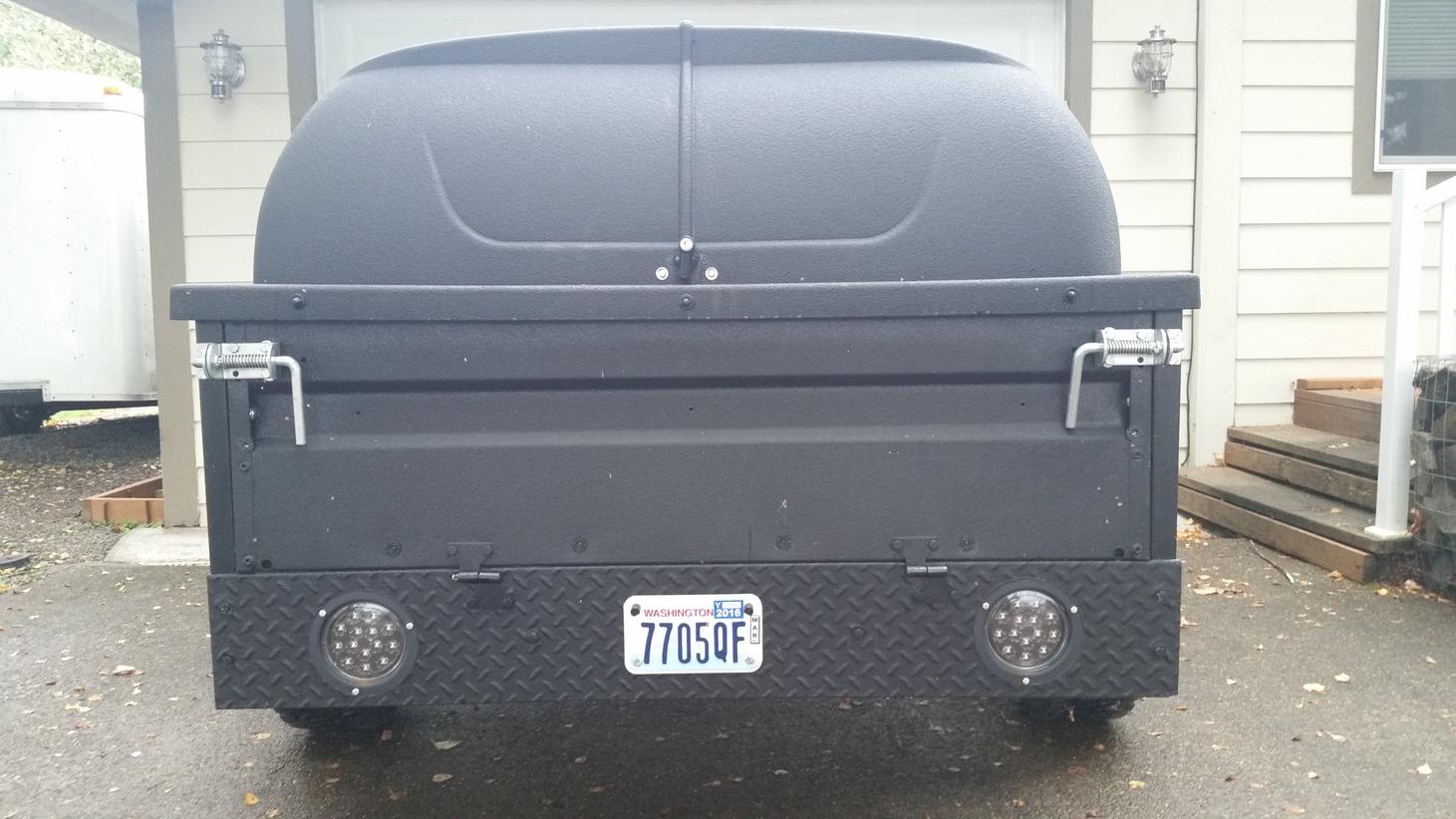

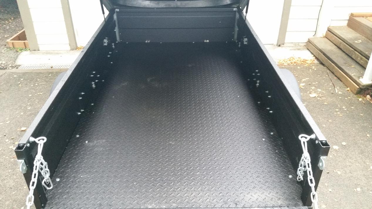

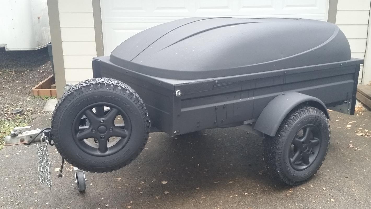

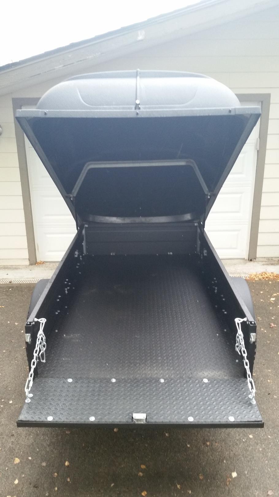

Hey guys and gals, thought I would post this here first for members before going on CL, Offerup, etc…. I have for sale a hard to find, near new condition, discontinued 2007 Thule Trailer that has been totally rebuilt. I bought this trailer at the beginning of this year, took the entire trailer apart, literally, replaced ever nut/bolt, and just don’t use it like I thought I would. I took this trailer all the way down to the frame and built it the way it should have been done. This trailer had original galvanized aluminum sides with a particle board floor and ABS plastic lockable lid. Here is a list of things that I did to the trailer during its rebuild:
* All rivets taken out, replaced with zinc nuts and bolts and added 6 tie down anchors on the inside.
* Upgraded the fenders from the original narrow plastic fenders to wider aluminum ones.
* Added a heavy duty trailer jack.
* Installed 2 spring loaded latches to secure tailgate when closed.
* Painted the rims, added 1 inch wheel spacers, and threw on brand new 195/75/14 BFG KOs with matching spare. Tires have less than 500 miles on them, spare tire brand new, never used.
* Replaced the particle board floor with a 1/8th inch thick steel diamond plate floor.
* Added new safety chains for towing, replaced the tail lights with new LED running/turn signal lights, and used bolt style LED license plate lights for a clean look.
* The obvious detail of this trailer is the entire thing has been Line-Xed inside out, top to bottom.
I got this trailer because I traded in my truck and having the 4Runner, I wanted a utility trailer for camping, hardware store runs, landscaping, going to the beach, etc. But since I have had it, I have used it less than a dozen times and hate to see it sit.
Trailer Specs:
*4 X 7
*16 inch high walls
*ABS Lid is lockable, easily removes for larger items to haul, and has 2 actuators for easy lifting and lowering
*Adjustable tailgate
*Weighs less than 500lbs so it can easily be pushed around
*Has a 1600lbs pay load capacity torsion axle
As you can see, a lot of time and effort has gone into this trailer and I wish I had more use for it, but I just don’t. This is a great trailer for a number of uses, trail ready, and never have to worry about scratching it. Current registration is good until March of 2016 and I have a clean Washington State title in hand. I am asking $3800 OBO, no trades, sorry, cash only. Let me know if you have any questions about the trailer. I am willing to travel between the Seattle WA and Portland OR area for serious buyers.

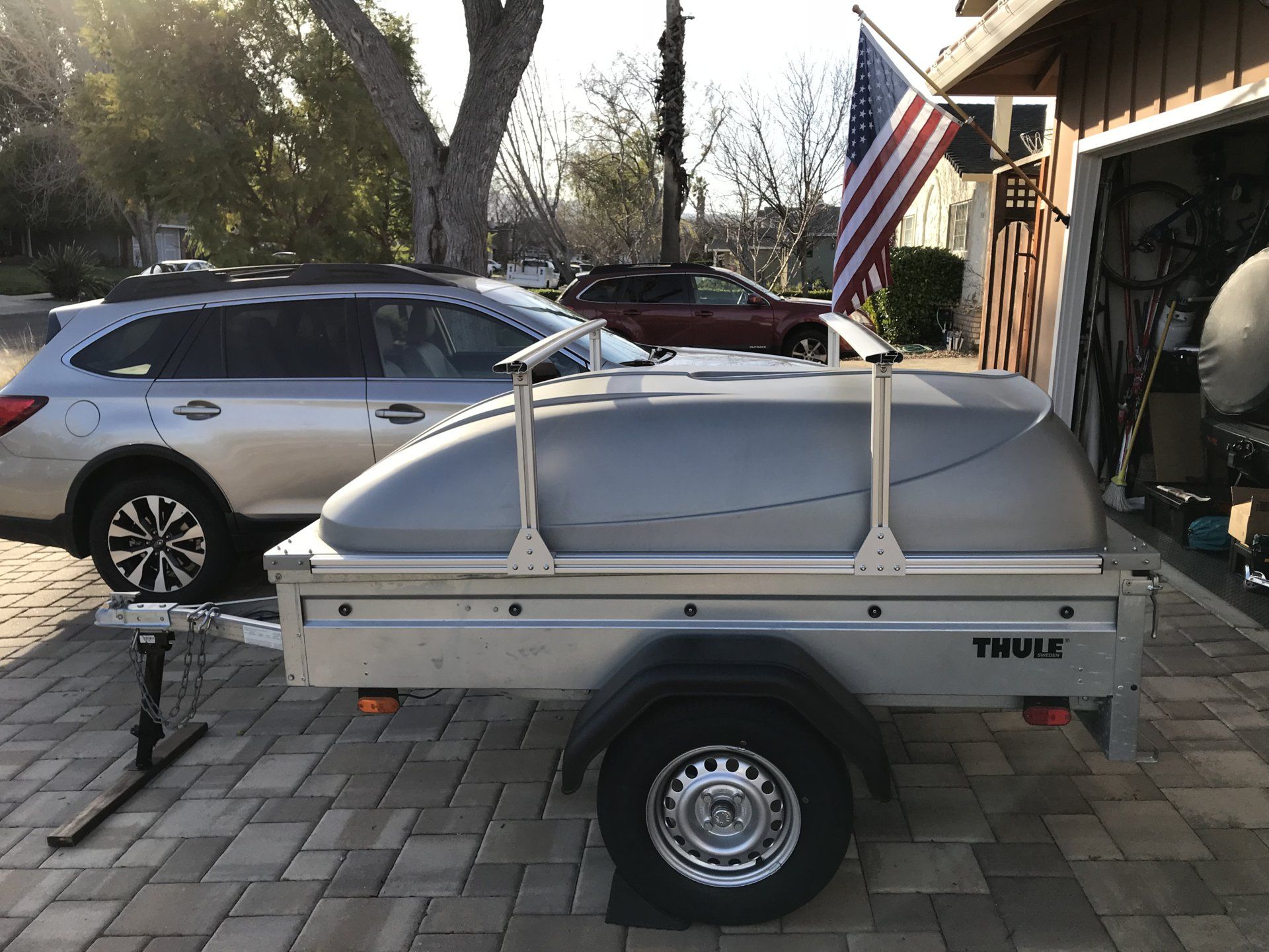

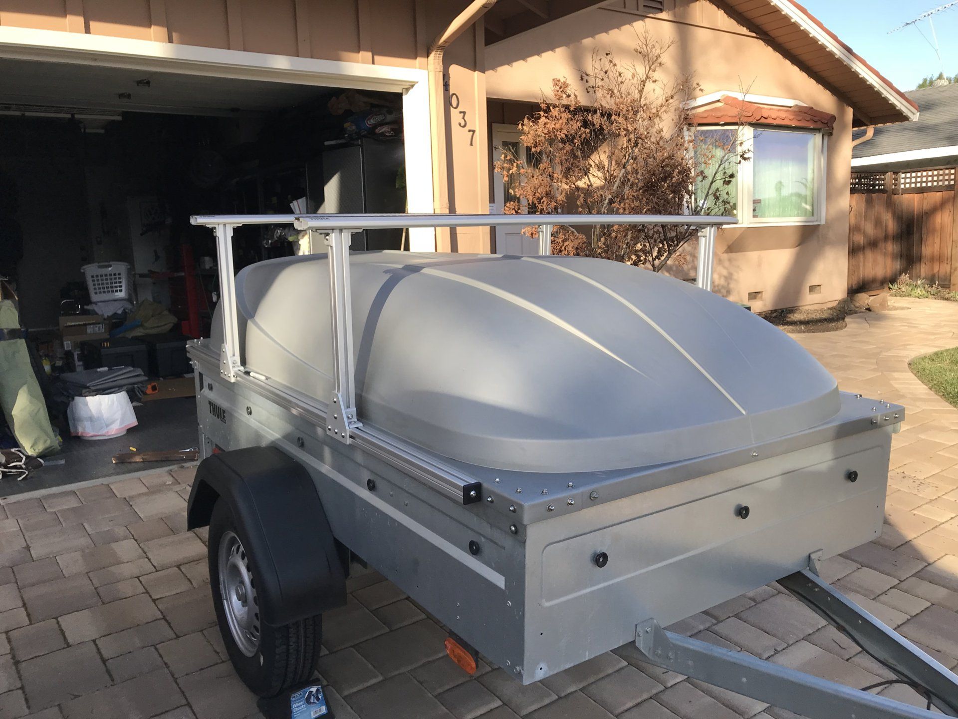

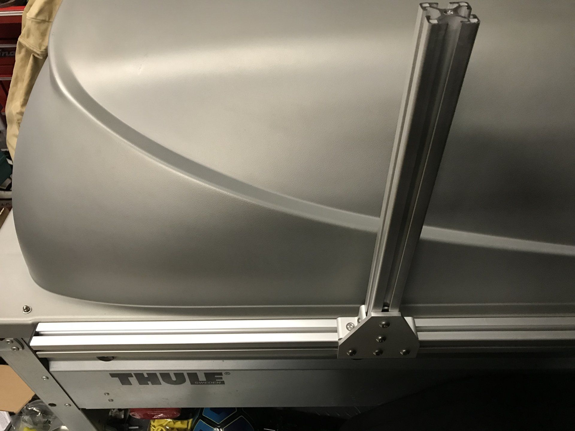

@Sir Velo Test fit of one side of the rack. Used existing lid to frame holes and upgraded from M5 to M6 bolts. M6 bolts didn’t require any addition drilling, though I’ll likely add 4 more bolts to each side. I have some Thule 60” aeroblade crossbars waiting for the other side to get bolted up. I’ll let the pictures speak for themselves:
@perkj I'm jealous... Of the garage! ;-)
Nice work, that looks very solid and clean :-) Have you noticed much flex to the side of the lid with the uprights mounted? I recall having some but once everything was buttoned up and tightened down the whole structure was rigid.
@Sir Velo Yes there is currently a very small bit of flex in the side of the lid frame if I pull one of the uprights towards me. I was figuring once I get the crossbars mounted across the lid that it would tighten it all up....glad to hear once you did that it became very rigid. I probably won't get around to completing the rack until this weekend.

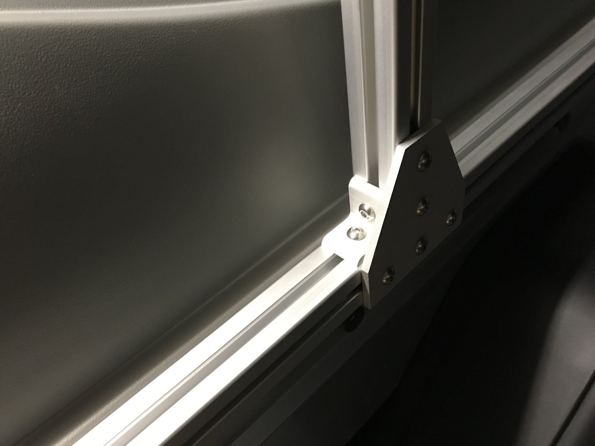

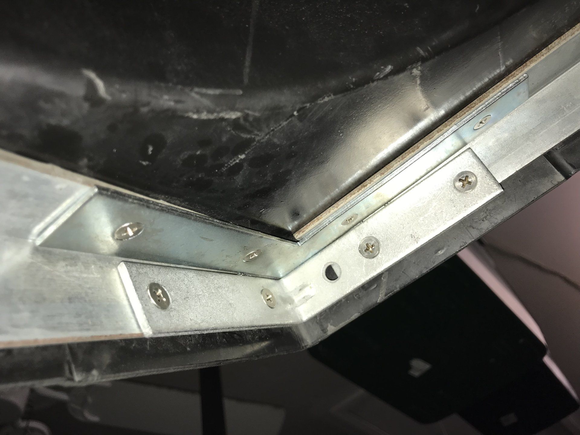

@Sir Velo I added those additional corner brackets yesterday. They really firmed up the frame even more so than when I added the upper brackets.
Here are the brackets I used: Everbilt 4 in. Galvanized Corner Brace (4-Pack)-15270 - The Home Depot
Used 10-24 SS 3/4” flat screws and spacers as you’ll see in the photos. Also note on the bracket that I had to drill a new hole on one of the legs due to the way frame is.
I’ve also opted to go with M8 Bumax Stainless Steel bolts for holding the 15-Series extrusion to the lid. The Bumax stainless are the SS equivalent to grade 5 bolts. Just waiting on the M8 roll in SS t-nuts to arrive later today.

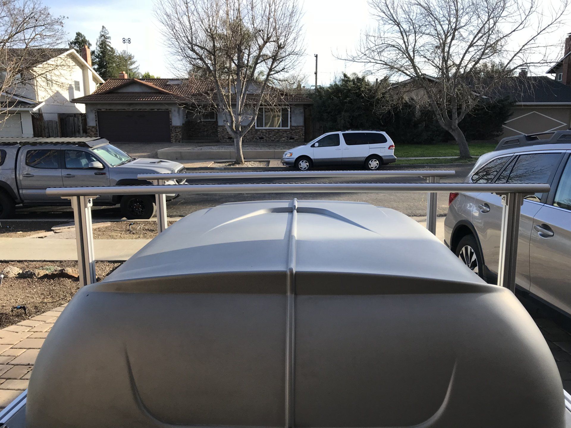

@Sir Velo here it is...it is ROCK solid. Absolutely no flex and I could probably pull the trailer by the rack. I’d see no issue with it even supporting a Roof Top Tent with people in it. I plan to replace the Thule cross bars with 1x3 10-series 60” bars since the rack rack on my tacoma is made with 10-Series crossbars...this way I can use the same attachment between them both.
@perkj that sir, is a hoss! Fantastic work man!
