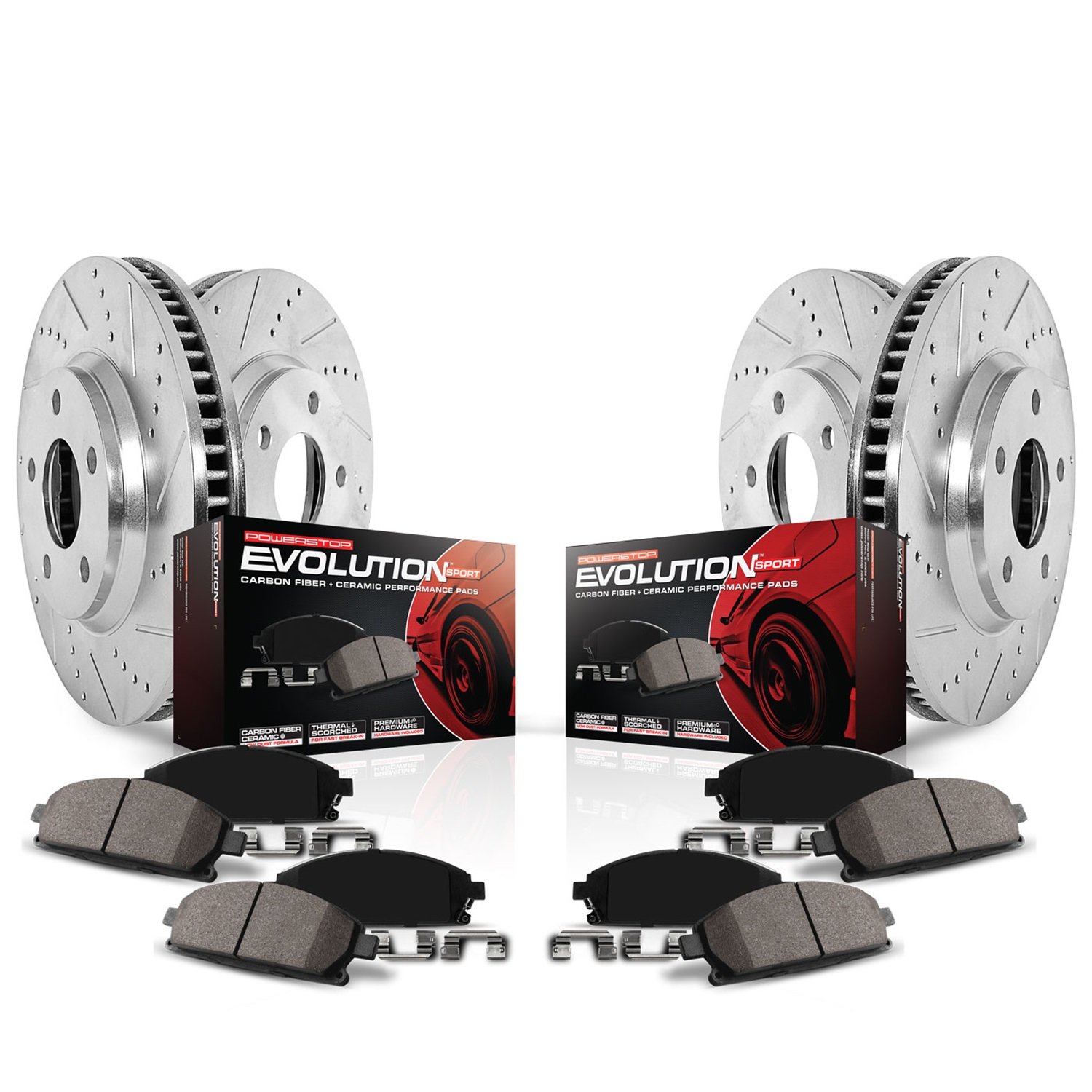

Just curious. Why didn't you go drilled and slotted?
Power Stop K1155 Front/Rear Ceramic Brake Pad and Cross Drilled/Slotted Combo Rotor One-Click Brake Kit
This is the kit I'm going with.
While I have used those both on my 80 and 4r without issue over the last 4yrs, there is a lot of hate for them here.
:worms:
What's the main consensus in the way of brakes and rotors? I have Hawk brake pads on my 93 4Runner, and the stopping power (even when wet) is IMO superior to EBC.
Generally speaking from past threads, the slotted and drilled are prone to cracking and getting debris in them. I don't baby my 80, but on the other hand don't wheel it as hard as some.
I've read that, but haven't experienced a cracked rotor on my T4R. On the other hand - I'm in West Virginia, and we don't have the high speed stops like out west.

Guess my short answer should have been, if done again would I? yes. (powerstop "kit")
I was going to purchase this kit however, @retrofive pretty much covered it. I have access to the powerstop kits at wholesale price but they were sold out at the warehouses I could purchase from. Also, they are the same rotors as the sector 27 (hawk) and they have had issues with porosity. Like stick a toothpick in the rotor type issues. Keep in mind I have never personally owned powerstop or sector 27 rotors so its all second hand information. Lastly, slotted rotors bite better. Reference the new c7 corvette rotors along with other performance cars going to slotted rotors.
I have the cross drilled, slotted, and cryo'd on my T4R. A lot of our off roading areas are -- WET! So the ability of my rotors to shed water/mud was one of the big reasons I went that route. Even after being fully submerged they still stop on a dime.

Nothing wrong with the slots, but a little rock can shred your pads on rare occasion in the drilled part if you drive a lot of gravel. Got some pea in one on a car, nothing yet on any of my 4x4s, but this is the first D&S set I've had to run on a truck.
