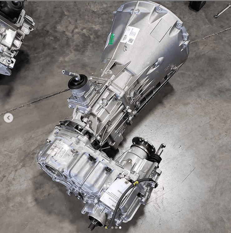

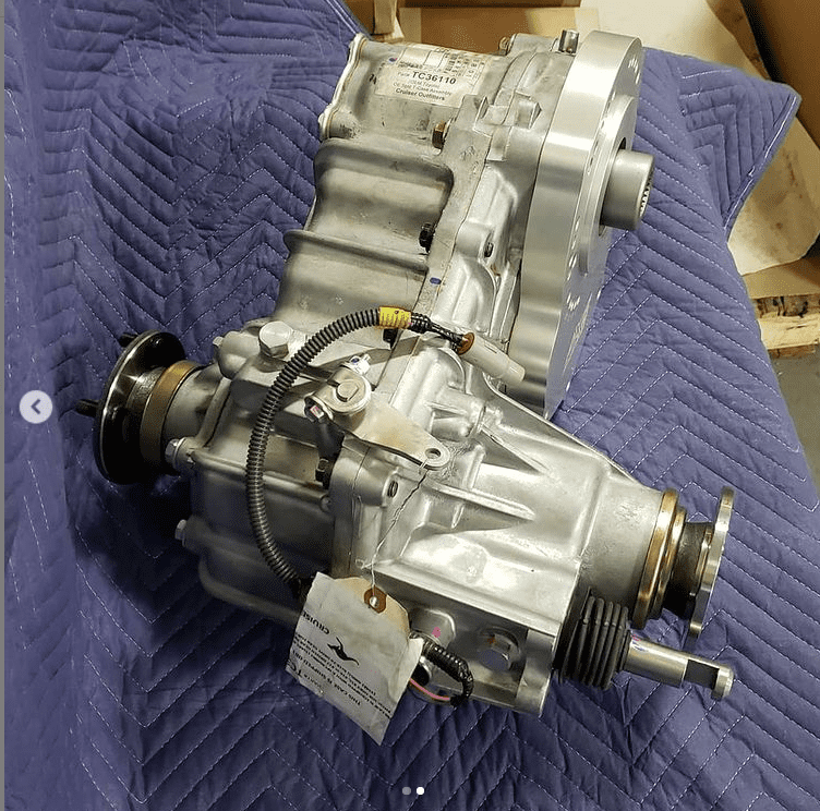

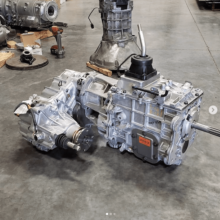

I haven't seen this advertised anywhere so I figured I'd pass it on - Axis Industries, who's been making all the Cummins R2.8 adapters, just put out this kit to use the 60-series splitcase behind 23-spline Jeep transmissions, like the NSG370, NV3550, even autos like the 8-speeds that come behind the newer Hemi's and mini-diesels. TR4050 too which looks like a very nice transmission. Additionally, I'd wager this should work behind a Dodge Gas-version (23 spline output) Nv4500 without having to mod the transmission, unlike the AA kit that replaces the tailhousing.
Anyways, just thought I'd pass it along, they seem to make nice products
Two other nice features of this are that you can remove the transfer case from the transmission without full disassembly, and it's clock-able which is a huge benefit!!
