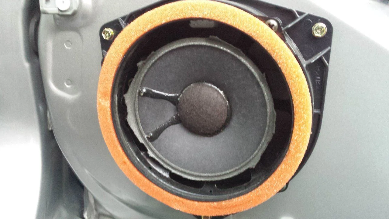

Other folks use refoam lots from simplyspeakers.
I just redid my door speakers this week with some cheap replacements, and there is a world of difference. There were a couple of right ups in these forms, but most of them seemed outdated with that photo links. YouTube videos were the biggest help.

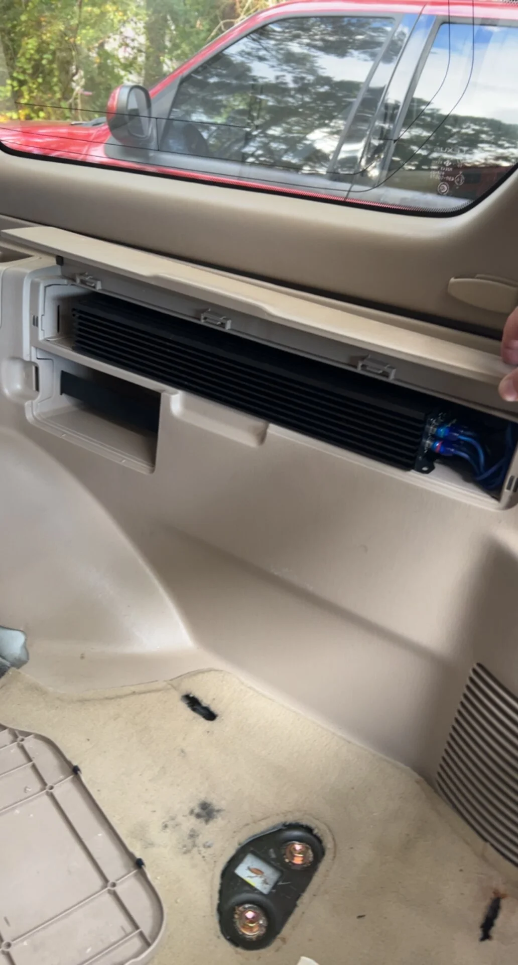

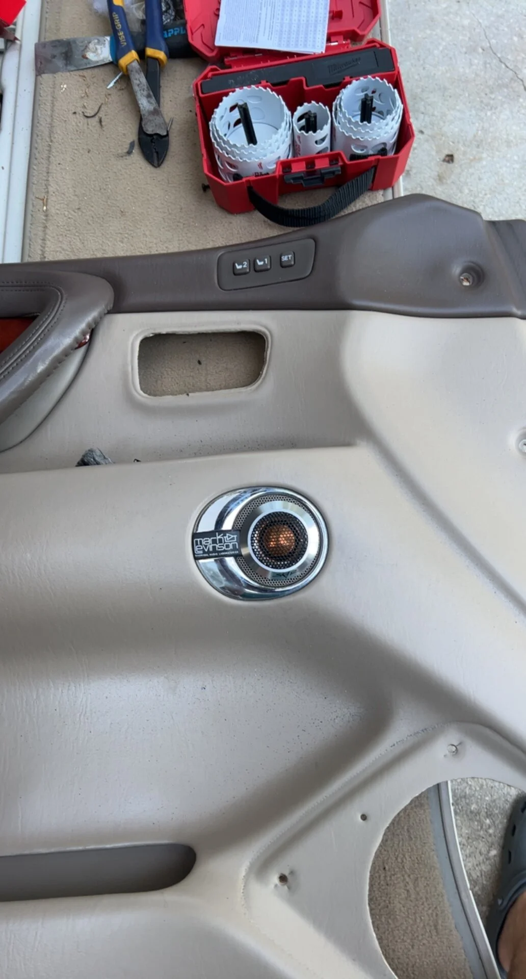

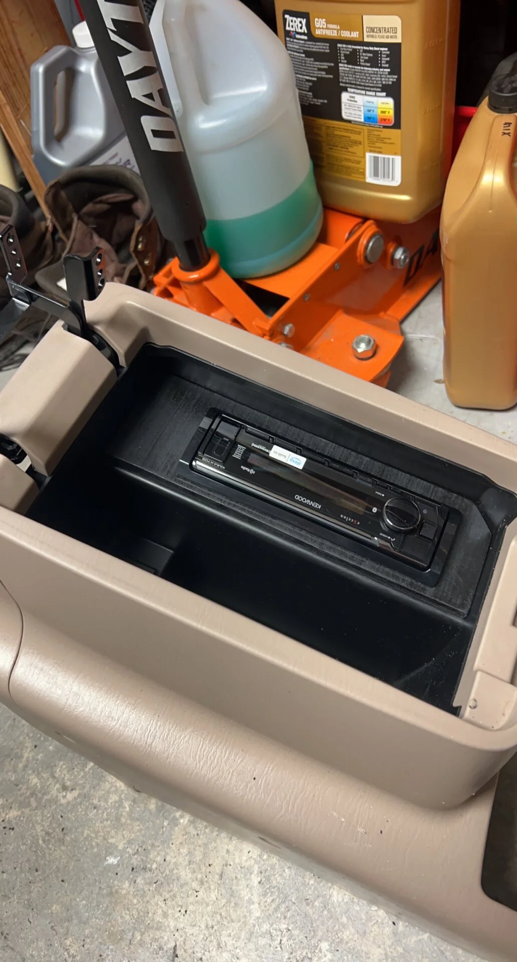

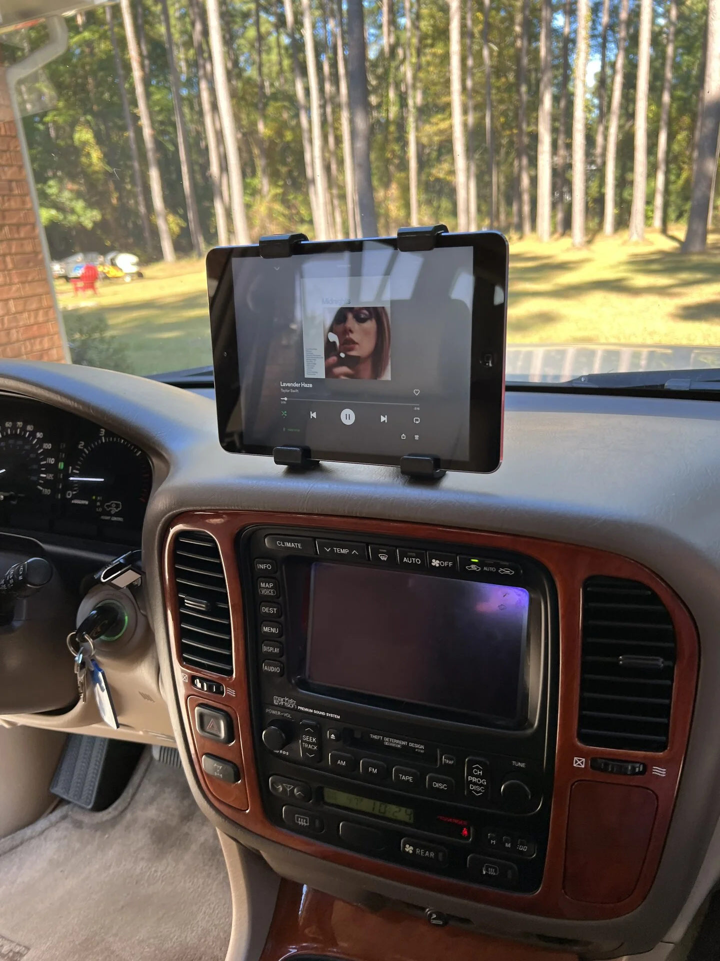

I went a different route than most it seems. I did Skar components with 5 channel amp. Hid the single din kenwood in the armrest where the cd changer went. Everything runs off my iPad. Sound is absolutely perfect.
Wow, that’s an intense setup! Seems a shame to hide the aluminum pole piece in the door mains. What part is that in the rear cargo area, an amp? I’ve never seen one that long and skinny before.
Yeah, it's the amp. I was surprised when I opened the box and saw it. I didn't pay no mind when I ordered it. It worked out perfectly though.
Skar RP-600.5

I re-foamed my two front speaker this past year. The kit is $25 and it's so quick and simple. Over the drone of my resonator delete, the whistle of the lights on my roof rack and the howl of my mud terrain tires, the stock speakers sound fantastic!
Refoamed all the speakers (SimplySpeakers.com) ... including stock sub,

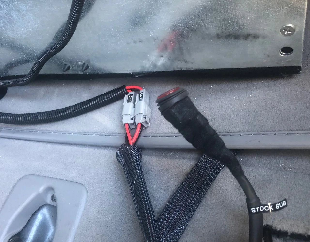

SAS Bazooka 8" 8ohm DVC tube driven off stock Subwoofer amp (2 channels) sounds really good.
You get the "secret bass" that most stock systems lack. Bumps pretty good, but not a window rattling amount.
Just enough to make long drives enjoyable again.
*Kept the Bazooka Tube on a switch to I can power the stock sub again in case I have to remove the Tube for whatever reason.
**Nestles perfectly between the sliding fridge and back seat.
