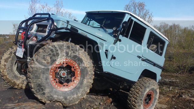

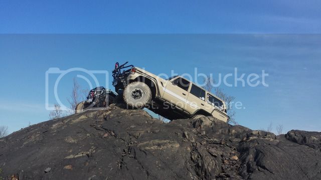

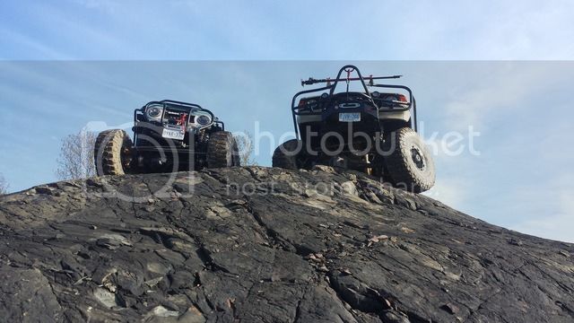

Peetie and I took both cruisers to the secret secret spot the other day and snapped some pictures. Pete had to be cool and make a video with sweet tunes...

Pete going down "vertically challenged lions back".

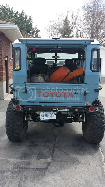

Anyways heres the carrier dealie. Tmr spindle, spring loaded pin, and pull clamp with a bunch of holy s*** thrown at it for good measure.
