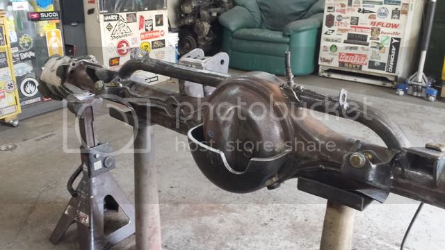

Its real tight coming off the truss and under the pearch man. Brake lines would be fighting for space with the u bolts... im thinking run the hard lines across the truss on either side to jist before the pearch then an extended ss soft line over the leaf pack and to the caliper.

Plan so far is to put the 3 way t in roughly the same ace as on the 60 axle then run hard lines on the truss to just before the leaf pearches. Ss soft line from there directly to the calipers. I dont have the room to run the hard lines behind the pearches and i think theyre more vulnerable there.

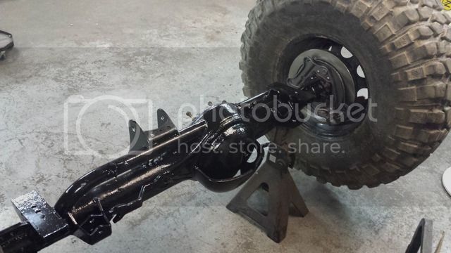

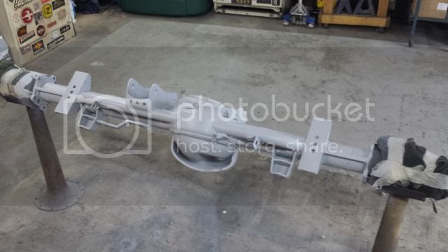

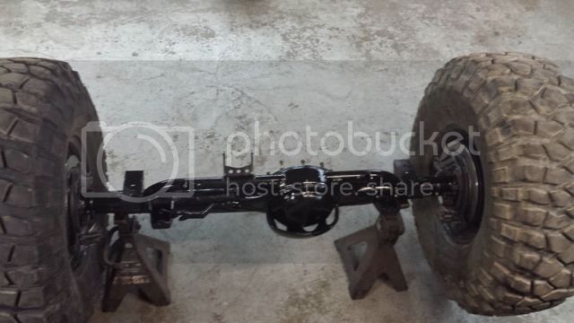

Went to camp for the weekend so i hit the axle hard to make up for slackin. s***s all finish welded, brake lines got made up, t is on the housing, and everything got a little paint. Took the time to ramp the drain plug with some 3/8" scraps i had left over from making the diff guard as was recommended...
To do the lines i cut off the brake tabs on the backing plates and threw them on the truss all strategic like. Made up the hard lines using the old rubber lines for reference so thats just waiting on the ss lines i ordered. Painted the calipers to match the front ones....

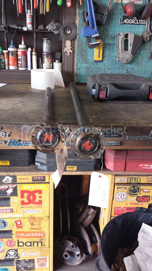

Nitro axles came in to boot.

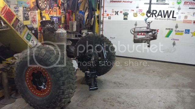

Derek and i jet out to petes today and ripped the 60 axle out from under the 40 and took it home. Dan and Army Steve popped by and we got the pita c clip axles out of the aussie locked 3rd and popped it out. A little cleaning and some sealant and its in the 80 housing now. Calipers went on and the long side nitro shaft got cut to length, chamfered, filed and both axles went in.
Went pretty smooth all in all besides the goddamed long side c clip. Damn thing was buried under the ring gear and inside the locker window. With some creative use of cotter pins as spacers and a mirror we finally got the mofo out.
