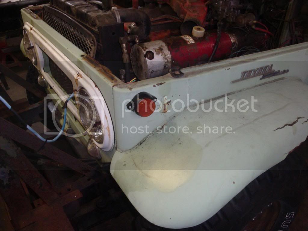

Those brake lights are trailer barn specials and are not oem although I kind of like where they are. You guys are saying the back up light is a stock item?

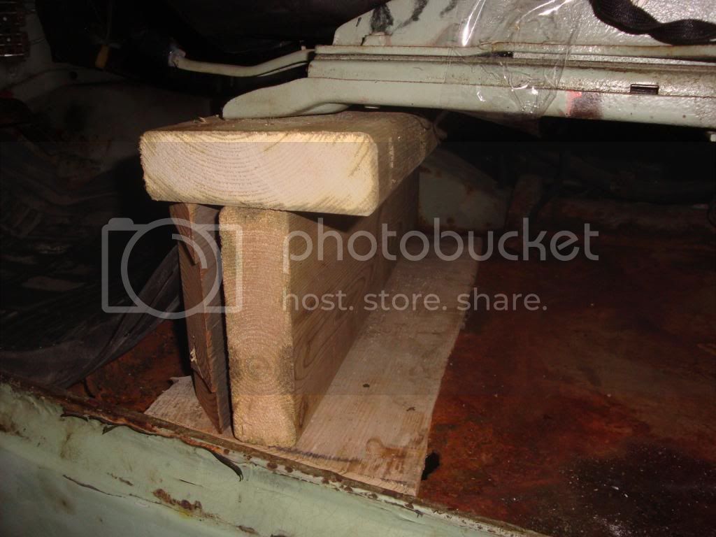

Anyhoo, I put up a couple wanted posts here and there looking for a tub and random parts so well see. May get around to moving the ds seat back a couple inches today so I can actually fit in it and drive it half assed. Might jigger the ds floor at the same time so the seat doesnt fall through it...

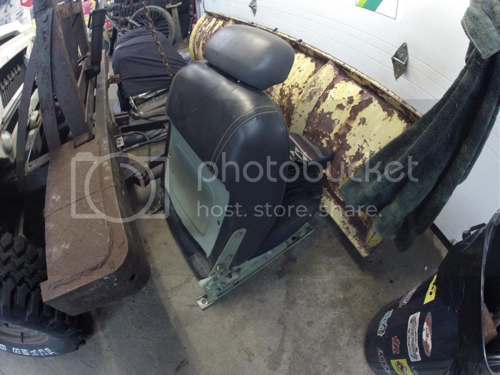

Took a quick look at the carb earlier and it had an aisin decal on it... Ill take some close ups later. The seats do look like theyre factory but from a later model maybe? Theyre that greeny gray vinyl and seem to be attached to the factory seat brackets. The vinyl is cracked to s*** though.

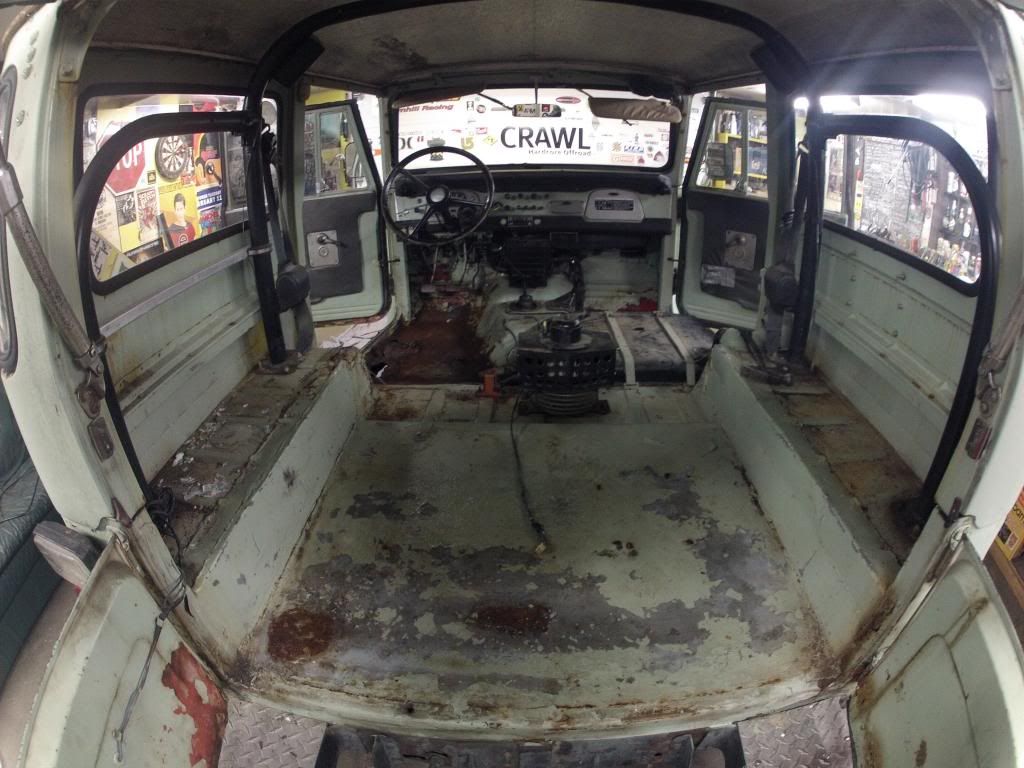

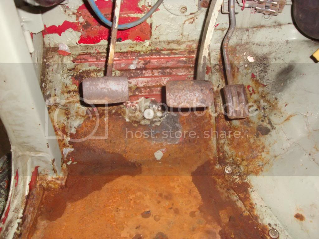

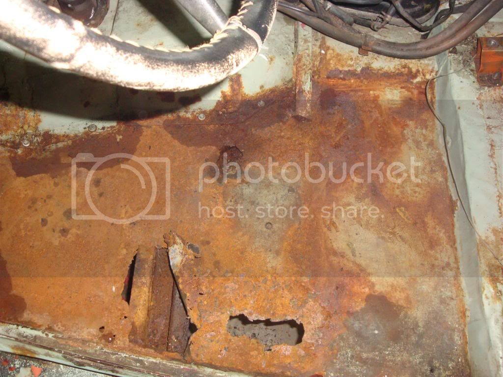

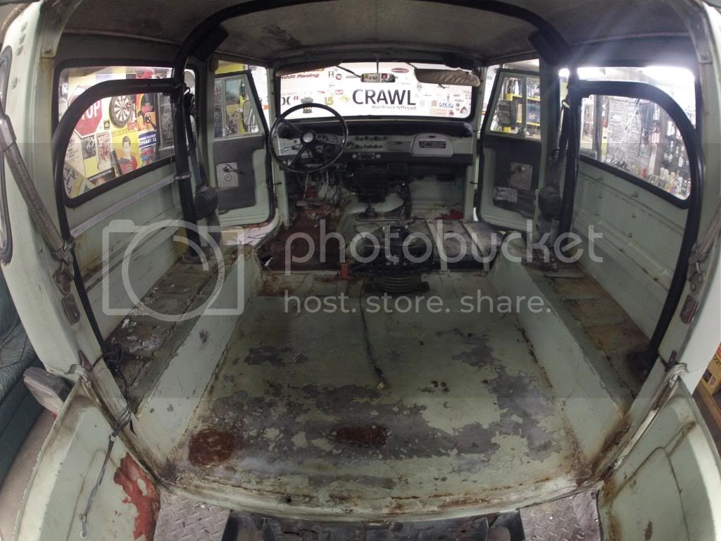

Ripped out the interior yesterday and got depressed. The floor is a mess, so is the cargo area, the rear wheel wells, tranny hump...... But isnt it funny how no matter how bad something looks, the more you look at it the easier you make yourself think its gonna be to fix?
Pitchers.

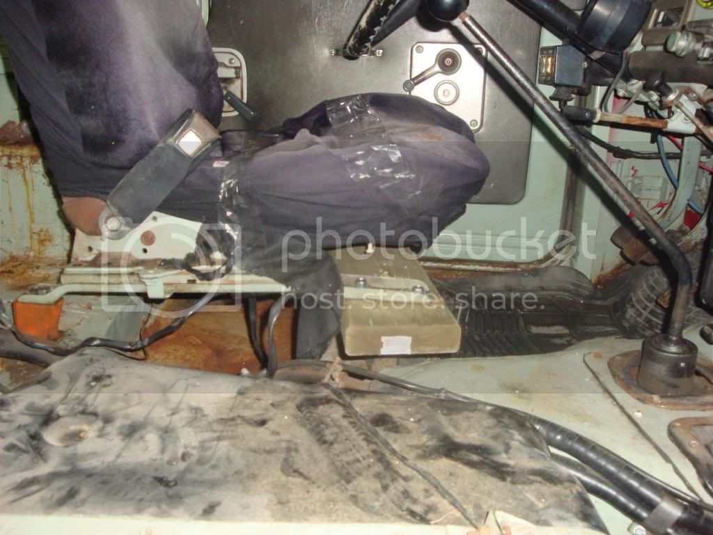

"Fixed" the shifter ball boot thing..

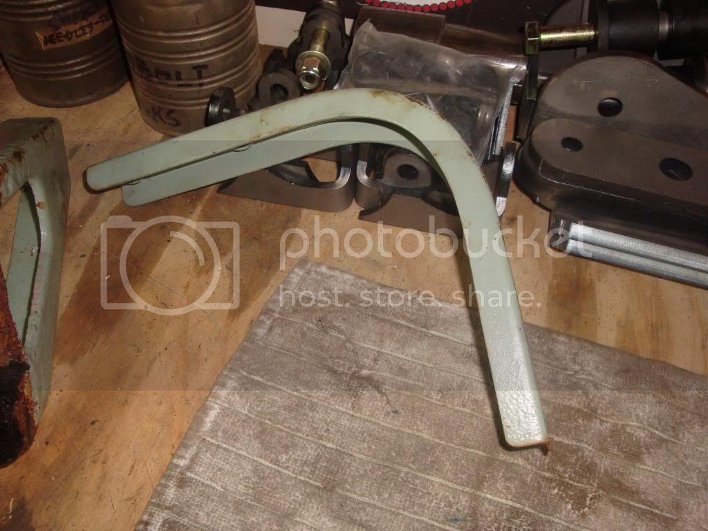

Seat pic.

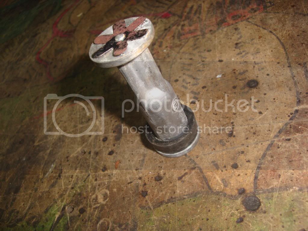

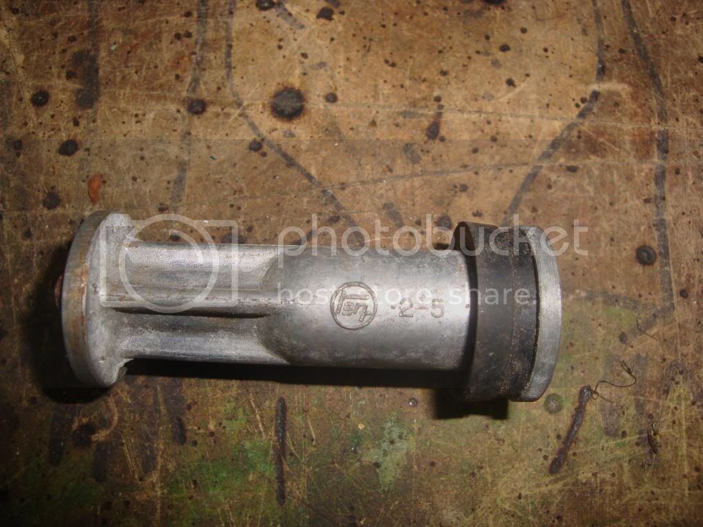

100 million dollars to whoever can name this part!

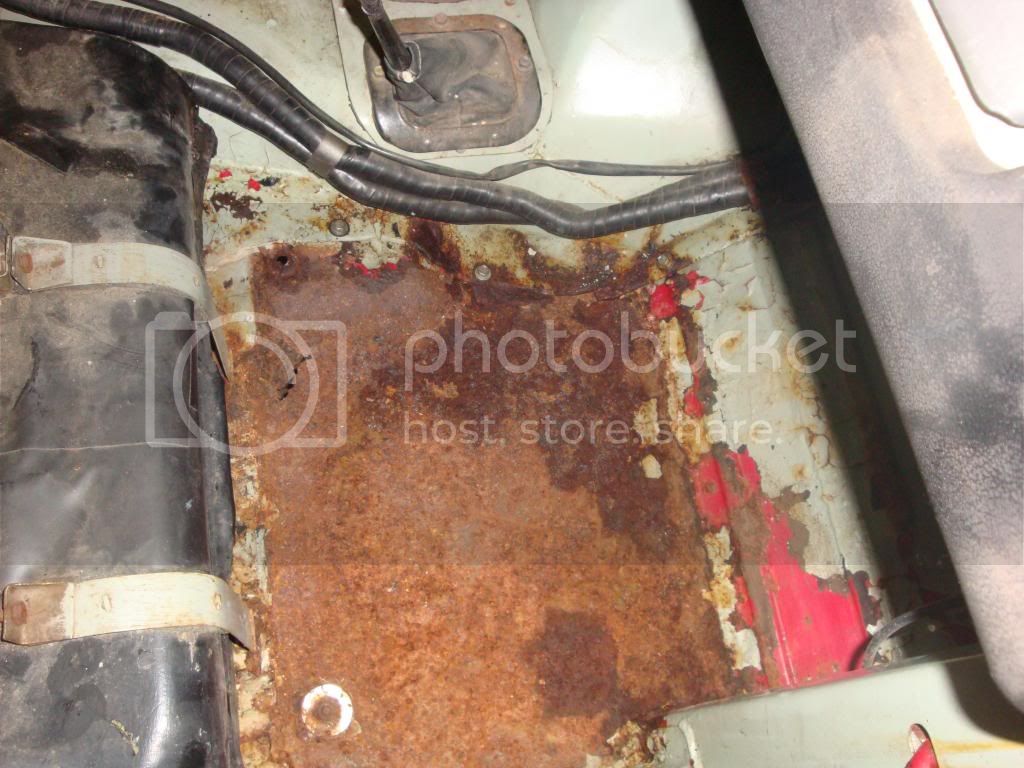

Plan for now is to rip out whats left of the drivers floor, run some reinforcement plate under it (connecting the two body x members and running under the left front drivers seat bracket), and then plate over that with some 1/8 I have stashed. The aforementioned seat bracket is a little rotten so I have to rebuild that too. Should hold me over for a bit and make it safe(er) to plow with.
D
As you can now easily see, those floors and the rear part of the tub have been replaced at least once already, but not very well prepped.
Pitchers.
D
Sorry to hear about the bad news, but hang in there and things will work out for you!:cheers::beer:
Don't worry, I had holes in the floorboard you could drop a basketball through. (literally) I went from this...
To this...
It just takes patience... Lots of it... :)

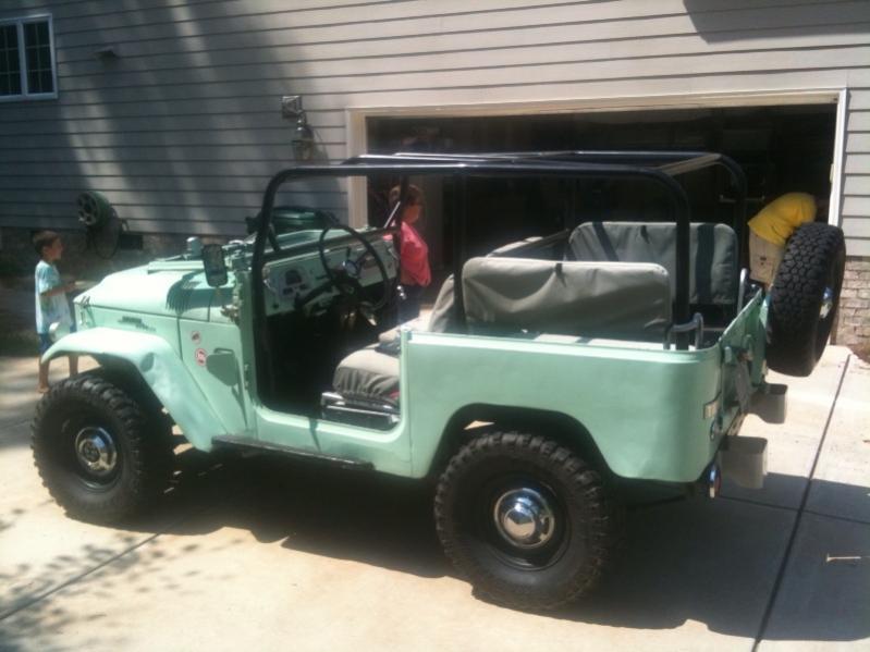

I think our 40s are bastard cousins. Mine's a 66 frame and tub, 70ish fenders, 71 F.5, Muncie and Dana drive line all with Freeborn Red over Spring Green. Frankencruiser might have to be its new name. :)
I'll be eagerly watching what you do with this. I loved your 80 build - it was one of the threads that started the LC fascination for me.
peace*mike
Thanks man, I miss that 80 a lot. Love the green cruiser, the tan one is awesome as well but I doubt mine will ever be at that level. Actually judging by some recent fab work I may end up with a covered wagon (see pics below)

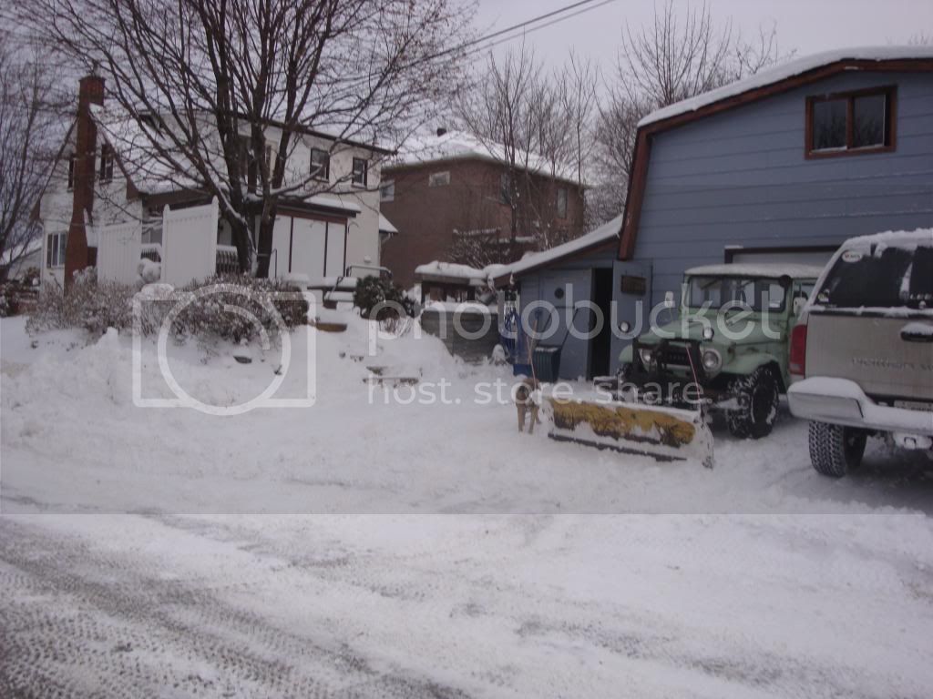

Jiggered the ds seat back in and did the snow. Ran and plowed mint!

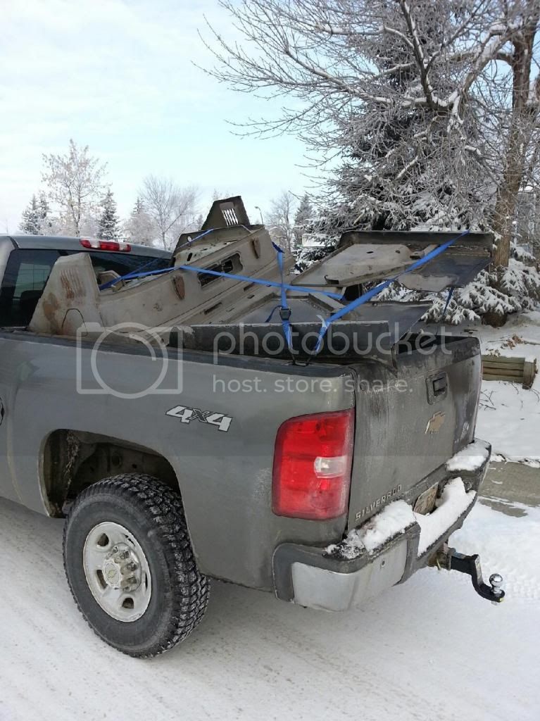

Well got some wicked news. Found a redone tub (still bare steel), firewall, 2 doors, windshield frame, and two partially redone fenders in Calgary. Even better I found someone to ship it for me for a reasonable price. So 1500$ later I should be on my way. Crossing my fingers that everything works out, should have it by sunday or monday...
D
Got the seller to throw in a rear hatch and mini barn doors for another 75 bucks which was cool.
Everything got loaded up this morning and should be making its way to Sudbury.
