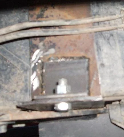

I was going to wait till I had the whole thing done to share, but I'm excited and can't wait. So here's the out riggers. Had to get a little creative with the drop brackets, but I think it worked out well. I also like the angle iron to locate.

Well done. I like the drop bracket idea. I don't know the kind of wheeling you do but those bolts might snap if you hit pointy rock(s) with enough force. Maybe it's just the pictures but they (bolts) look pretty thin to me.

The bolts are 3/8" Grade 8. I know grade 8 is usually goldish it seems, but Atwoods has gold grade 5 and blue grade 5. For comparison, Slee uses 7/16" u-bolts, metaltech and hanna both use 1/2" ubolts - all 1 per outrigger mount. I think 2 3/8" Grade 8's should be at least as strong. And I kinda forgot until I just looked at the picture, the rear most our rigger I need to put the angle on and redrill the holes, they are way too far down.

I like the angle iron to locate it! Wish mine had that when I was installing them. Would have made things alot easier.
Stronger too. There is one on the top too. So, for the outrigger to bend vertically, it has to bend the outer plate, both angles, the bolts and the rear plate, which I would have put angle on too, but then it won't slideunder the lines along the frame.
The rear one doesn't have the angle yet, but it will.
Assembly is definately easier - before the outriggers were all tied to the slider it self, I could just throw them up and they'd stay. I'm not sure if they will with the weight of the slider out there, but I still should be able to put them on as a one man job.
