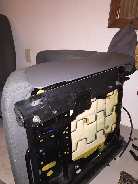

Here are mine, cloth manual from an 07. Will use the carpet shampoo'r with the furniture attachment to clean them. Just waiting on my welder to get here to figure out the mounting setup.
So working on my 07 seats and the bolt pattern is approximately 13 3/4" center to center, if I remember correctly for the front on the stock Land Cruiser seats, they are 15 1/4" (already cut my brackets off) so that is a different of 1 1/2" on mine. Of course I will remeasure the drivers seats when I get them but I am making small adapter plates out of 1/8" flat bar stock (1 1/2" wide by 1/8" thick) that I had laying around. I have the first one on and basically just used it as a mounting point adapter so the seats would not lean to one side.

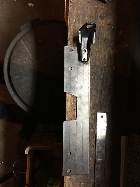

So last night was a bit of a learning experience for me. Lots of planning and looking at things. Got the inside plate adapter done with 3" wide 1/8" steel which worked out perfectly.
Untitled by Greg Fisicaro, on Flickr
Piece is 14 1/2" long with first hole from front being cut at 1/2" in from edge. Believe bolt holes are all 5/8" which allows me a little wiggle room. Bolts front and back are spaced 2" from center to center.
First bolt to last bolt is spaced at 13 5/8" center to center (as best I could measure).
Center of PT Cruiser bolt line to Land Cruiser bolt line is exactly 1 1/2" (hence the 3" wide plate) and worked out perfectly on a test fit last night.

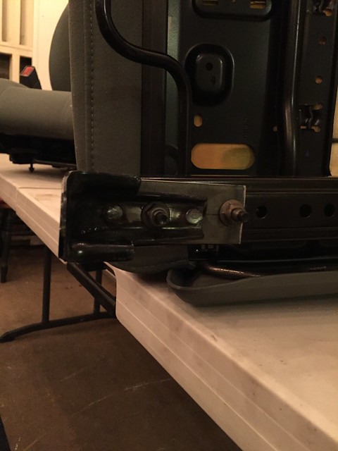

As you can see that cutout in the bracket is necessary as the way that my adjuster for the rails mounts to each side, there is a bracket that is welded to the inside rail that would not allow it to mount flush. No worries, just cut to match and it was all good. That was purely eyeballing it on the table.

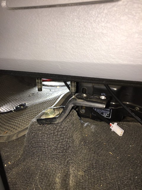

Where I ran into an issue is how I mounted the front most leg of the stock bracket.
You can see here that I mounted it by only using the front most PT bolt hole. This shifted everything forward causing me to not be able to use the rear mounting bracket with any of the PT bolts.

Going to have to adjust that for the drivers side once I get to that one. But for passenger I am not worried. I just have to build a bracket that will attach to the stock foot allowing me to mount. I never measured mounting distance which was one of my mistakes.

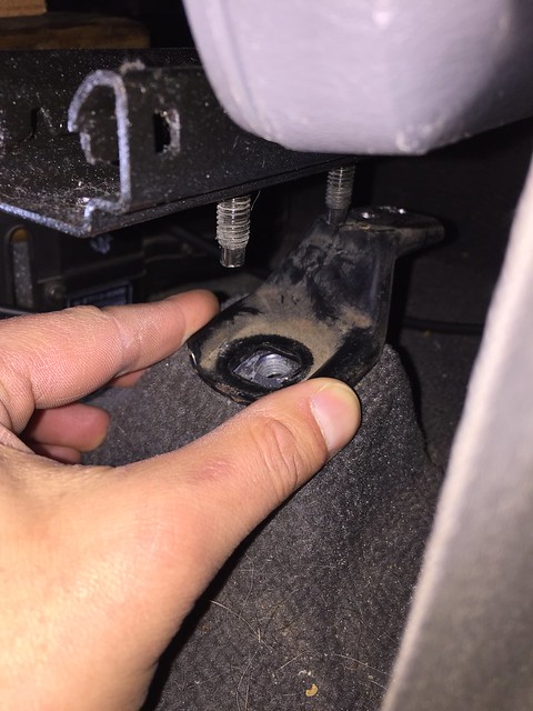

NOTE: If you are doing this mod, be sure that for the front stock LC feet that you use the stock PT bolts as much as possible. This will allow you to get at least one bolt into the rear LC feet.
Front foot.. see how I only used one bolt... drill the foot bracket as necessary to use both PT bolts.

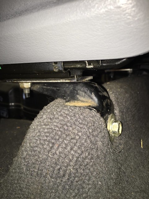

Otherwise you have to deal with this..
