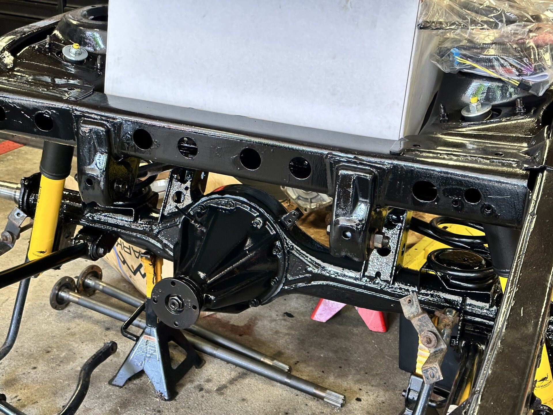

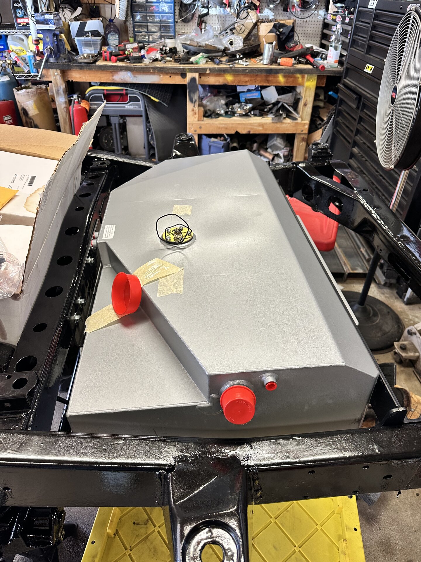

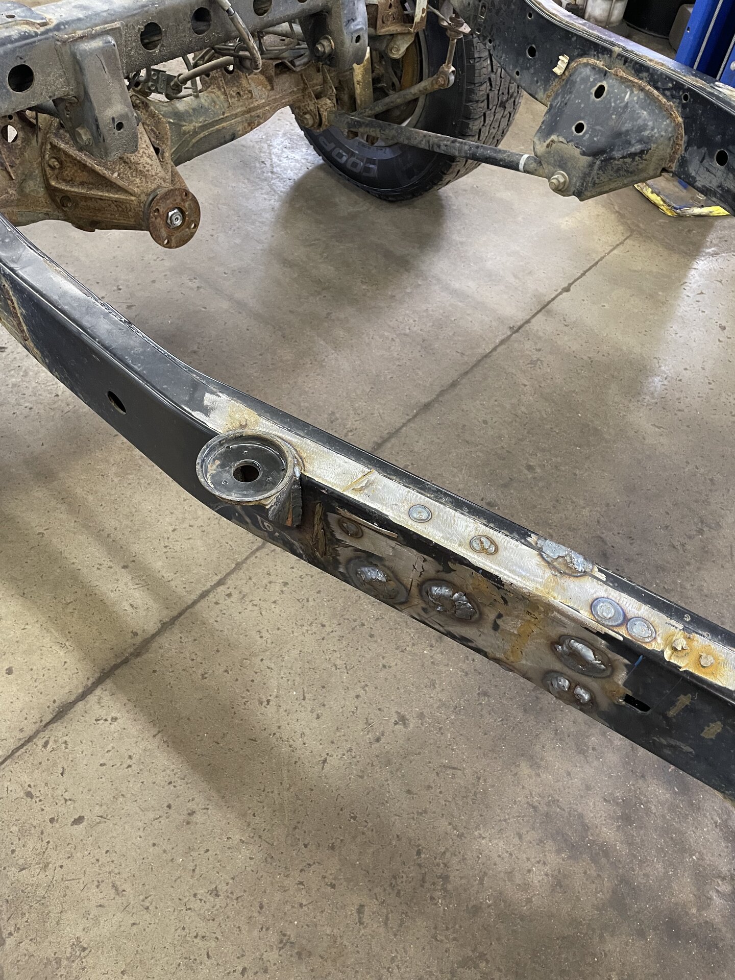

Been a way a while but the work continues. I got a doner 96 80 and bought the connect and cruise LS3+6L80 (on sale at the time) from Karl’s Customs.
Here’s some photos of the build. Minimal rust and in pretty good condition.
