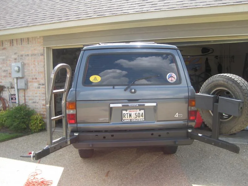

Using a 3/16 sheet I had it bent 5 times. I have used Iron Pig spindles and De-Sta-Co 7500lb latches. I am building one arm for a tire and the other for a ladder. You would be able to pick either side for attachments as the footings are universal. Off the ladder you will be able to carry fuel and water cans. Or a cooler, or a big ole basket. A bike rack and awing is the works as is a hammock seat that can be used with the arms open. Lots of stuff for camping etc.
In the pics the swing arms are just 3 inch channel to give you an idea what I am doing- I am using 3/16 2x3X 22 tube. Latches will be mounted to plates that are welded to the arms and the latch will be recessed and mount horizontal to keep them out of the way. 2x3x11 channel will be used for the footings and mounted with 1/2 inch grade 8 bolts. When I am done camping I just remove the attachments and replace the bolts into arms, put the tire carrier etc in the garage. The rest of the time I can leave arms on and use the tail gate normally

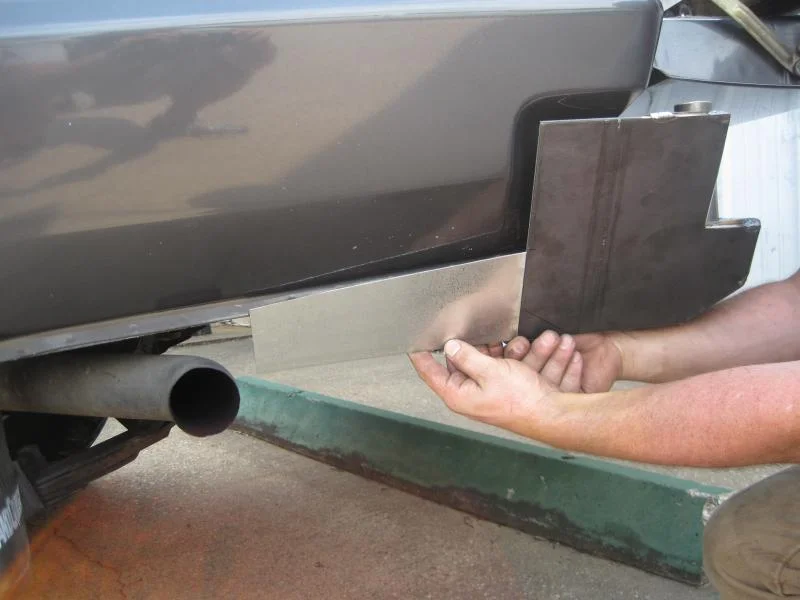

I am redoing the wings to make them a little more attactive and extending panel protection about 3/4 of the way to the mud flap.

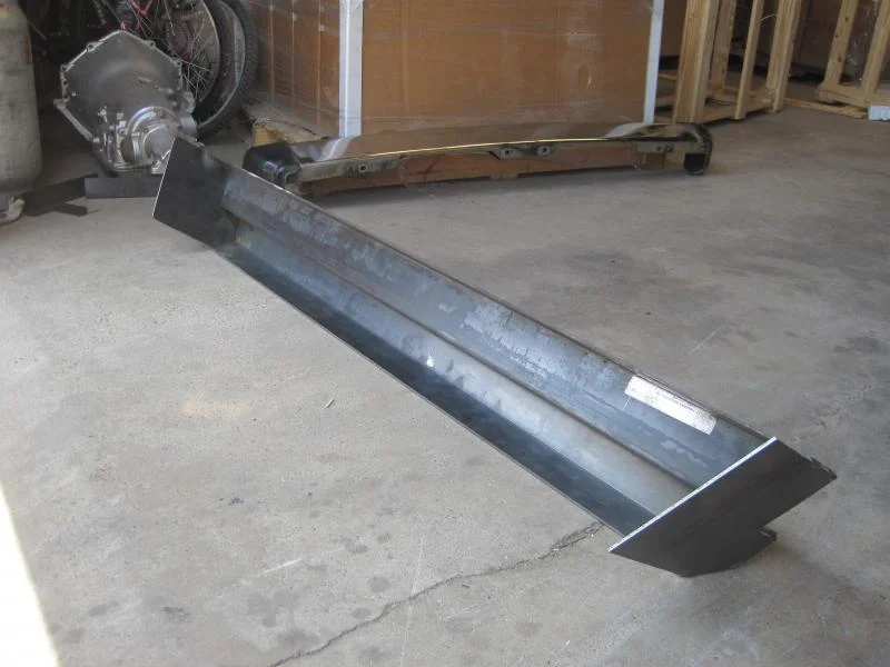

That is not the real swing arms- that is the real spindle after with cut .5 inchs out of the body and tack welded it for fitment- I will have the arms up later next week- They will look like every other arm out there but a little thicker and placed within the bumper instead of on top- Like ARB does for the 100 and 80 series-I got the idea for the attachments to swing arm from 4x4 labs- Their bumper was a huge inspiration as far as being to switch attachments out-

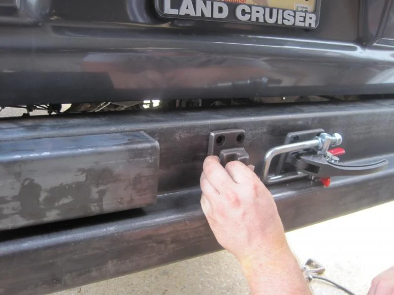

take a 2x4- this is you swing arm- now a make an upside down u over the swing arm- nice and snug over it and then run a bolt all the way through it. The nut actually will be recessed into the main bumper and if you lock the latch then no one can steal your tire and ladder cause if they try to undo the bolt it will just free spin after a few tuns.

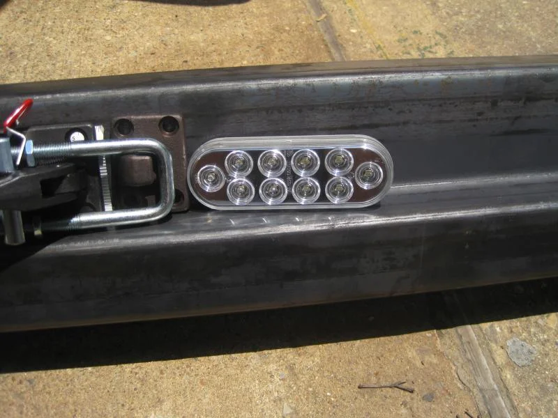

LED light that will come on when the arms open up and a on off switch located somewhere easy to turn it off if you want it off- like a on- off -auto dome light switch- light will be behind and cut out of the main body shell- Super Bright LED unit weather proof.- Might do LED brake lights as well if it looks right cut into main bumper face
side wings- being re cut to include more qp protecting and clean up the lines a little bit- In the pic we are holding up 2 different pieces of of metal to give you an idea of the new lines of the wings- they will have a bend a "V" at the bottom for extra strength

Stops will be put in with a pin and handle that it holds it open at 110-120 degrees-

I am not a fan of the big red handle latches
where did you get your big handle latch?
is it a DE_STA_CO latch....2000#?
I'm looking for a bigger latch like that, but de-sta-co doesnt have a good photo showing the actual size.

I don't have latch part number cause they are in the back of the truck- at the dealer- getting ac fixed... But they are the 7500 lb ones de-sta-co makes with catch it is almost 90 bucks. Maybe more. Same size as the 4000lb one with the red handle one - I ordered it from the directly
Found the latch numbers- TC-385-R Pull action latch- toggle lock- $93.50 Latch has the safety lock
and clamp TC-385102- 16.9
The top is 5.5 inches out
the face is 5.5 inches down
the bottom 45 angle is 2 inches long
Top to bottom it is 7.5 inches- But it also sits a 1.5 higher than stock- Tail gate drops just fine.
