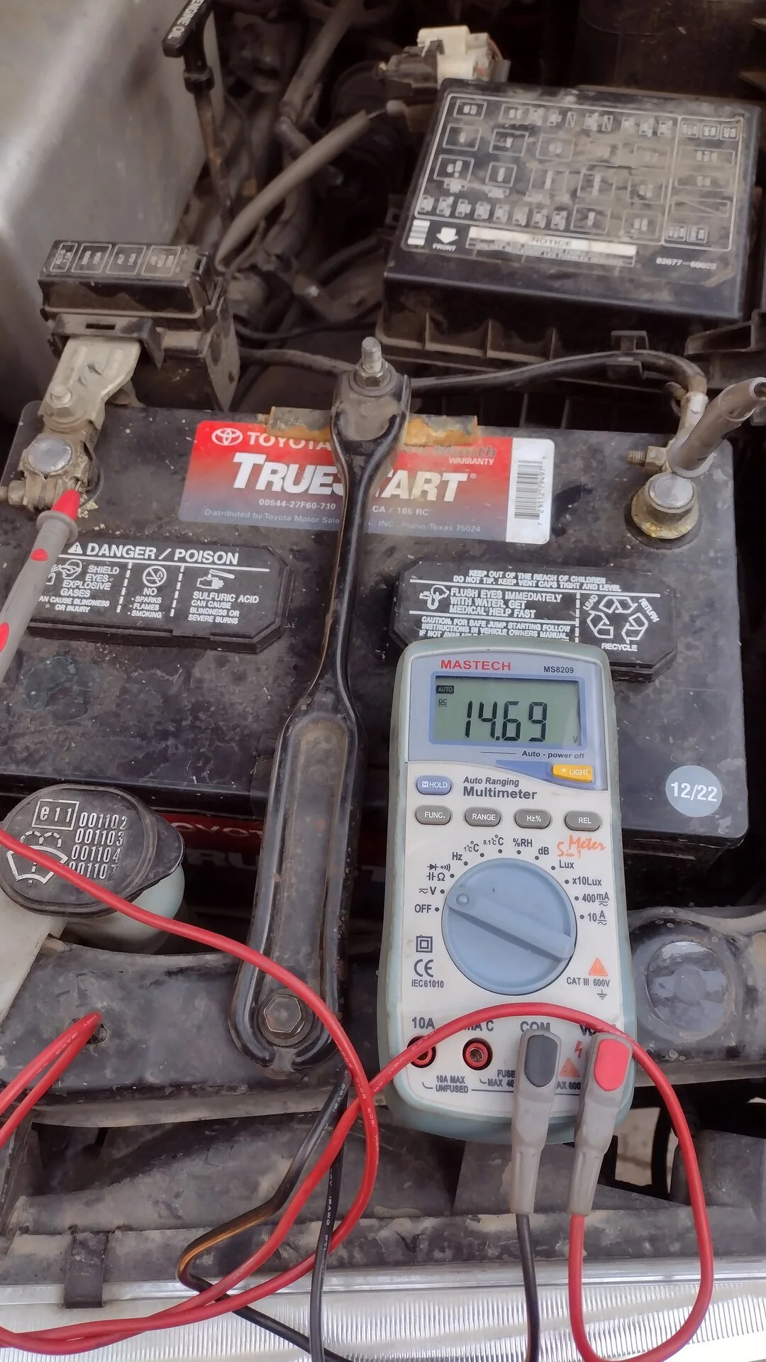

Check the voltage at the battery with a multimeter. It can go as high as 14.5 V. Is there any water intrusion? do you have the rubber gasket that goes over the base of the bulb and over the opening in the rear of the headlight housing?

Also, how old is the battery? Before iyr alternator gets cooked, see the quality of the battery and main ground wire. There should be at least 2 grounds, one to the body and one to the engine.
check you alternator voltage when running (with higher RPM). possible faulty regulator to give you high voltage. Also check if you running light resistor is shorted.

I'll throw the DMM on the battery tomorrow and see what we're looking at. No water intrusion in either of the headlight assemblies but no boot covering the bulbs either. They seem to twist in tight with their respective o-rings though.

Just to eliminate the alternator being the issue, I measured the battery voltage with the engine running and have a steady 14.7v.
