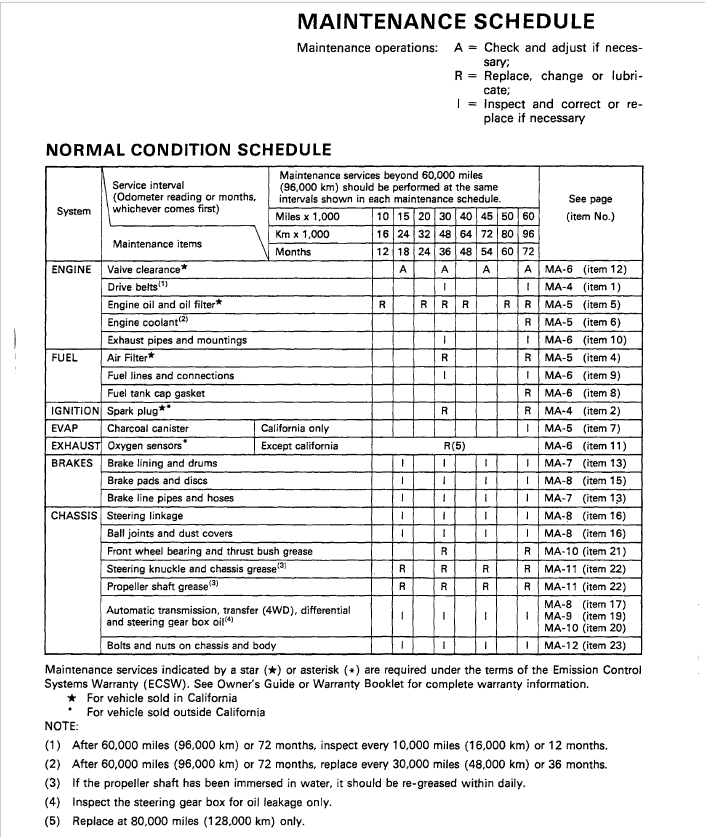

Unless you have a detailed maintenance history/log for the vehicle, assume that everything on this maintenance schedule below needs doing. I'd start picking away at these as soon as you can. Some ideally would have been done before a lengthy 80 mph highway run, but looks like you got lucky.
