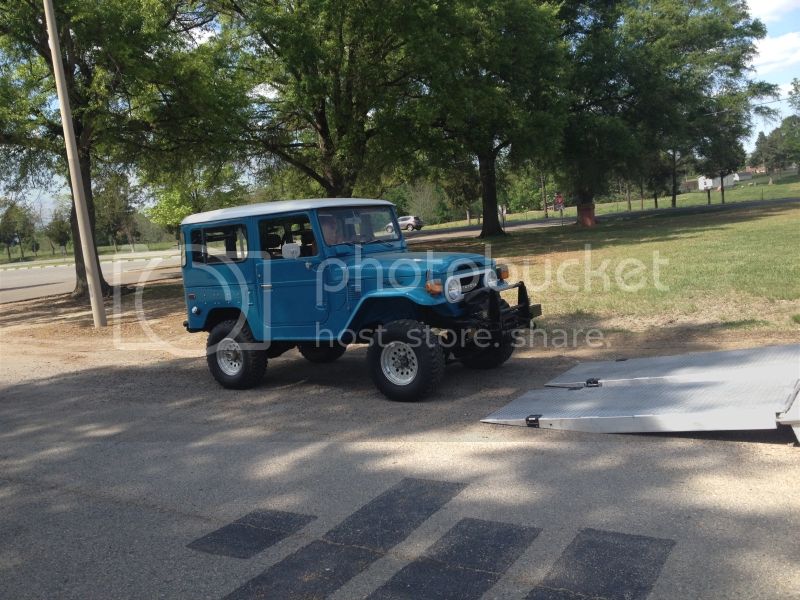

This was when I took delivery and how it set...
