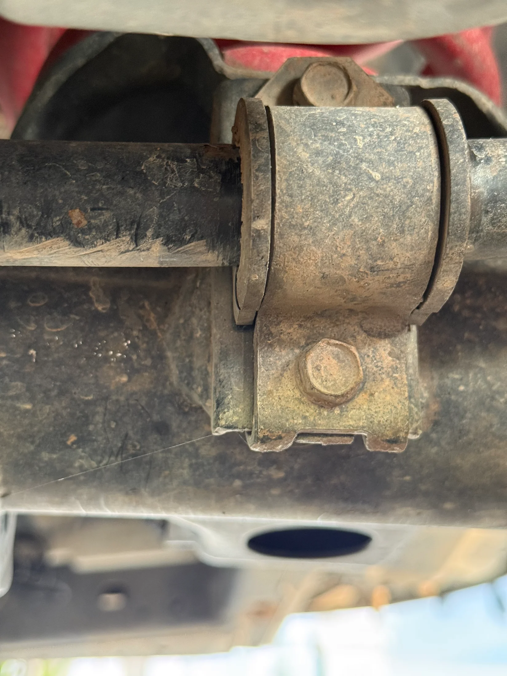

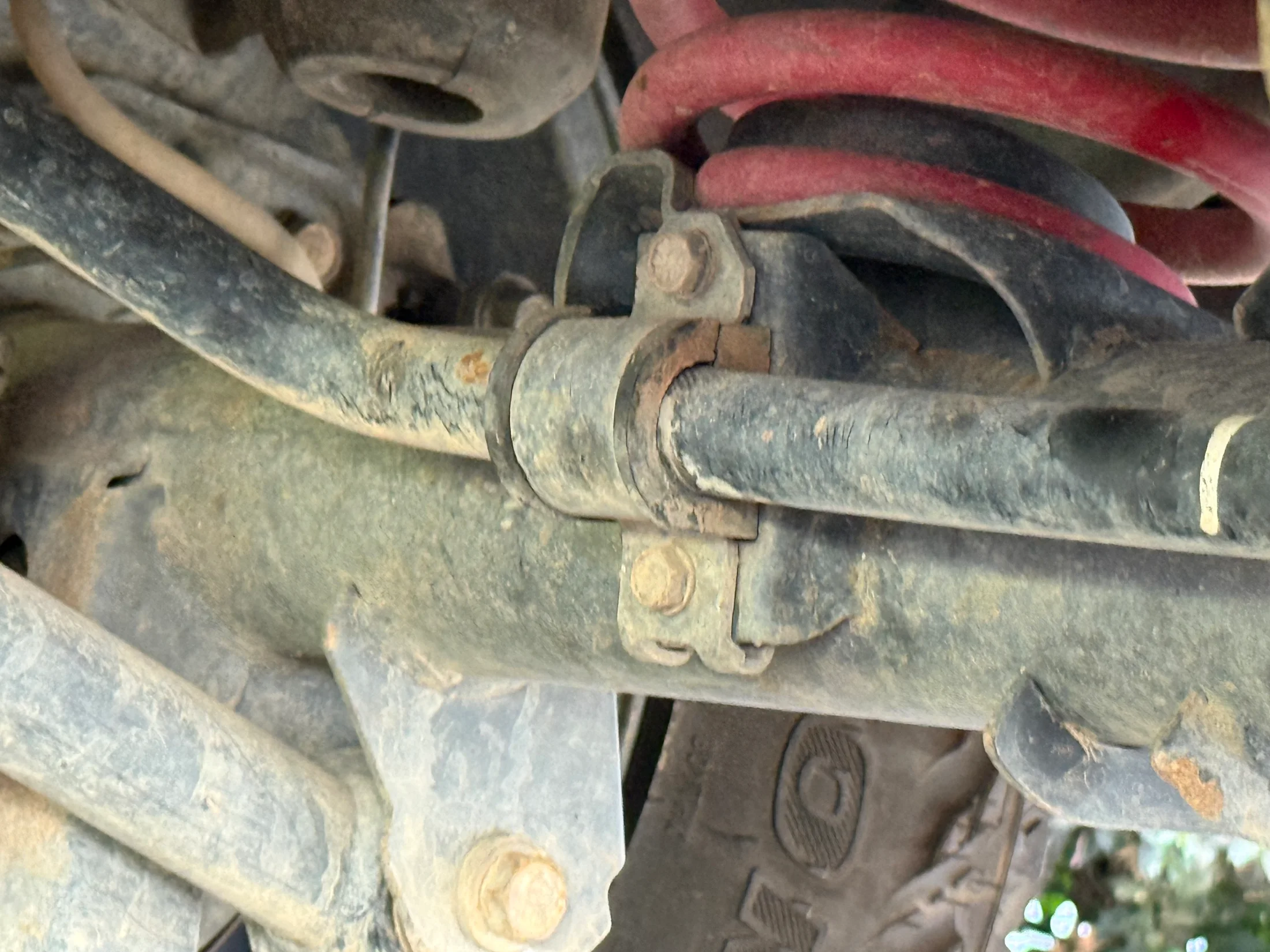

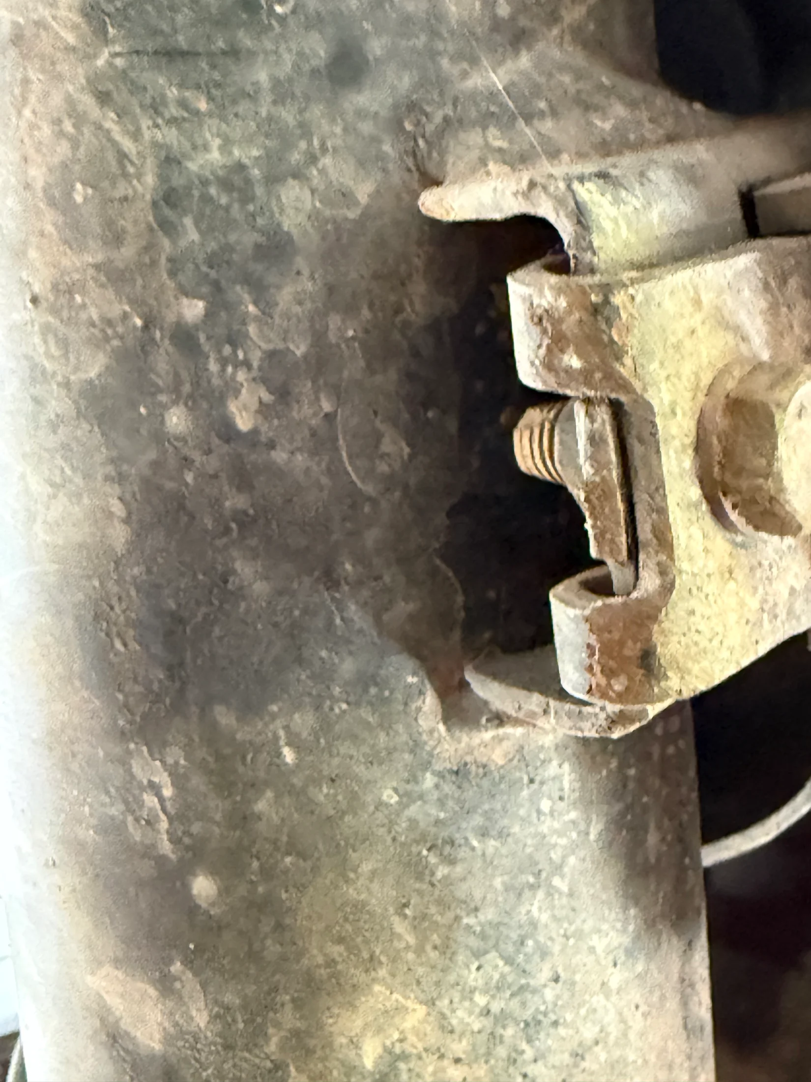

The only thing I can comment on is the rear sway bar.
In my case, the 8.2” rear diff from a 2016 kdss 4R needed weld on brackets to hold the HD Nolathane 24mm rear sway bar.
Rear sway bar is great at transferring forces/articulation to the front and balancing out the flex. It also helps reduce swaying that you get when you remove both sway bars.
I run the heavy duty rear sway bar and no front sway bar with long travel rear shocks (Icon 56550) and LT rear springs (Dobinson 701V)
Agree on keeping the sway bar. It should be possible to have the mounts cut off of your 8" and welded onto the 8.2", or to have some new brackets fabricated (they are pretty simple). If you are already welding on the 8.2", you might as well also install a emikeith panhard bar correction kit.
got a pic of how you did it?
