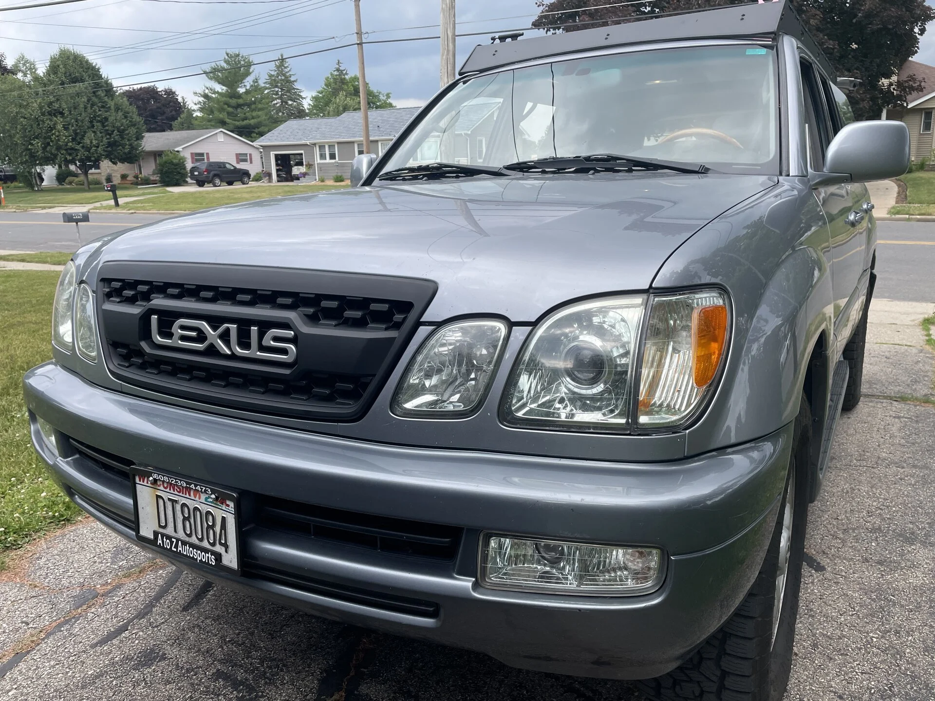

So Garage Alpha Off-road came through in the end. Received the third grill today. First thing I did was flip it over to look for the mounting points and they appeared to be in the correct locations! Got it mounted up and in my opinion it looks pretty awesome. Excellent cosmetic upgrade. I got the three amber raptor lights cause why not. I’ll have to figure out how to wire those in. Anyone know of a thread on here for wiring raptor lights on a LX470?
Looks great! Makes me want to get one for my '06....
Thanks! I'm happy with how it came together. Garage Alpha Offroad was able to deliver he correct grill on the third try. They mentioned they were having some issues with their warehouse. All good in the end.
I only got real nervous after they sent the second grill. I had just assumed it was the correct one which was my bad, so as soon as it showed up I removed my oem grill. Of course after 18 years the bolts were rusted together so I sprayed them down with some JB80 and let them sit for a bit before I removed them. Well I ended up breaking two of the brittle plastic clips off the 18 year old oem grill. The rectangle head bolts fit snugly in the plastic clips of the gill and when I removed the nuts the plastic wasn't strong enough to hold the head of the bolts agains the rotational forces I was applying to the nut. I initially thought to myself "bummer" but wasn't too worried until I realized I had the wrong replacement grill! Talk about panic! I thought I'd be driving around without a grill until I was able to get the proper one and at this point I wasn't sure that was gonna happen! Well like I said, they came through and I was even able to use the same hardware from my oem grill. So, word to the wise if anyone is planning to make the switch to this TRD style grill, be sure you have a hold of the bolts snugly in a pliers prior to attempting to remove the nut!
