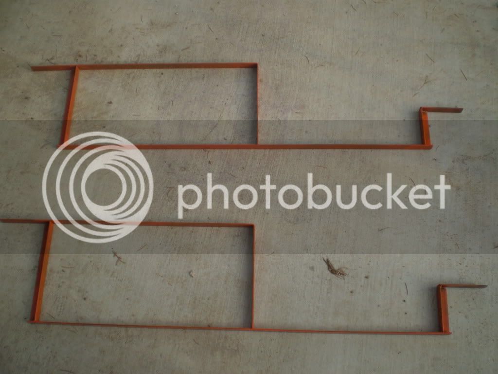

Here is a picture of the subframe
I am trying to develop a new drawer system for rigs that have fridges.
Looks like you are moving to a one piece base. Rather than two halves. That should be more space efficient.

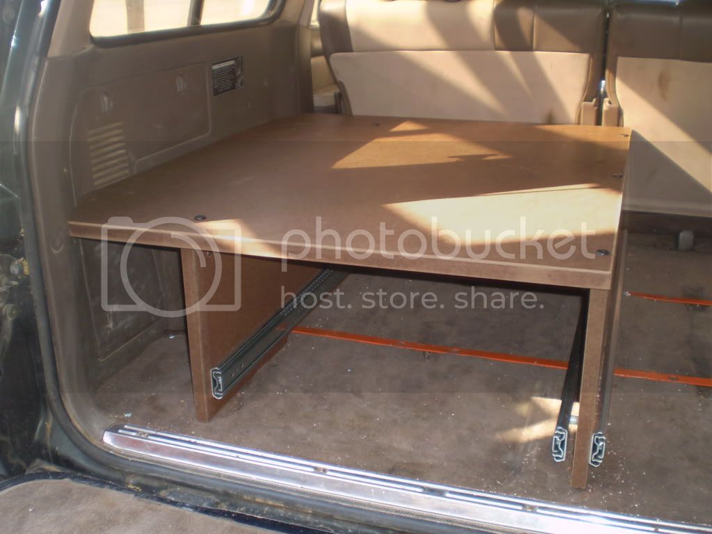

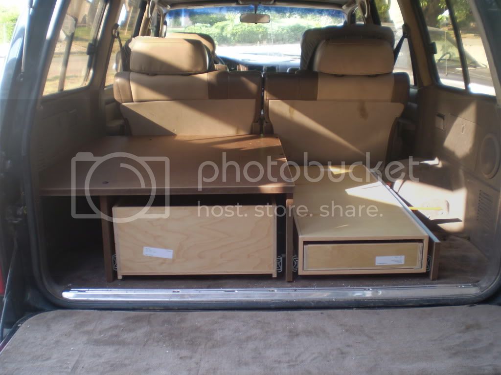

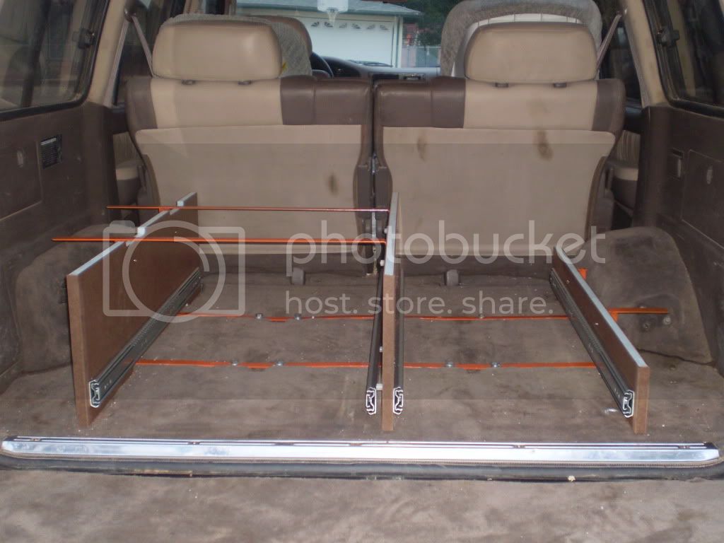

Ok here is my progress. I have mounted the subframe and started constructing the sides.

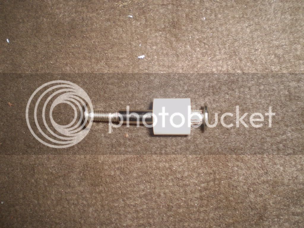

Here is the hardwere I chose to use. It is a sex bolt with different size poly bushing depending on the application. this allows me to use only two type of hardware the bolts I will use to attach the tops is different.
I am not sure I understand, But if you are saying what I think your saying then in the fridge is boxed in how do you get to the fridge without opening the rear hatch?

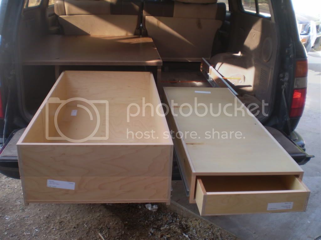

Sorry...The purpose of the slide is so you can pull it out to make it easier to get to things. The end of the box is open for the frig to slide out. One of the key point of keeping the frig running efficiently is ventilation and by boxing it you keep the space/clearance needed no matter how you are loaded.

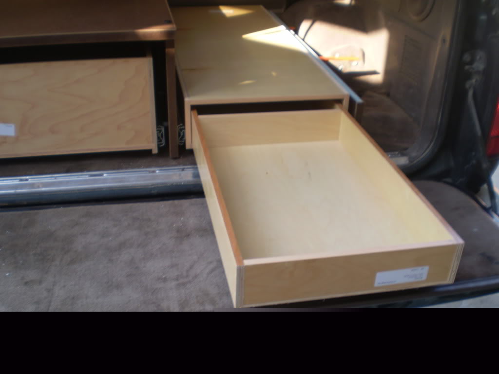

This shows the fridge pull out with a removable tool drawer that will also work as a table when finished.
The Idea is to be able to remove the tool drawer and bring it to the front of the truck when working under the hood. Or just in case you have to jack up the back of your rig you can get the tools out first. This is a small drawer but it should be big enough to hold all your renches sockets Ect.

Looks cool....so the fridge side is a two piece slide out?? one for the drawer and then a seperate slide out for the fridge??
can you make the fridge one for the drivers side??? will it have a top and go all the way to the panel like mine does now?? guessing it won't cause the wheel well gets in teh way...just got home from work...been there since 6am..little sleepy...
I like it! Just wonder about the "wasted" space above and below the drawer? The drawer could be alittle bigger or the cabinet a bit smaller. Not that big a deal though.
