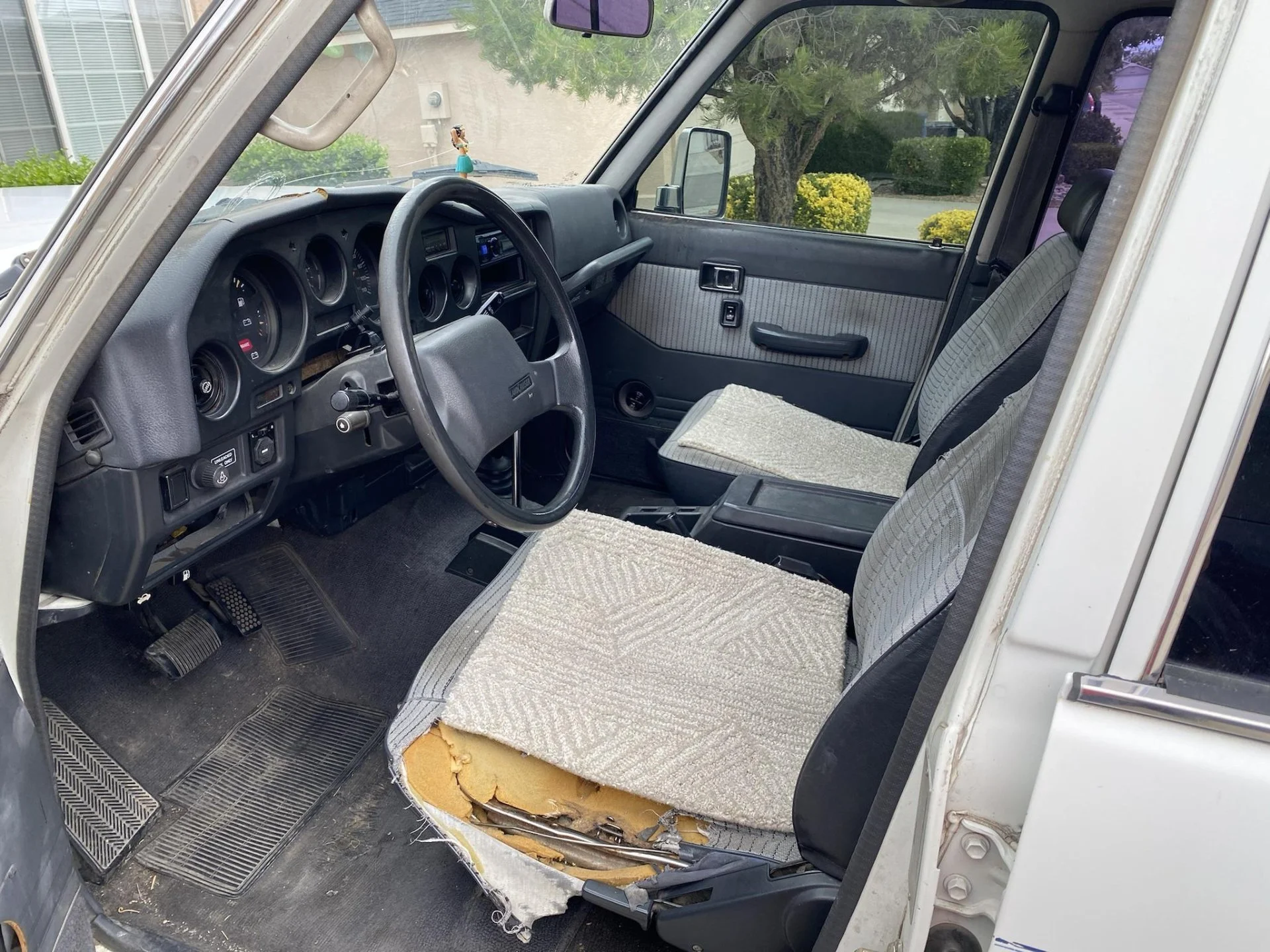

    • Seat first, half the foam is gone

Like the mini trucks can you swap the seat bottoms passenger to driver to get a little more usage?

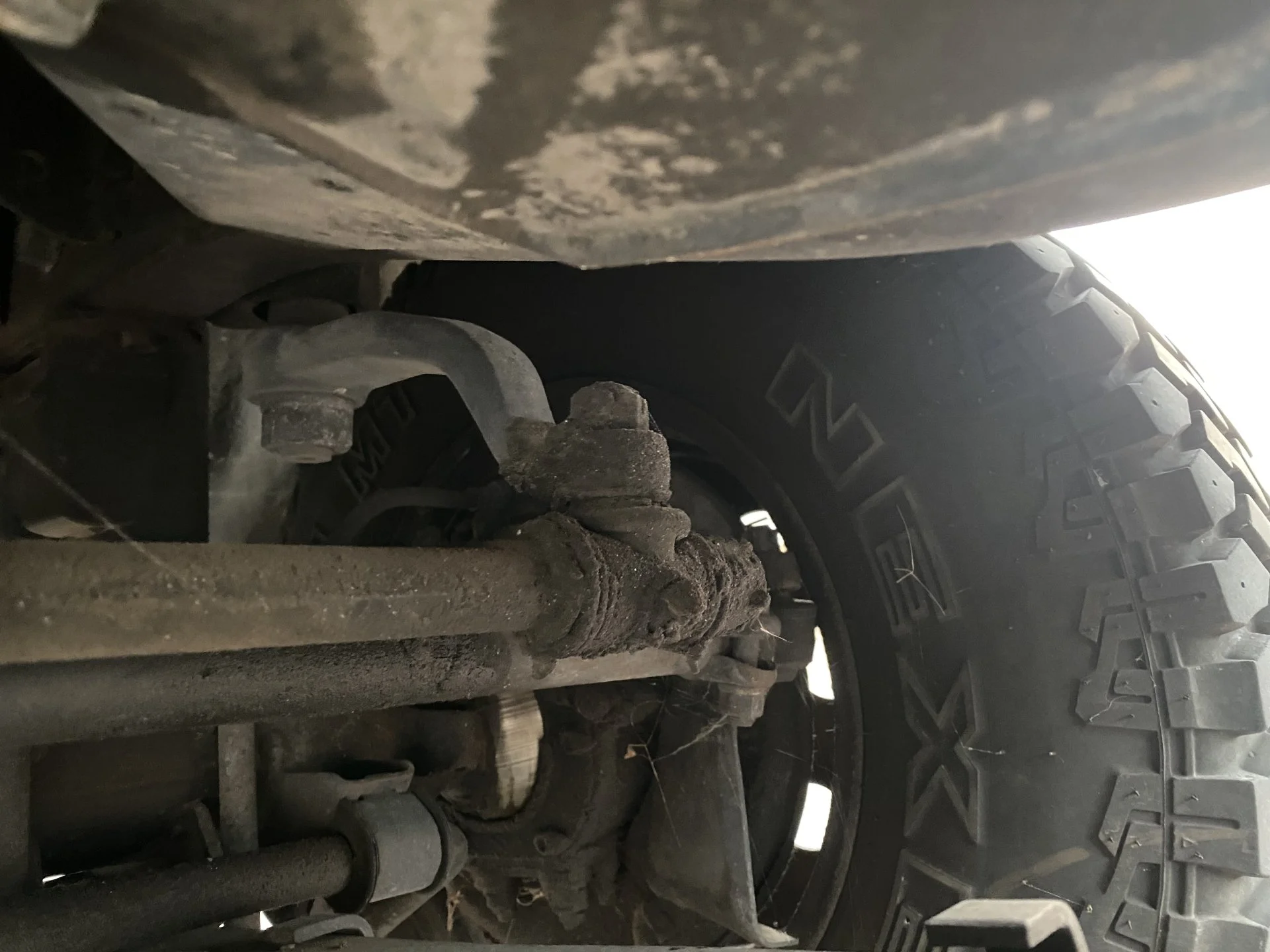

This looks to be the main culprit, good amount of slip here between the steering arm and the tie rod

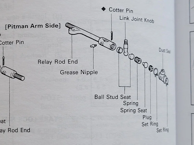

You know what? That looks like the same setup as the solid axle mini-trucks. I think those are easily rebuildable. Check the other side of the drag link. I think it takes the same parts.
IIRC this is the only rod end like that on 60/62. A ghetto fix, again IIRC, is to shim it with a penny.
Upholstery shops can do wonders (with foam) if you want to keep the original seats, though matching the fabric is probably impossible.
