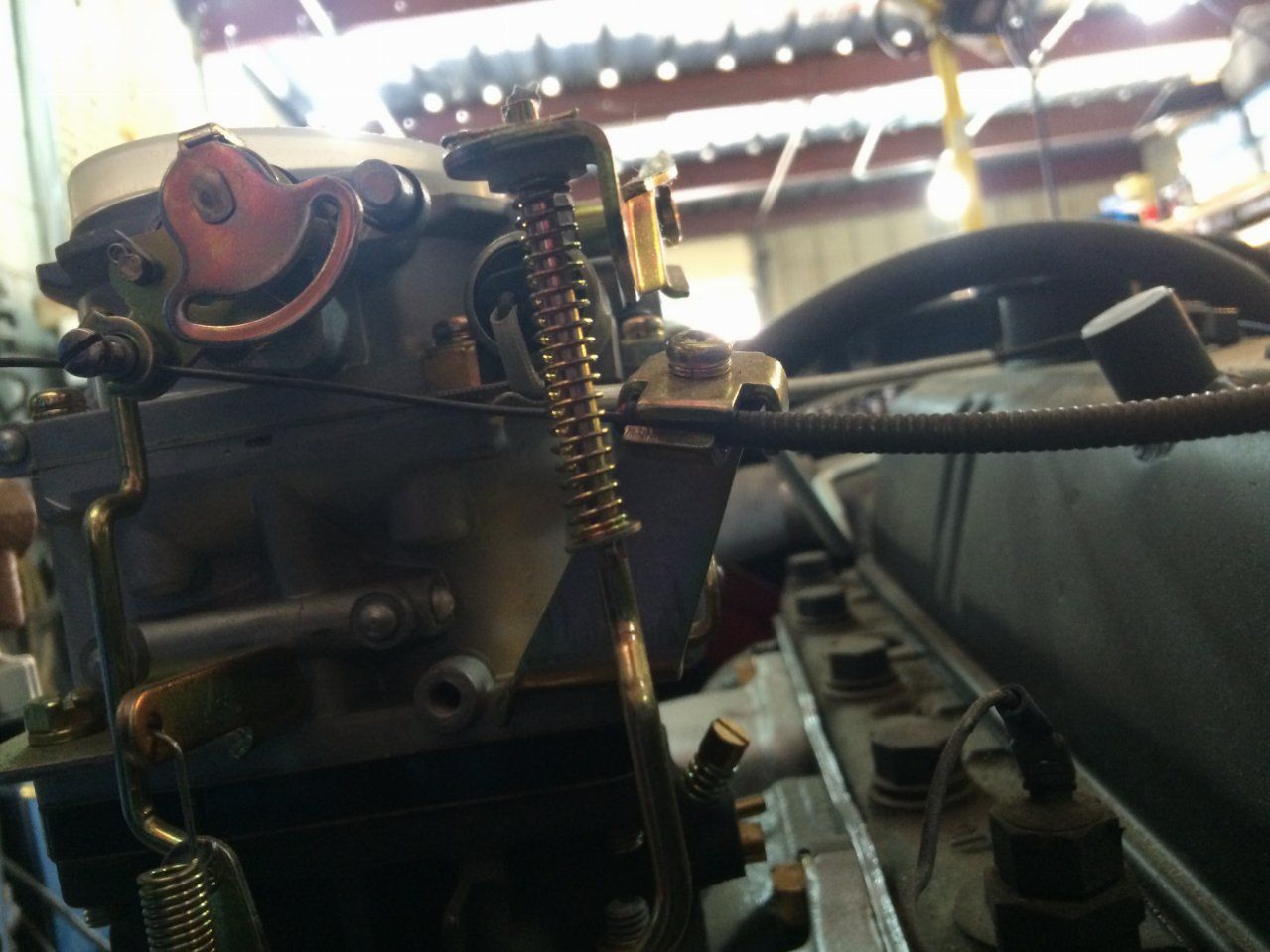

How did you hook up the choke cable? Do you have a pic, I am lost on this. Thanks.
Did anyone ever reply and tell you how to hook up the choke cable, I need to know too?
Here are a couple of pics of how the choke cable is hooked up. Hopefully this helps.
I cannot view your images, it takes me to an external website - pls tell me how to proceed?
Try later today. It looks like you just became a member over the weekend. Maybe your account is not yet fully activated.
BTW, Trollhole carb is awesome. I prefer it over my de smogged and rebuilt Aisin.
