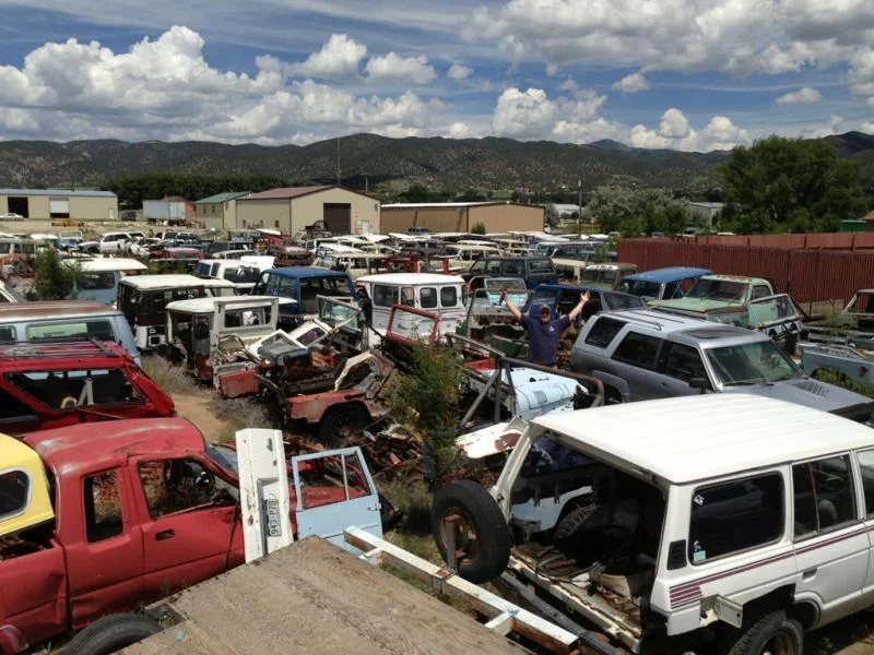

Also know cruiser specialties in salida co has a bunch of them. I saw them with my own eyes.

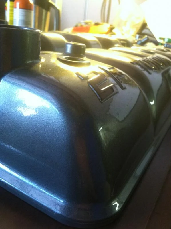

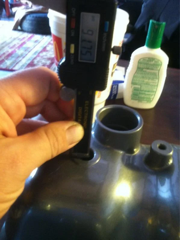

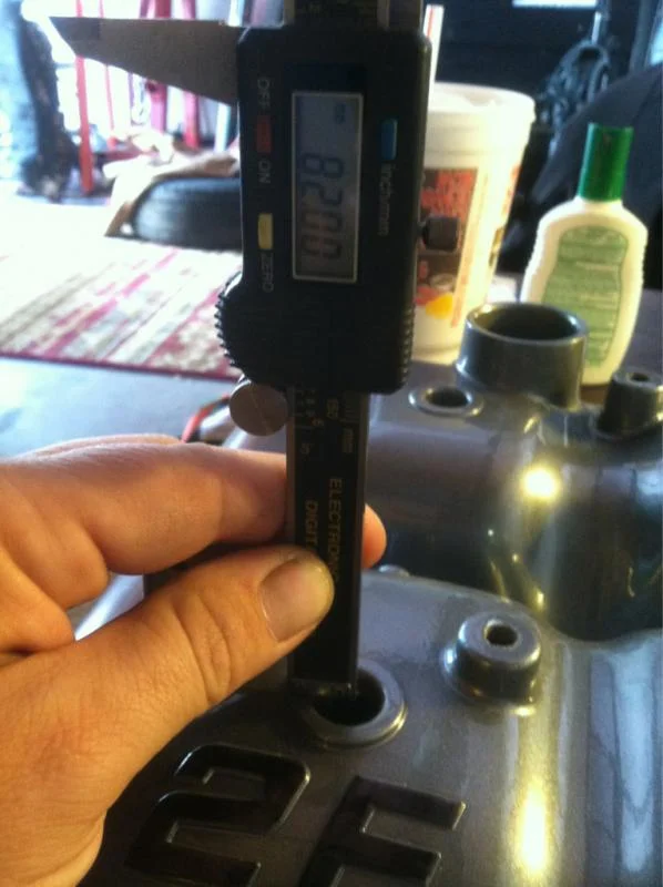

Since you have the early 2f valve cover I'd go with a 79 and earlier 2f air cleaner. The valve cover will dictate the type of air cleaner that will work best.
Later
Early
Top view. Notice the air cleaner mounting hole locations.
How much taller the earlier is than the later.
