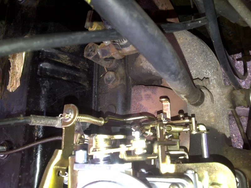

Hi Marshall. I just installed my new carb today. Installed very nicely. I am having two issues that I can't seem to work out. I am not a mechanic or LC expert by an means, but can grasp the basics. Number 1..I can''t get the idle down. Carb idles way too high even though I am utilizing the idle screw. When I am driving the 40 it's rev'd up way high at a stop light, but runs great when I am on the throttle. Number 2...the throttle pedal now does not return to a full upright position from the floor board. The pedal seems to have a lack of spring to get her back to a low idle. Any ideas? I can send pics of my installation if that helps. Thanks again for the carb and any help you can offer. Cheers.
Linkage pics.
Couple things you can do. Sounds as if you throttle cable is binding though. I'd remove it and lube it up.
Second thing you can do is shorten the silver spring on the accelerator pump. Maybe a 1/4 inch. This will tighten things up.
Third thing you can do is bend the throttle cable bracket down a little to make the cable a little straighter.
And last you can attach another spring to the arm sticking out near the cable end attachment is.
