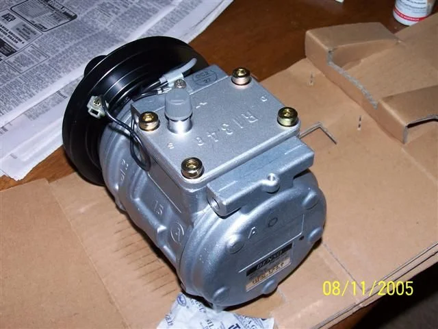

aircon puzzle
This is my new aircon compressor that I got yesterday. Its supposed to a straight replacement for HZJ75 comp and its even made by Denso in Indonesia.
What I dont understand is why it only has one outlet on the top and there is none on the sides either.
The aluminium plate mentions High3.53Mpa and Low 1.67Mpa as if there is a high and low pressure sides.
The plastic cap on the single outlet has a L stamped on it , for LOW??
Is there anyone who can tell me how I fit this into my existing aircon?
I can get a refund but I thought I would see if anyone out there knows the answer 1st.
I got it off someone I get most of my small parts from but they are not much help on advice when it comes to fitting parts.

Wow, I'd figure there has to be at least an inlet and a discharge :confused:
Could the shop have supplied you one where you have to replace the top plate to fit your particular engine? Does the top plate look like it is a substantially permanent piece or just a temporary cover until it can be installed? It may be there just to test it at the factory, but this is my wild ass guess :D
Does the pulley placement look correct?
Dave
You could be right Dave. The top plate looks similar in size to my old one.
I believe they supply these to the mines so it would have to fit the 105 and 75 series.
Its got to work somehow but its strange it has just one inlet.
Pulley placement looks good from memory.
Update. Dave you hit the nail on the head. The plate is only temporary and the sinlge inlet is to mildy pressurise the pump to stop the seals drying out.:D

:doh: missed this earlier, my new compressor was the same, had to fit the top off the old unit.. :o :cheers: will be glad you bought a new one,super cool.
