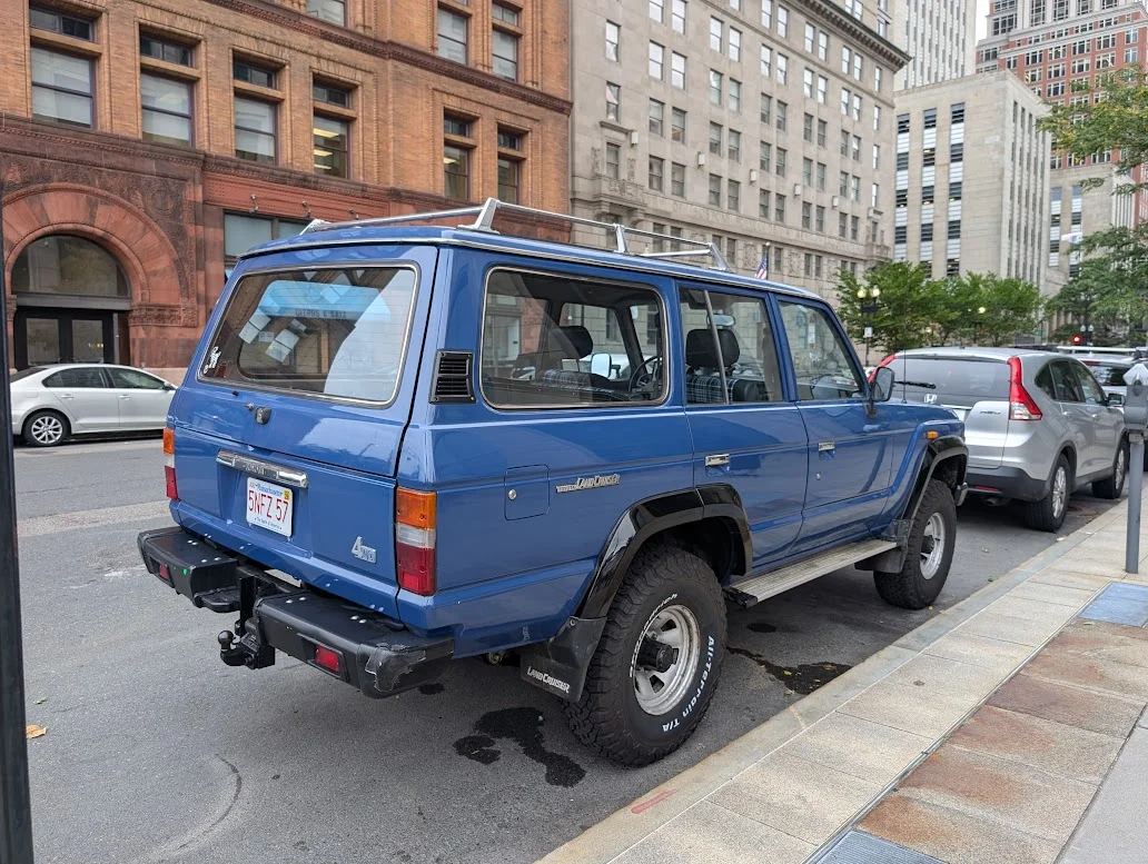

2026 update! LOTS more work transforming the 60 into a true, "no compromises" daily driver. Been driving it as my only car the past month and I'm having a blast.
If anyone is curious about the work required to daily a 60 in a major city in 2026, I've included my list below.
I started with a one-owner, rust-free truck from the Canary Islands. Passed rigorous Spanish inspection every year, with maintenance history all the way back to the original window sticket
Full fluid service
Injection pump re-seal
Reupholster seats and door cards with Scottish tartan wool
Rebuild leaking A/C compressor. Has held its charge for 2+ years so far since the rebuild
Installed Dobinsons suspension
New KO2 tires
Shipped the turbo and injectors to rural austrailia for a full rebuild by the best guys in the world at old diesel toyotas
Had a local diesel shop pull the head for a top end rebuild by a well regarded local machine shop
Installed a brake booster from an 80 series and a brand new clutch booster so both pedals are feather-light
Brought the power steering pump to an industrial hydraulic shop for a rebuild so parallel parking is a breeze
Install hidden speakers in the rear deck, a 24v Continental head unit, and a 24v subwoofer tucked under the drivers seat. Looks stock, sounds modern
Install all new brake components including master cylinder, hoses, and calipers. Used stainless steel hardware from home depot to adjust the brake proportioning valve for the dobinsons lift.
Replace thermostat and all heater hoses
Pull driver's door lock cylinder for rebuild
Install 4runner windshield wipers, replace windshield washer pump
Replace voltage regulator
Replace glow screen relay and engine coolant temperature sensor
Replace hood and tailgate struts
Replace hood pad
Krown rust prevention service (annually)
