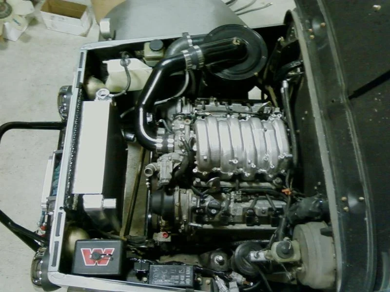

Next job I might take on is hooking up the snorkel. Ill have to move the washer reservoir and figure out another spot for it but otherwise it shouldnt be that bad. I do have to find an air filter box form something that will fit in the space I have since the van doesnt have the oe air can. A buddy has one from a 4l ranger that looks to be about the right dimensions.. Otherwise I plan to use some mandrel bent 90's and 45's to go from the motor to the apron.
A couple crappy pics of the engine bay, any suggestions would be welcome.

Got the snorkel hooked up, just need a new air filter. Mounted the windshield washer bottle on the ds fender with a bracket I jiggered together. Also removed the charcoal canister.

I like the idea of mounting the air filter in a ammo box. I am not eager to put my old big stock filter canister in and weld and plumb for snorkel.
If i find some kind of clampthingy for the 3" hose, i'll steal your idea!!
Or did you just weld in 3" pipes to clamp to?
I picked up some 3" exhaust tubes and welded one on each side of the can. If youre careful the ammo can wont warp too bad....
