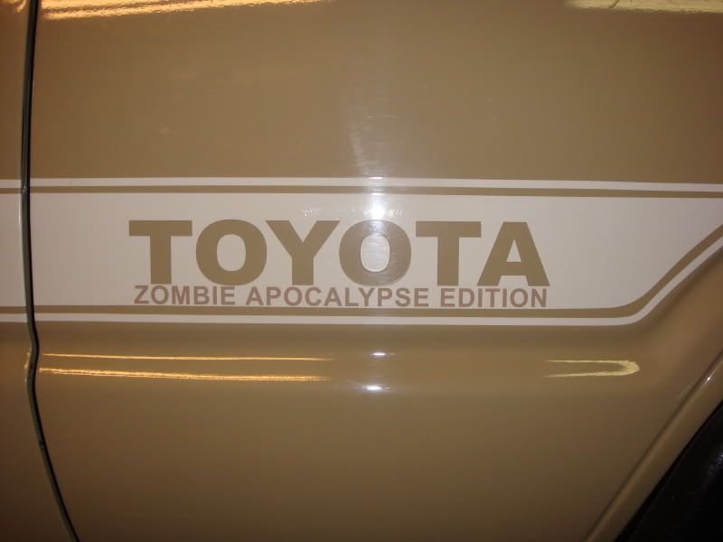

The dude that built the van had that stripe painted on. He used the "toyota" on the grille to get the font/size of the lettering and had it done in cyogen?sp? white. I am wanting to continue the theme by laying down some stripes on the ds side of the hood. Kind of like the 80's minis had. Probably never happen though.
I am planning to get the local sticker guy to make me a couple small "zombie apocalypse edition" stickers in tan to stick under the toyota in the stripe. Might be cheeseball but I want to see what itll look like..

Holy Awesomeness! Zombie Apocolypse decal?! Keep us posted... I'll order a few for my truck as well!

I have 2 tan, 4 black, and 3 white left. Probably keep the tan but the others could be up for grabs.... Ill post em when I decide what Im gonna do with them.
