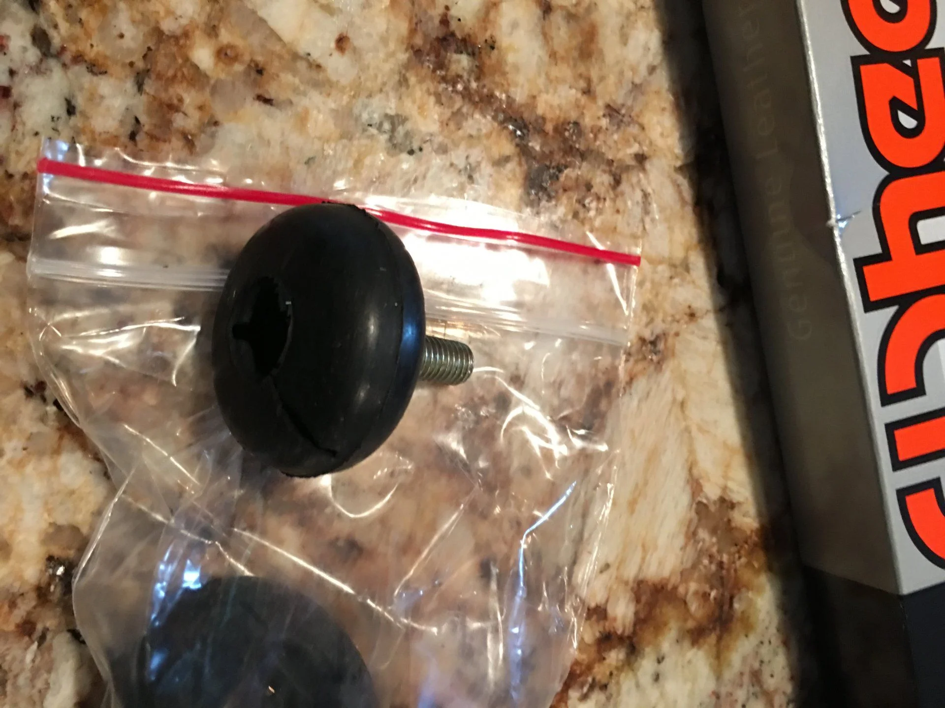

hood Bump Stop replacements

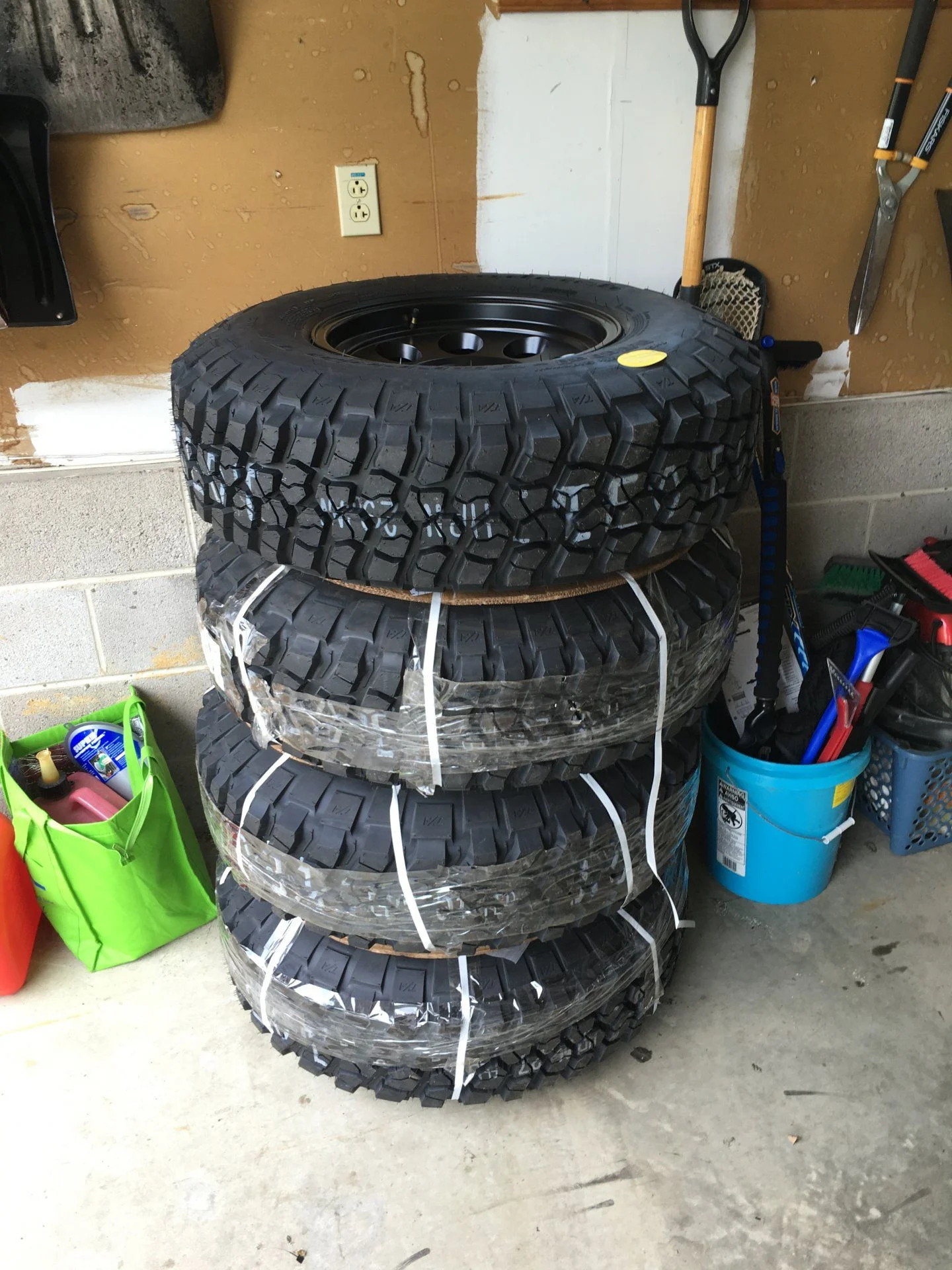

BFG 255/85/16 on Level 8 trackers

So unfortunately the freight truck decided to take the day off today and my OME will be here Monday. Will have to wait another weekend to swap the suspension luckily plenty else to do. My truck came with 2" taller shackles so I went ahead and mounted to new tires and what a difference. Have the ARB ready to go tomorrow, had to flip the winch to mount forward facing.

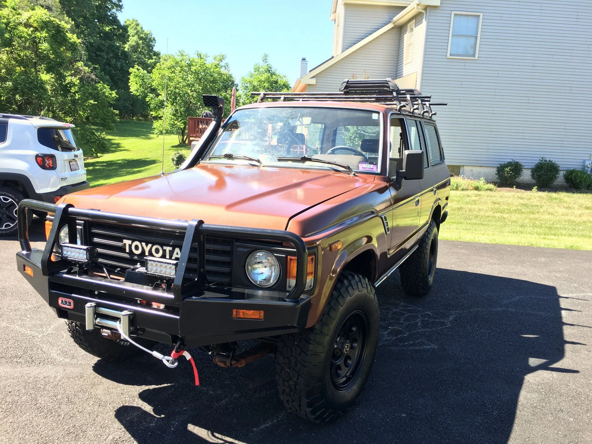

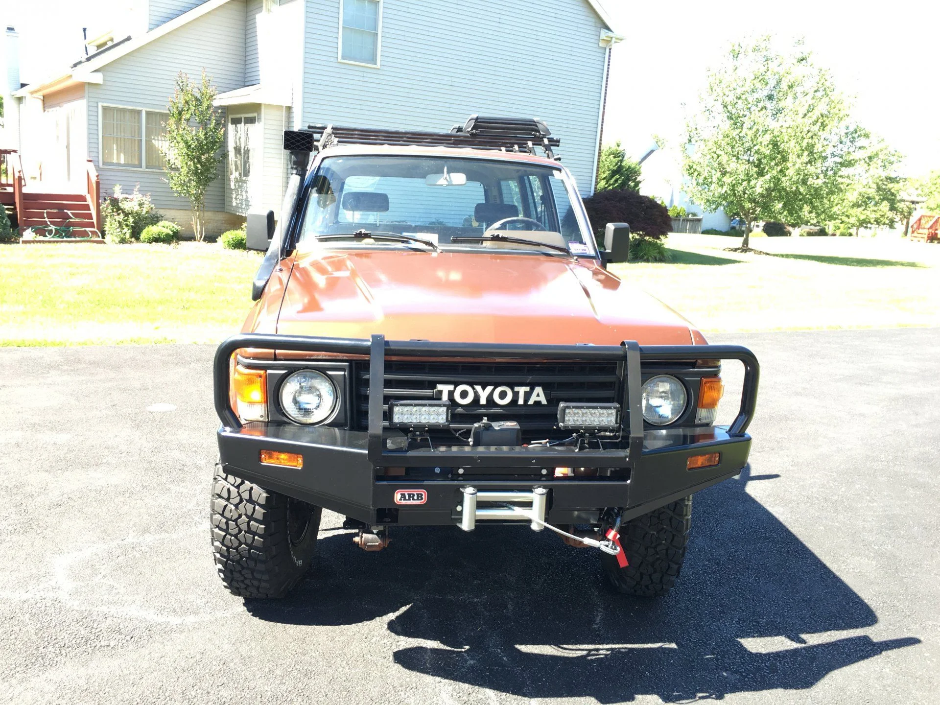

Made a lot of progress today ARB bumper went on with the 9500 lbs winch and 7" LED bars. Went to bars as the rounds blocked to much air.
Tackled the Aussie snorkel install stencil was spot on; only thing is the 3rd bolt hole is not needed as when I punched through I hit thick metal that was impossible to get a wrench on to eve tighten so I left it out. Riveted the support bracket on to the windshield frame. Quite happy with the look and install.

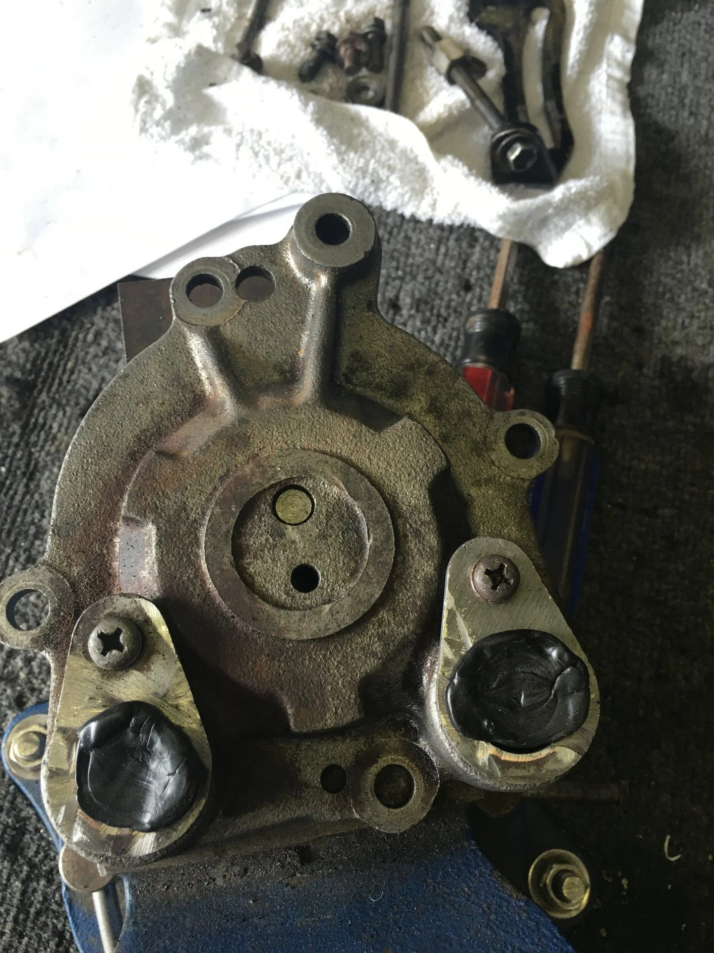

Engine has been making some noise, thought it was the Fan Clutch so replaced that first it was not it. Next suspect was the smog pump, got that out and spinning it it was clear that the carbon shoe was loose or broken. I got the pump apart and will GUT it following fj40jim recommendations from this thread.
Gutting a smog pump w/ pictures

After gutting putting the pump back together. Its not spinning "freely" in my hand still has some resistance to it, did i miss something or is it bent maybe?
Hard to say brother. To be honest, my pump was still good so I didn't gut it. I just ordered the idler pulley to replace it.
Someone with first hand experience will chime in soon though. Sorry I couldn't be more help here.
I agree with @CaptClose that it is just easier to get the pulley and be done with it. I tried gutting my pump and it worked fine initially but seized within something like 30 minutes after starting the truck back up. Just have piece of mind that it was done "properly" by using the pulley unless you are trying to mock-up a fake emissions system (heard of some guys that do this). If there is resistance that you can feel that means that it will fail in fairly short order. The extra money spent on the pulley is well worth it, mine has operated flawlessly for 3yrs now.

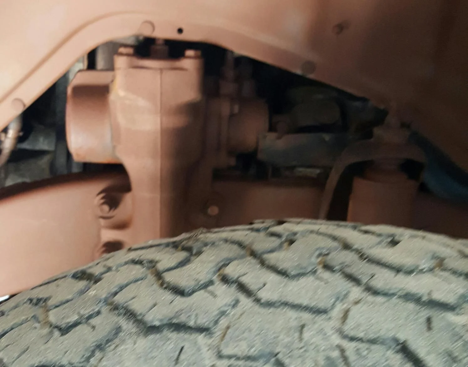

Saginaw PS conversion (Done now redoing with desmog)

*note: I did the Saginaw conversion without a hitch however decided to get to it and not read through the instructions. I used a press to press the pulley on and damaged the shaft internally, the result after about 500 miles the PS pump began squealing regularly under load and turn with my larger tires. So i am replacing it and doing correctly this time.
