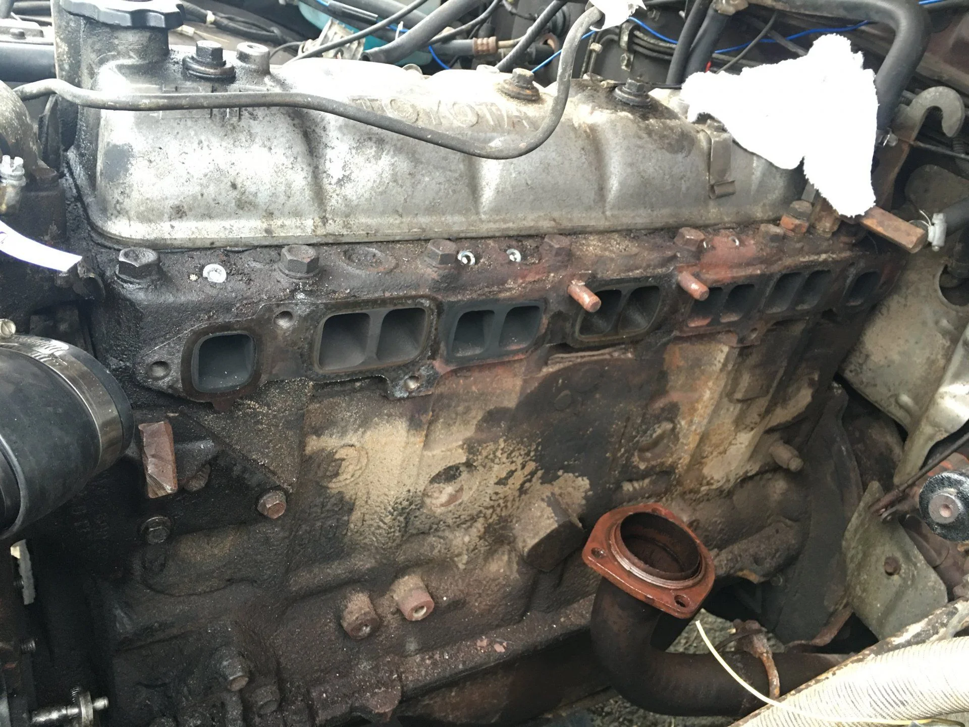

The manifold is off. Forgot two bolts originally couldn't see it in the gunk. Also to add to my surprise a cracked manifold intake. Lovely
No I am on the Hunt for a replacement that isn't 350$.
In the meantime, I tore down the exhaust

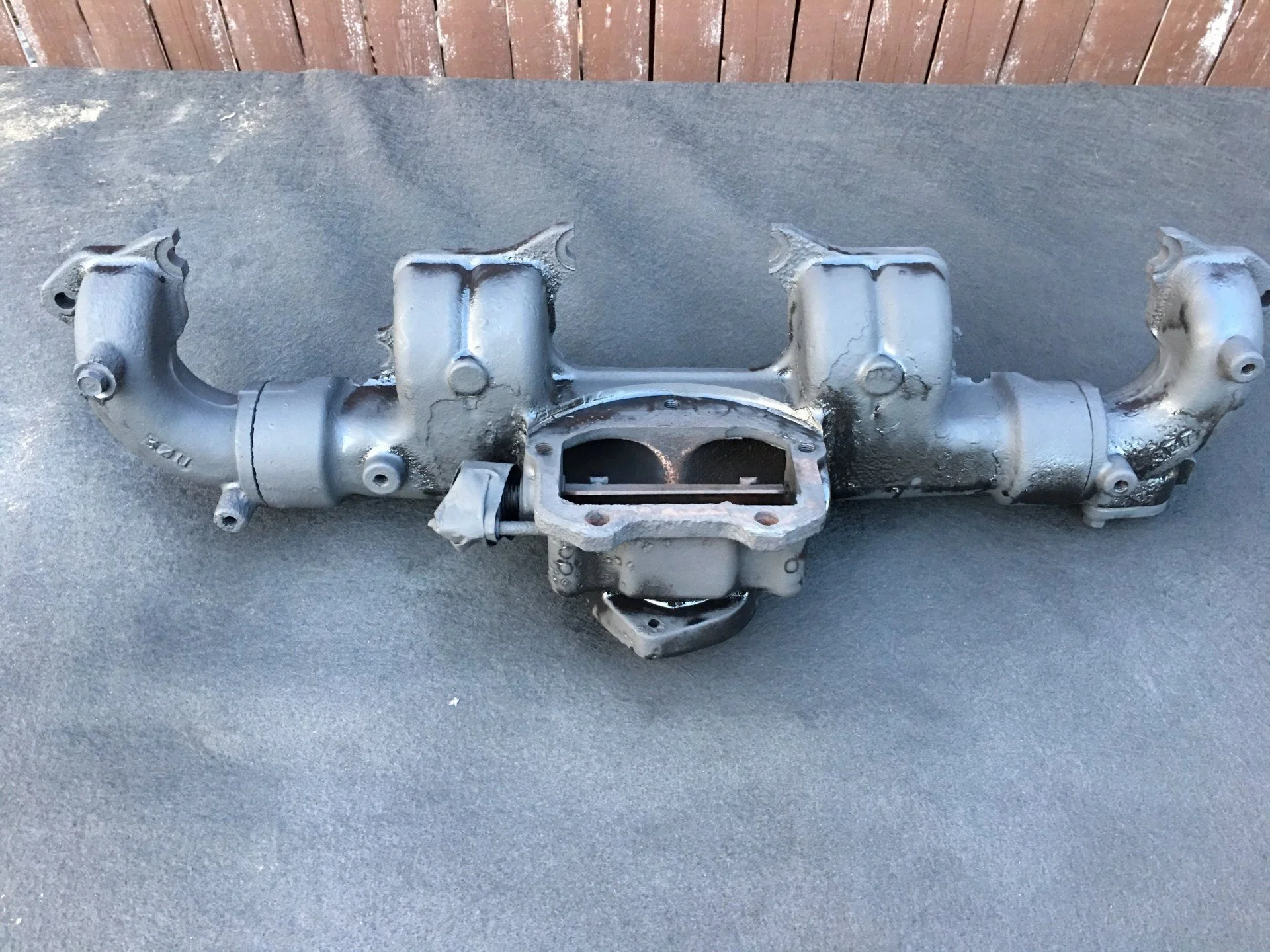

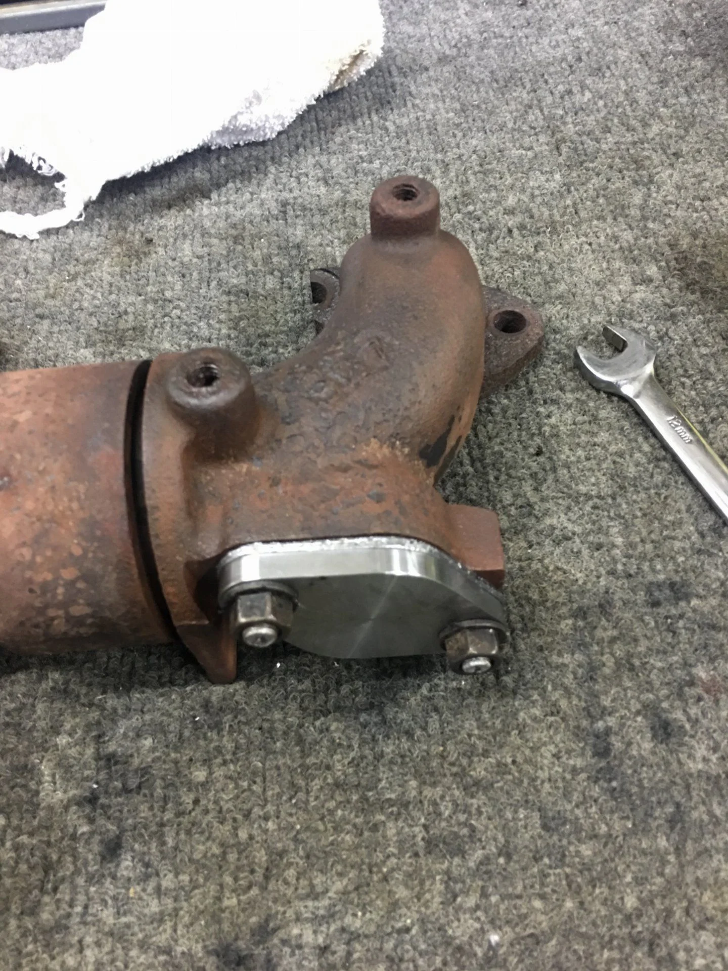

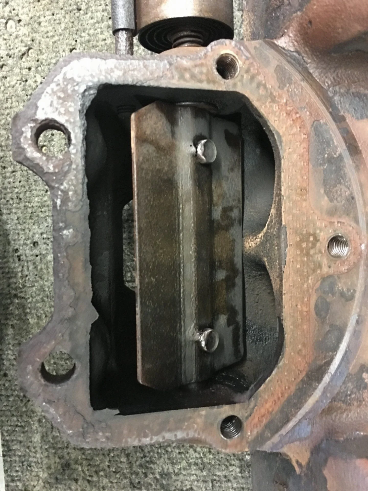

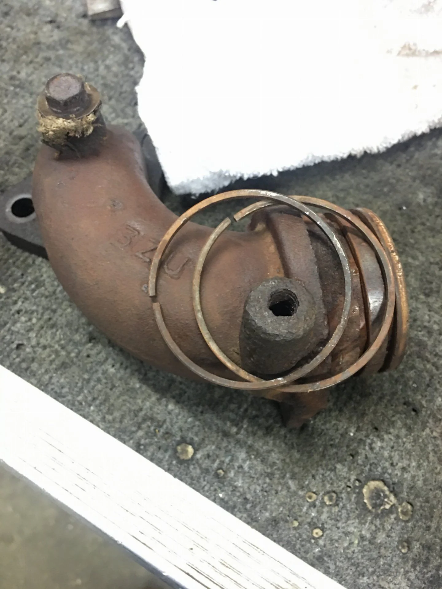

Manifold cleaned it up with parts washer. The surface is in bad shape will definetly get it machined. I removed the side jay pipes and prepared them to replace the Teflon rings and springs. My flapper and cool spring are actually on good shape surprised with it working the manifold still fracked. I installed the EGr plate from JimC. Ordered all new gaskets and hardware for complete manifold reassembly, carburetor hear shield new OEM thank you @beno @FJ40Jim @CaptClose for all the help parts and feedback. Here is were i am at till parts come in.

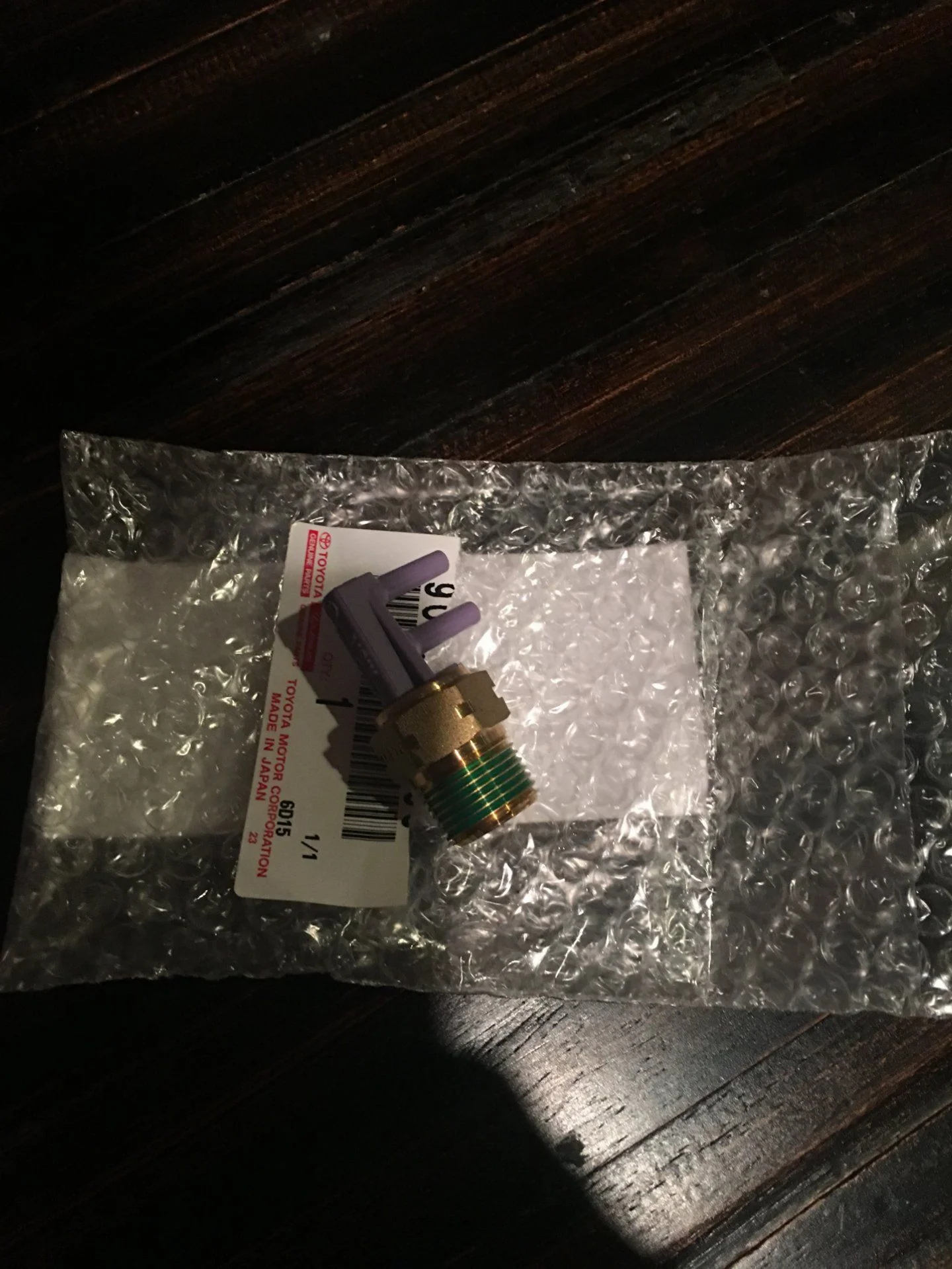

Brand new BVSV(1) came in

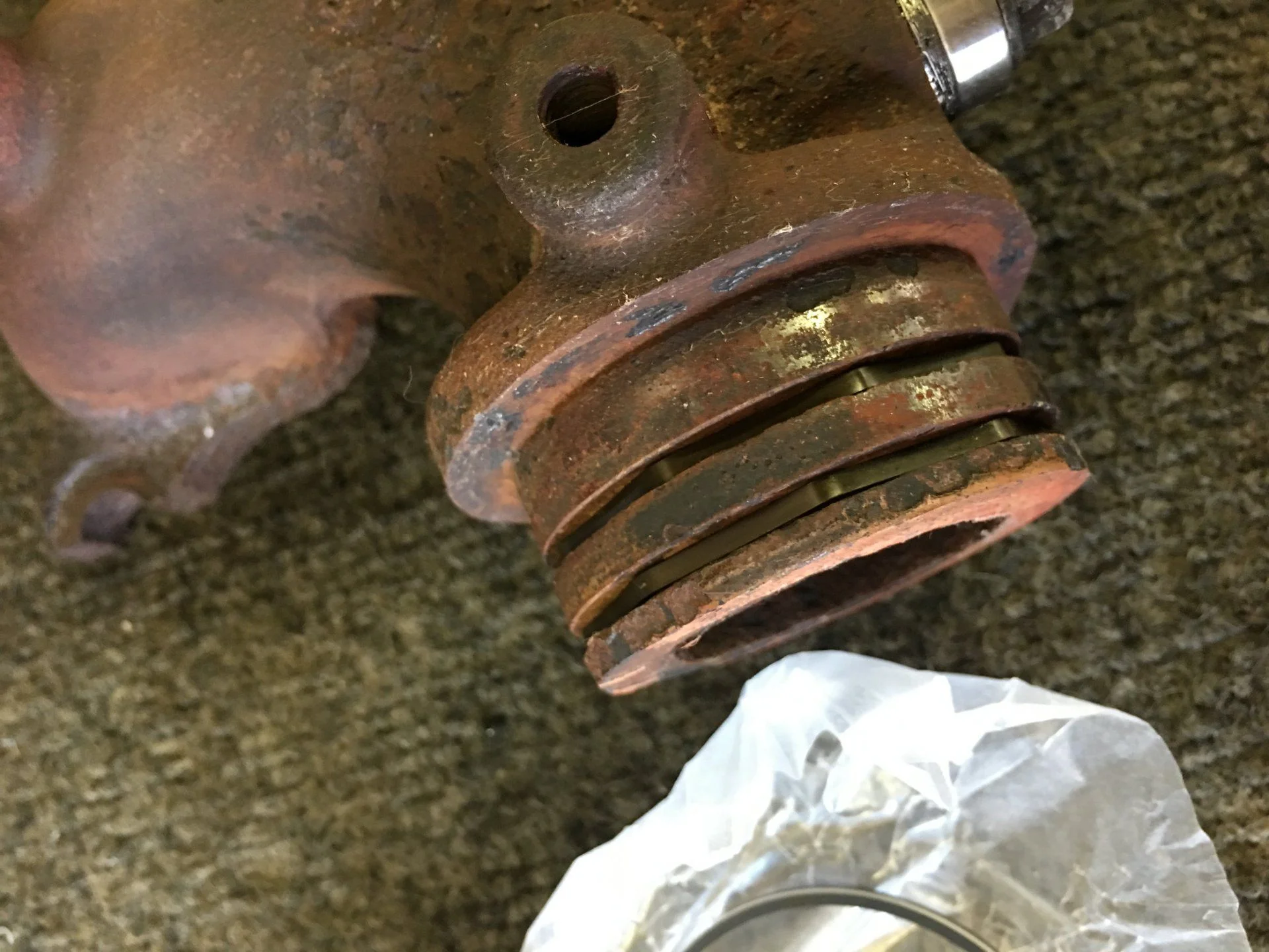

While I wait for it to get here 48 hours I've been painting the exhaust manifold with 2000 degree high heat black paint. I Also installed the new springs and Teflon rings/gasket for the curved J pipes on the side for a good seal thanks @beno .

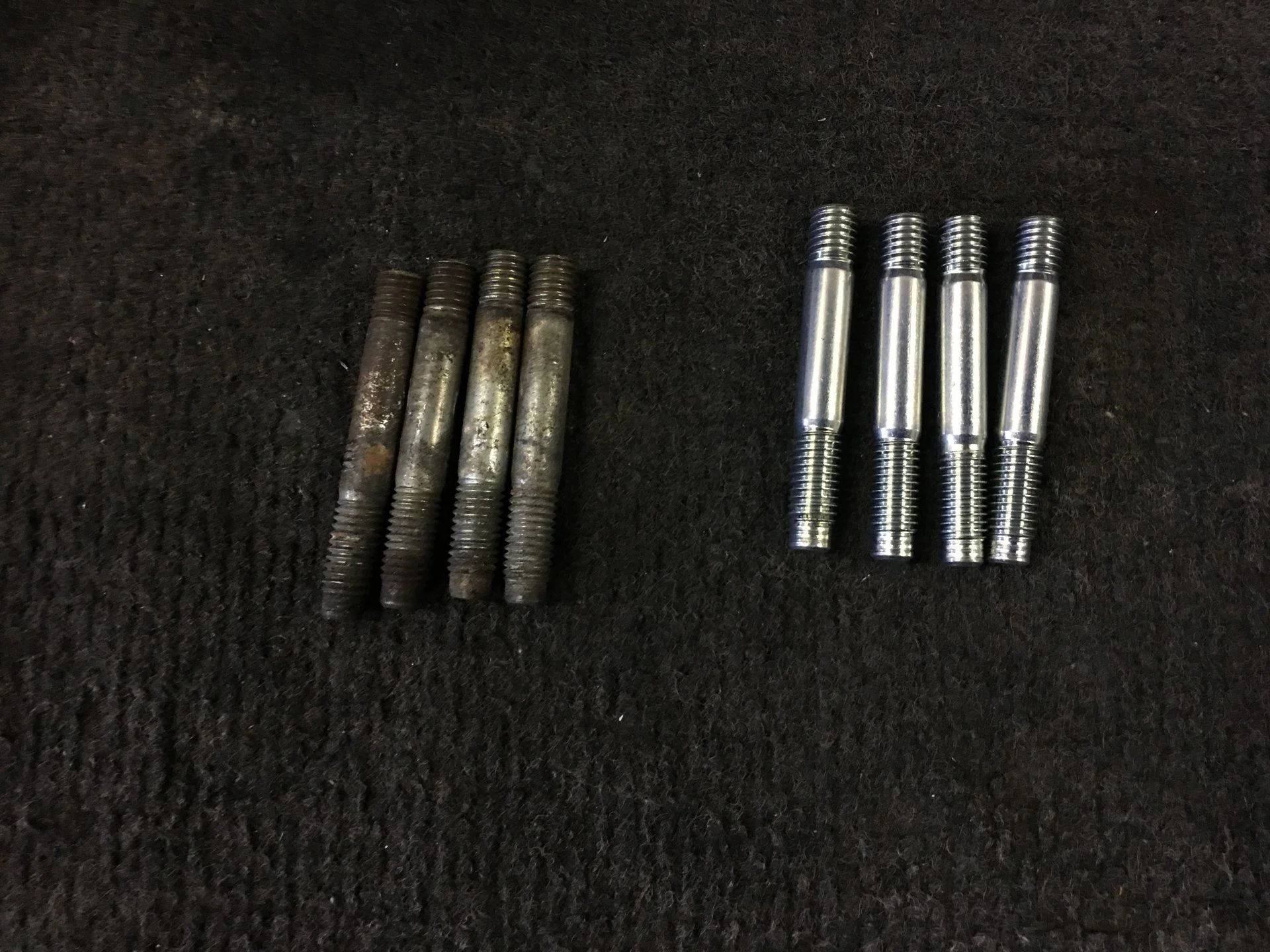

Old
New
I have to new hardware for beno to replace all the manifold studs, bolts, gaskets, carb studs, etc.
