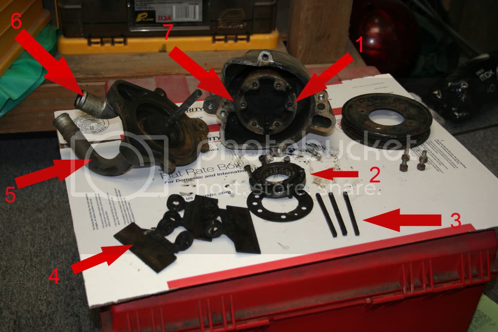

Hey guys,
I'm doing a full desmog w/ headers on my 60 and have a question about gutting my smog pump.
Can you tell me what to gut?
1. Cylinder inside of pump attached to shaft
2. Bearings + washer held on by 6 allen heads (grease?)
3. Carbon smog sticks?
4. Carbon smog flaps
5. Do I plug this?
6. Do I plug this?
7. Friction point - if I don't take out the cylinder (#1) to I grease here?
Once I have this cleared up I will update this post so people gutting their pumps can use it as a resource.
Good picture!
If the rotor (#1) is rubbing on the housing, then the pump is already bent, which could be a problem. W
When the pump eats a vane or a seal, it gets jammed between the rotor and housing at the "friction point", which bends one of them.
How to gut:
discard:
#3 carbon shoes,
#4 vanes,
#5inlet pipe,
#6 disch pipe.
Cut the center shaft off the rear plate. It's only there to hang the vanes.
Make sure that all carbons & leaf springs are removed from all slots of the rotor.
Clean things off, regrease bearing #2.
Bolt #2 bearing & shim to rotor.
Reassemble pump.
Done.

Do I need to plug the holes where #5 and #6 were? I was thinking I could weld disks over them so gunk doesn't get in there.
I think the friction @ #1 might be from dirt/ grime. If it doesn't clean up and move nice, then I'll order up one of your pulleys or run dual alternators.
Ohh, and if anyone wants my vanes or shoes I can mail them to you. They seem to be in great shape.
-FJ502
It is not necessary to plug the holes. If it would make you feel better to plug them, try using a couple of metric cup plugs.
Regardless of whether the holes are plugged, it is also a good idea to drill a hole in the bottom of the housing so any contaminant inside has an escape route.

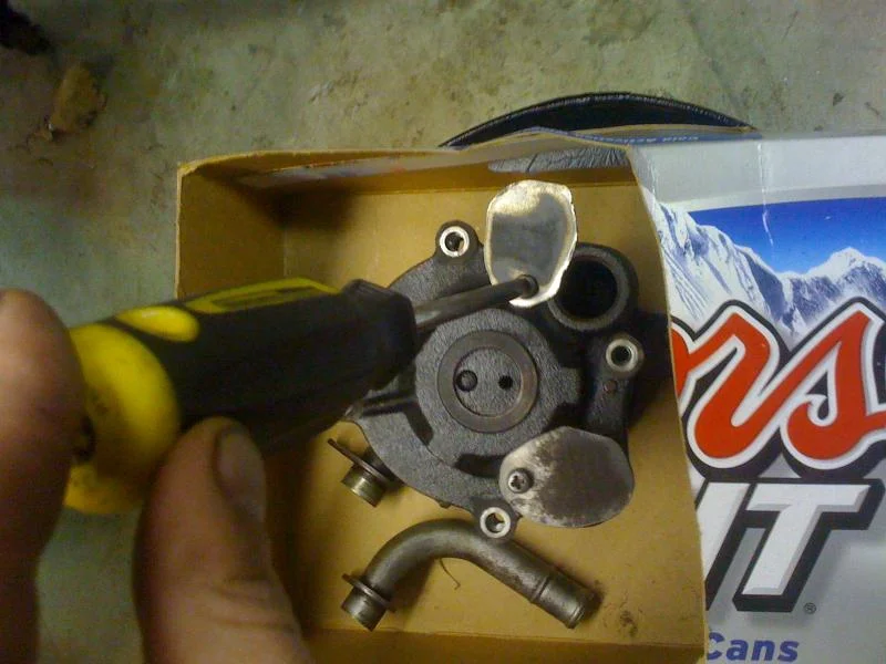

Fantastic post FJ502. This is a simple thread with a great labeled pic.

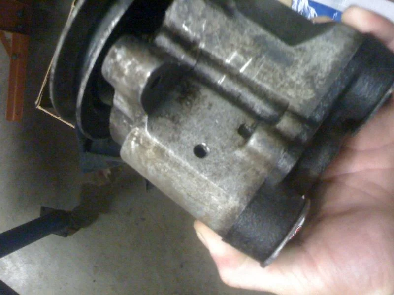

Jim - Is this weep hole big enough? What kind of contaminant are you thinking might be able to get trapped?
I just realized i put the weep on top:doh:JB welded it and it now has the same diameter hole in the bottom:bounce:
I used the plasma cutter for the first time and made oblong circles and then drilled a hole at the top....now i have 2 peep holes on the pump in case i just want to peek inside w/o removing the back cover.

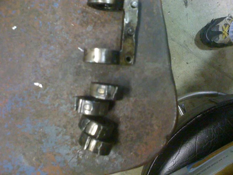

I highly suggest gutting the pump to see what's in there EVEN if it doesn't whine or make any noise. The inside of my quiet pump was trashed and i mean trashed but spinned well and never seized. The vanes were demolished and the vane 'holders' had bent and sheared off metal.....FUN!
Gut it, clean, reinstall or buy Jim's idler pulley. Luckily i have access to a garage with all sorts of tools (parts washer, plasma cutter, drills, workbench w/ a vice-grip, etc.) BUT YOU DON'T NEED A WORKSHOP......just makes life a lil easier.
