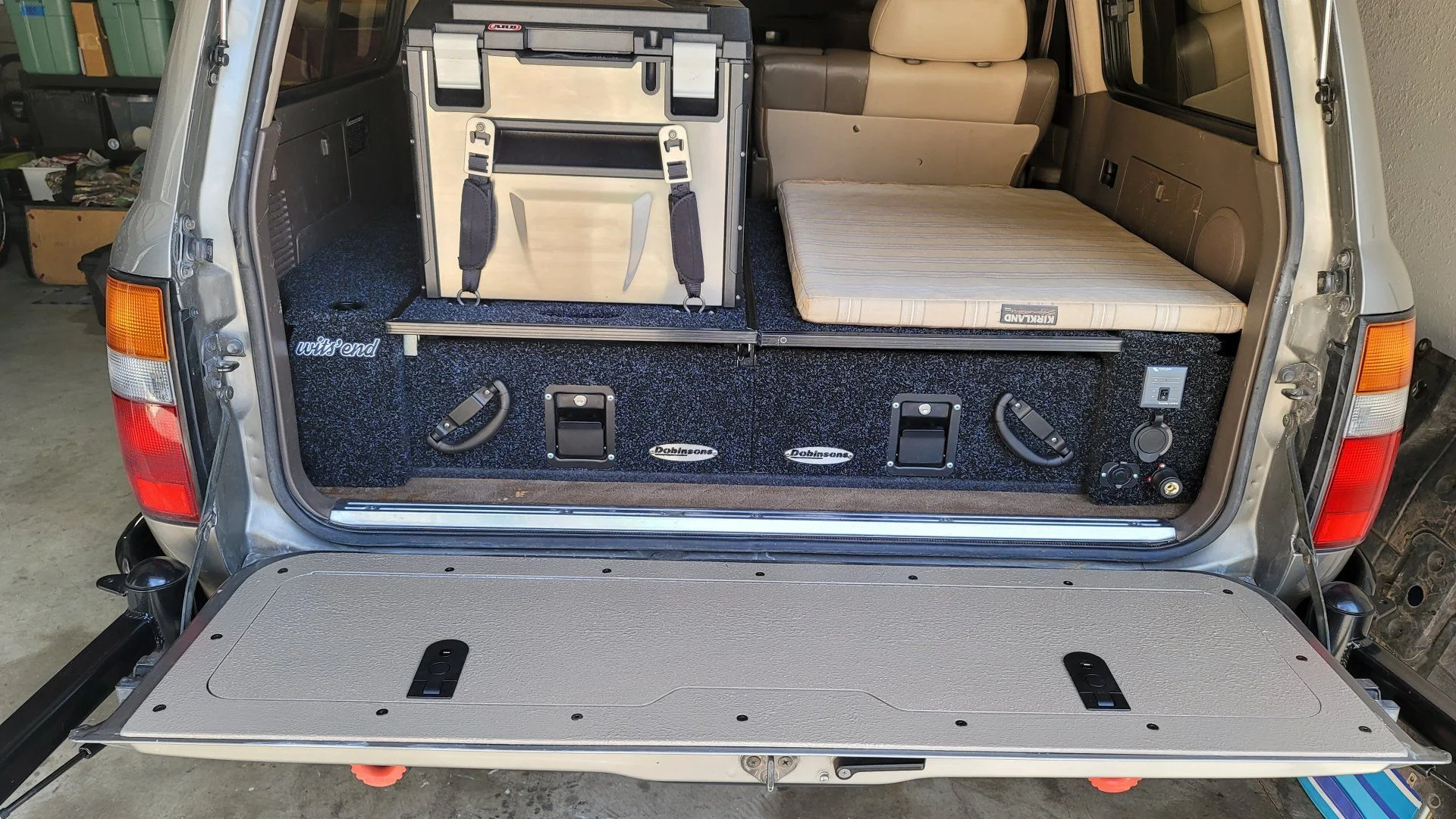

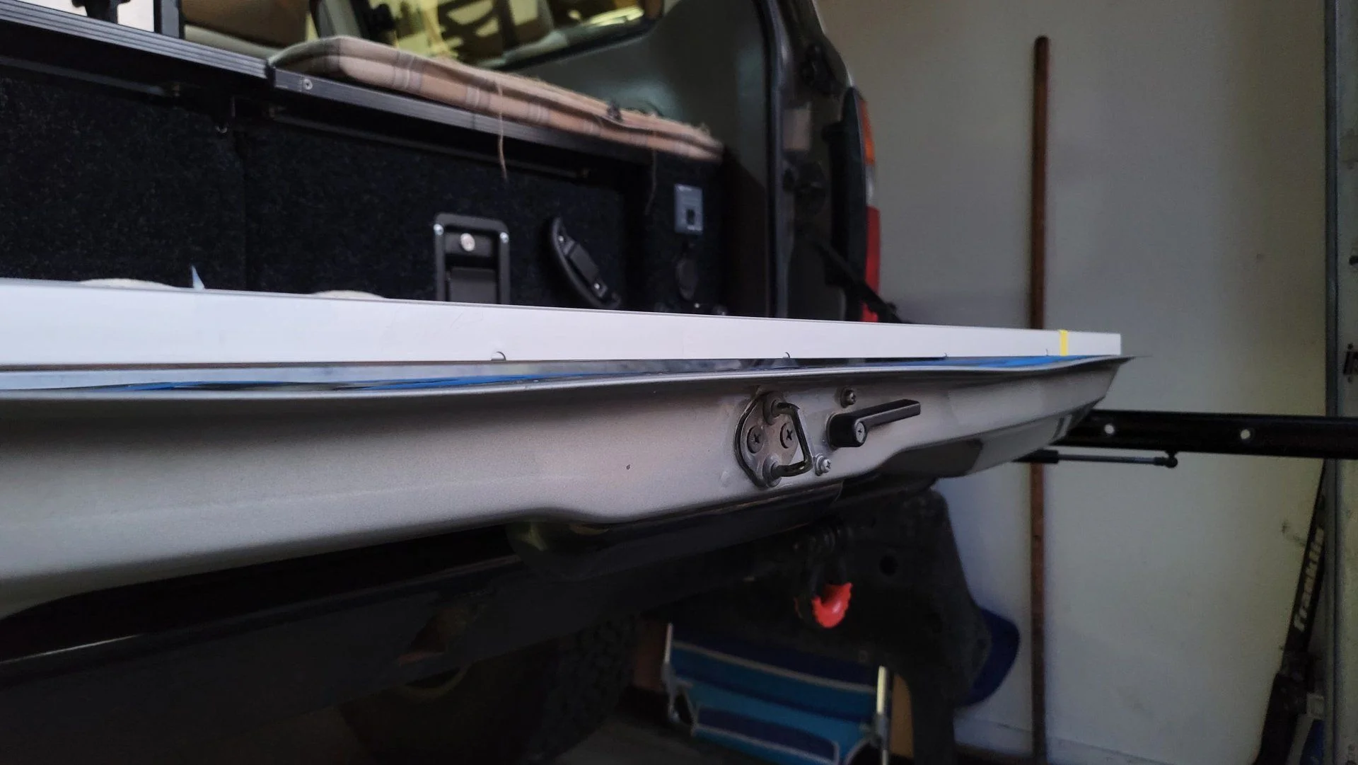

I just received one of these sweet @Notch designed storage units! I am afraid I am a bit oversized for this tailgate as I stand on it regularly to load my gear on the rack. I believe I have bent the top portion quite a bit over the years.
I read that some people had also bent up their tailgate. Did anyone have damage like this? Trying to determine if I will be able to tweak this/square it up easily once I cut the middle section out.

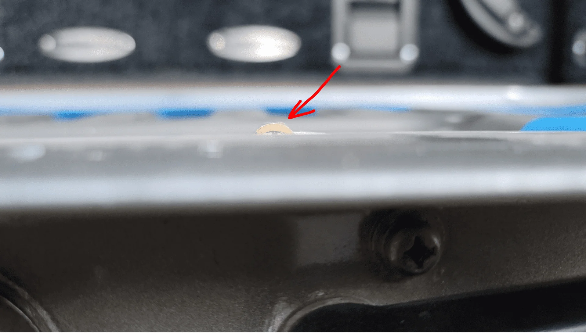

I also noticed that my latch pivot sticks up ever so slightly...I could tell it would hit the silver cover when I had the carpet on as well. It would interfere and be sticky to open. I am guessing this is due to my tailgate being out of square...
I don't think you well be able to get the tail gate flat again. I would use a block of wood to tap the lip straight.
I think the storage lid well couture to the slight bow of your tail gate.
I don't think that's part of your latch, it look like a washer got jammed into the tail gate. A better picture would help.
I used a rotating squad of hammers, pry bars, wood blocks, etc and managed to get enough leverage to "pop" a couple of dents I had in mine. I can't tell from your pictures exactly what you have going on, but I think @Broski is on the right track.
Well everything seem to fall into place here. There was a lot of flexibility with the tailgate once I cut out the mid section. I got everything pretty much squared up.

Looks good what was that sticking up in the second pik ?
Also I would say you got it flat, squared up refers to a 90 degree corner ;)
Flat. Yes, flat. The 2nd pic was the top of my latch. It was slightly above the flat horizon of my tailgate and would slightly interfere with the screwed on cover. But I realized that was because it was dented. Once I got it all cut out and reworked it is fine with the new setup.
For anybody that ends up in the same boat as @NorCalFJ100, placing a long piece of angle iron over the tailgate, will allow you to use some C clamps to straighten it out (once the center has been cut out). Use the angle iron as your straight edge, and clamp to it.
