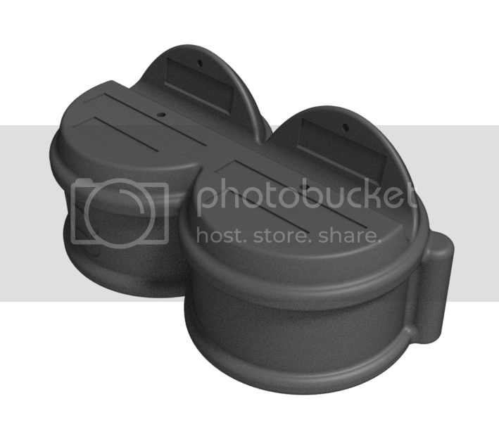

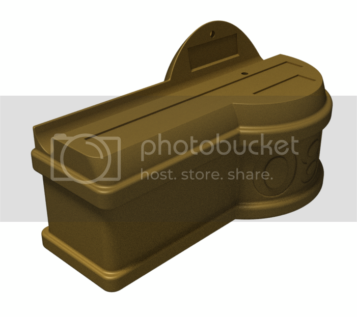

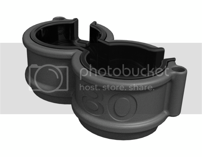

So I planned to stretch my design process out over the next couple weeks, but after all the feedback you guys got my wheels turning. I tried to go to bed early but my brain was spinning. I decided to stay up and crank out my ideas. I think I got about 2 hours of sleep last night. 8 cups of coffee later and the worst "twitches" I have had in my life; and I have some new ideas to show. Lets get some more feedback. You guys said you wanted a more subtle "80" so I did that. You wanted two cups; done. You wanted a cell phone/wallet/coins/crapola holder; done. I also made a couple subtle design changes to the overall look. The recessed area under the front was removed. That caused clearance issues, but I then moved the entire cup holder inward toward the driver by 5/8" which gave me back the needed clearance. I also tightened up the arch underneath that mounts to the center console and added more locations for the 3M adhesive. Hope you guys like all the updates and aesthetical changes.
And Design #3
And Design #3
I will be placing an order for number 3. It looks like a perfect solution for me. I use the dead space on the console just right of the transfer case shifter to lay my iphone. The Disco cup holder would typically eat in to that space and I'd have to find another place for my phone. This should solve that conundrum. My only thought on improvement would be to make the cell phone holder wide enough to hold my phone parallel to the dash so I can see when I get a call/text/email while a drink is in the cup holder, which may be a non-issue anyway. Thanks for putting all this stuff together for us, everything looks great so far. Now make me "TOYOTA" grill, plastic man. :bounce:
Also, if you don't run into any copyright issues, I wouldn't mind seeing some of these that say "Land Cruiser" and not just "80". NLXTACY, nobody even knows what an LX is. :flipoff2:
Will there be a right and left side for the one with the cell phone pocket? Keep up the good work.
