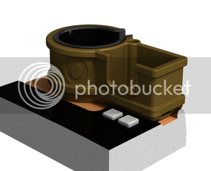

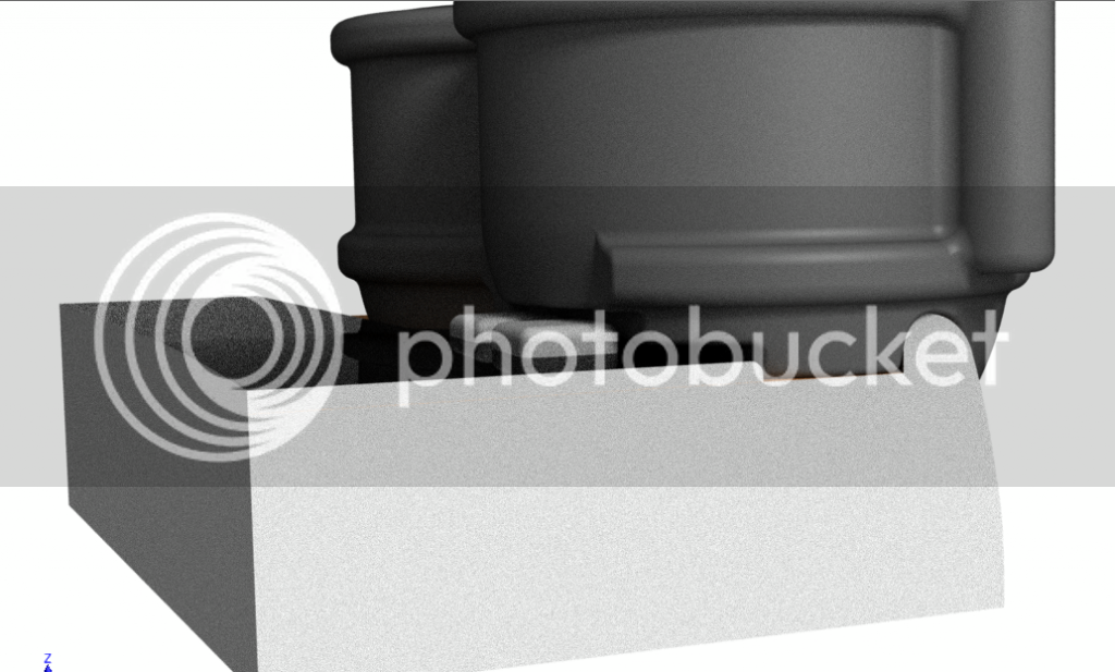

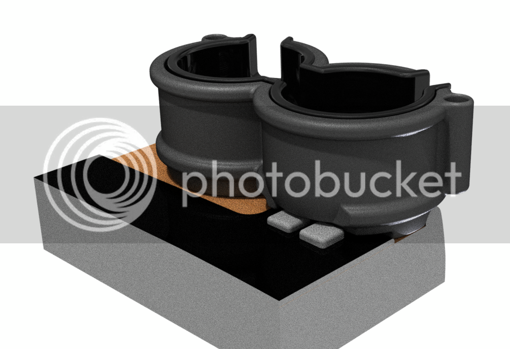

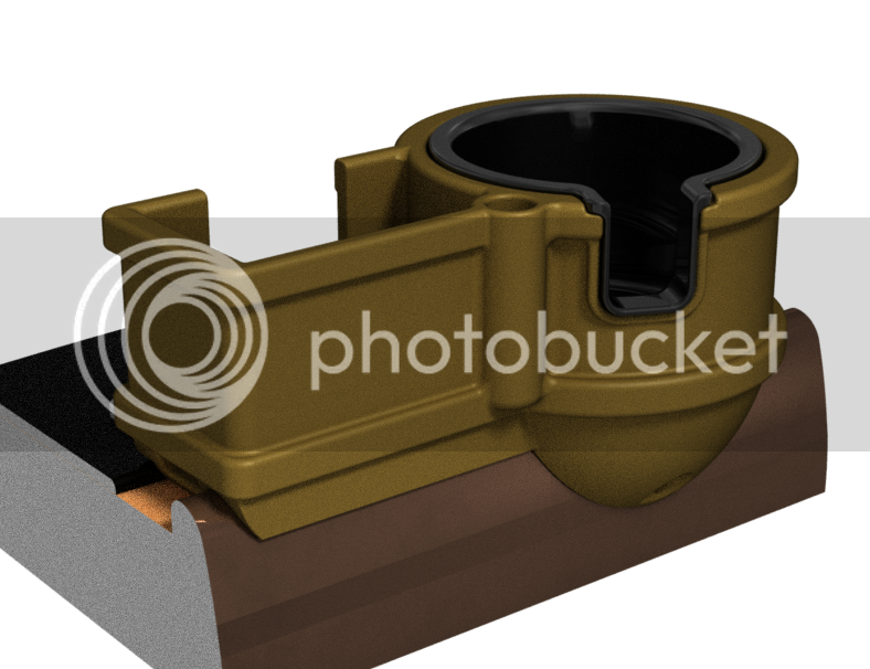

Here's some last touches to the double cup holder. I have been using a digital jig/template to work off of. It's an exact (dimensional) copy of the passenger side of the center console. It allows me to visually look at fitment before I actually do a print. I installed the double cup holder onto it and quicly realized some clearance issues. I had to modify a section to clear enough space for the "pwr" and "2nd" button. I did my best not to mess up the aesthetics too much but still make it all work and function as needed. Hope the changes don't bug you too much.
That's cool! If I didn't have an aluminum dashboard on my console I'd want that setup to get 6 cup holders!

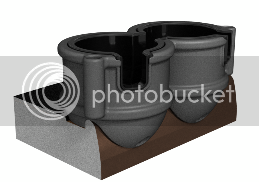

Here's the other design pictured on the console.
Oooh, I like that even better, great ideas here. I had meant about a 1/8 to 1/4 inch wide slot, but I really like the nearly all open side....I need that thing.

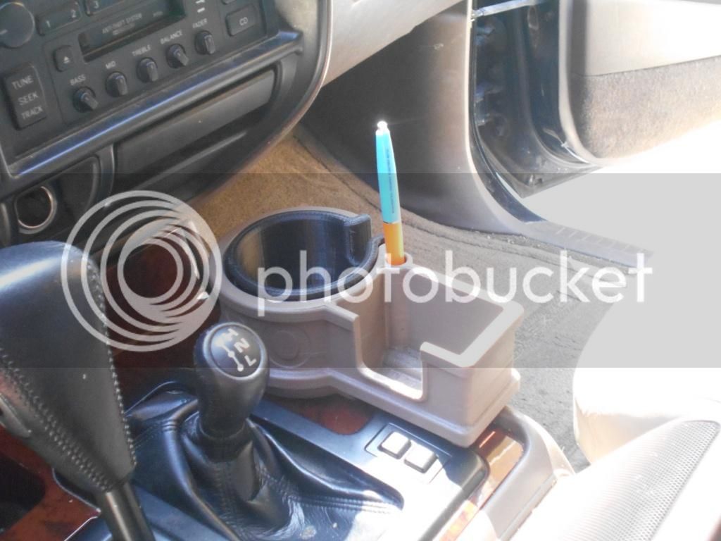

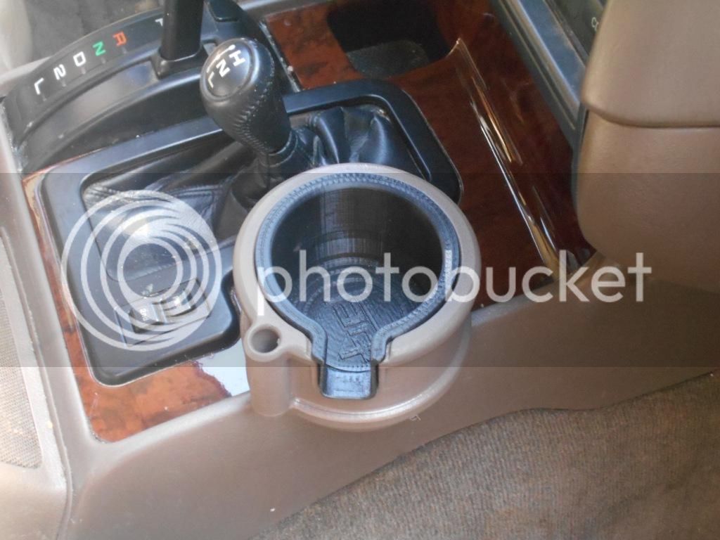

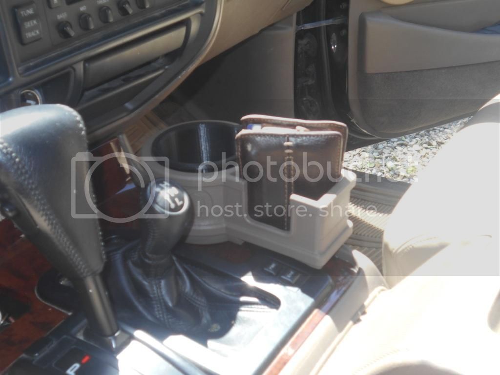

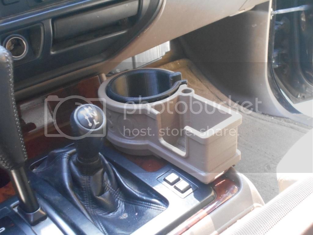

Well I was able to get a couple rough prototypes printed out. What a PITA!!. As I had thought; my machine did not like 17-27 hour prints. I had issues with warping, cracking, and delmanation from the platform. The prints in the pics do have some issues and have zero sanding done. Fitment was close to perfect on both, but needs a couple minor tweaks. I will spend this week working on quicker and better looking prints. Prints this complex take time to perfect. The double cup holder literally killed my machine. My platform heater just wasn't up to the job. I now need to upgrade the heater, insulation in the acrylic box, and some wiring so my machine can handle these super long and complicated prints. I will get there, but I'm going to need a few weeks to get all the upgrades done and dialed in. Here's some pics of the protoypes I have. Please remember that these have zero sanding done and are rather rough. I should be able to get them a LOT cleaner looking as I get my printer up to the task.
