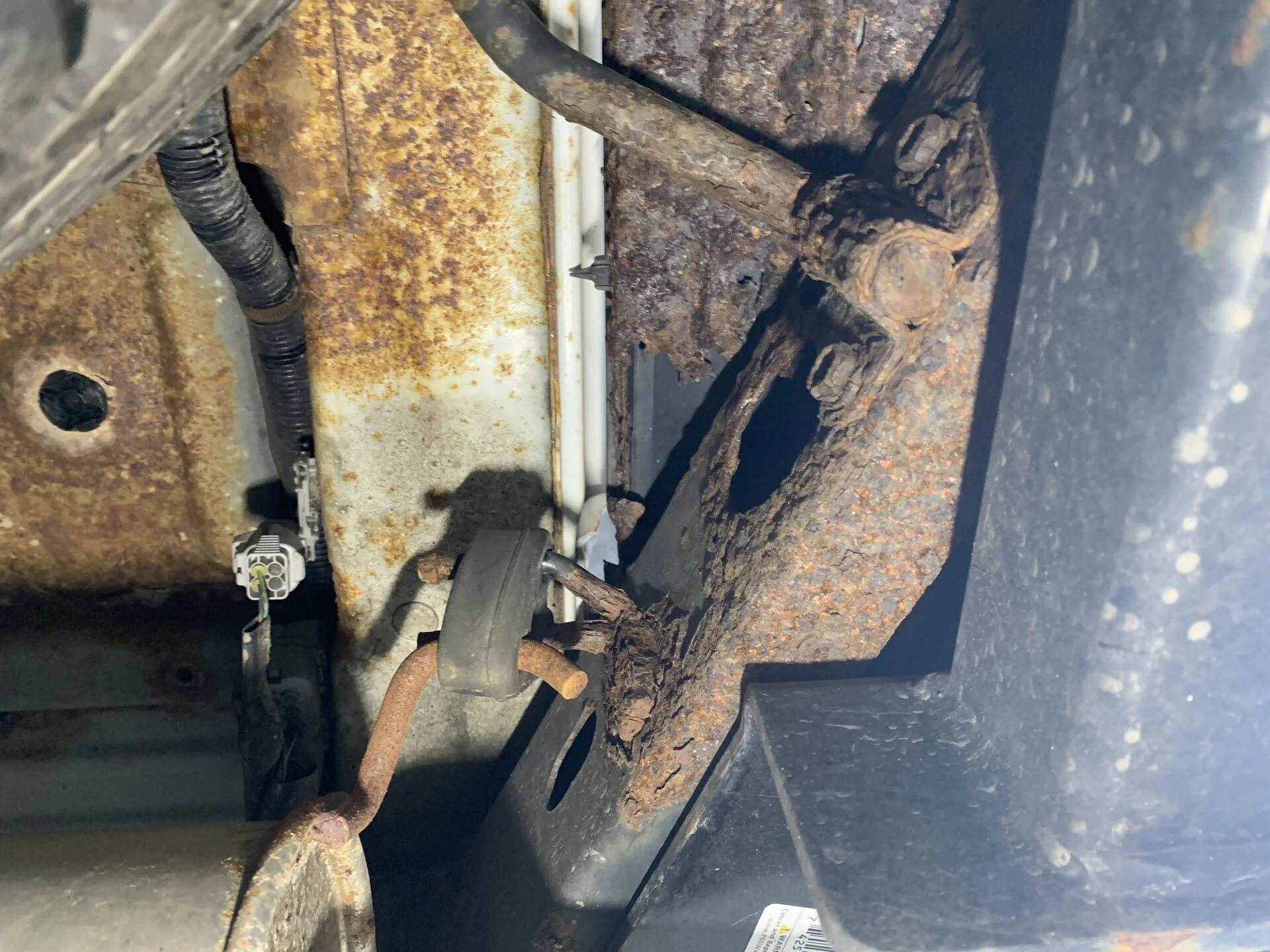

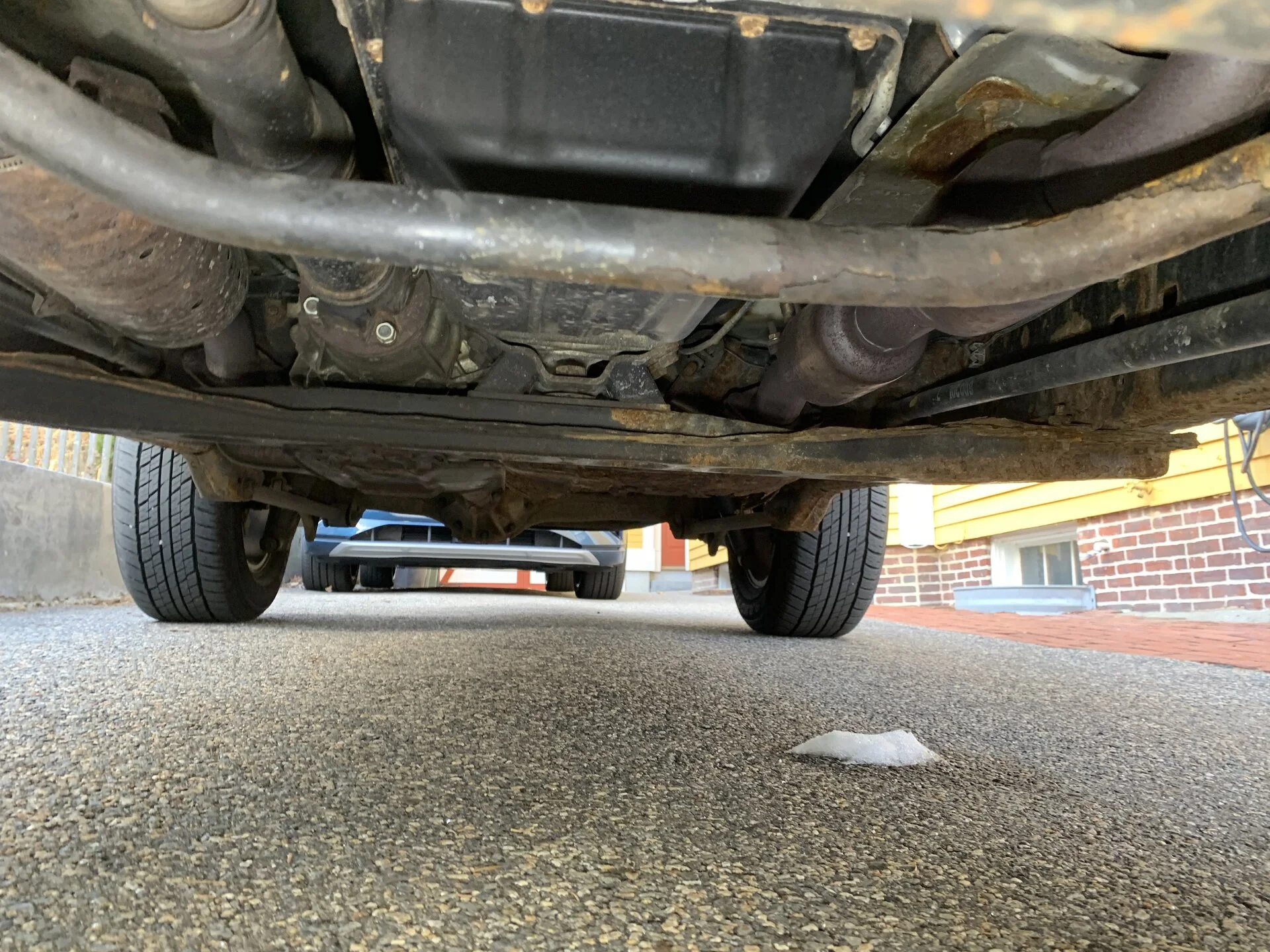

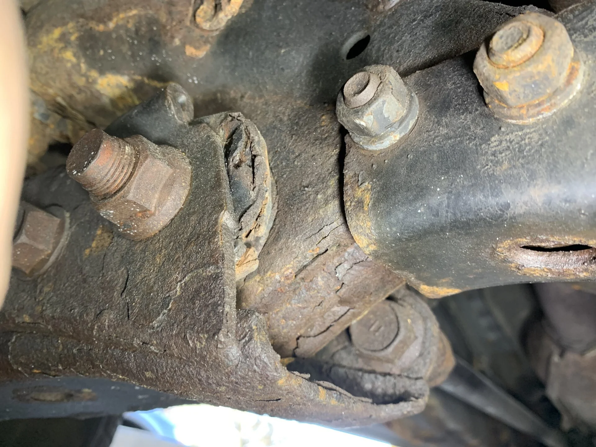

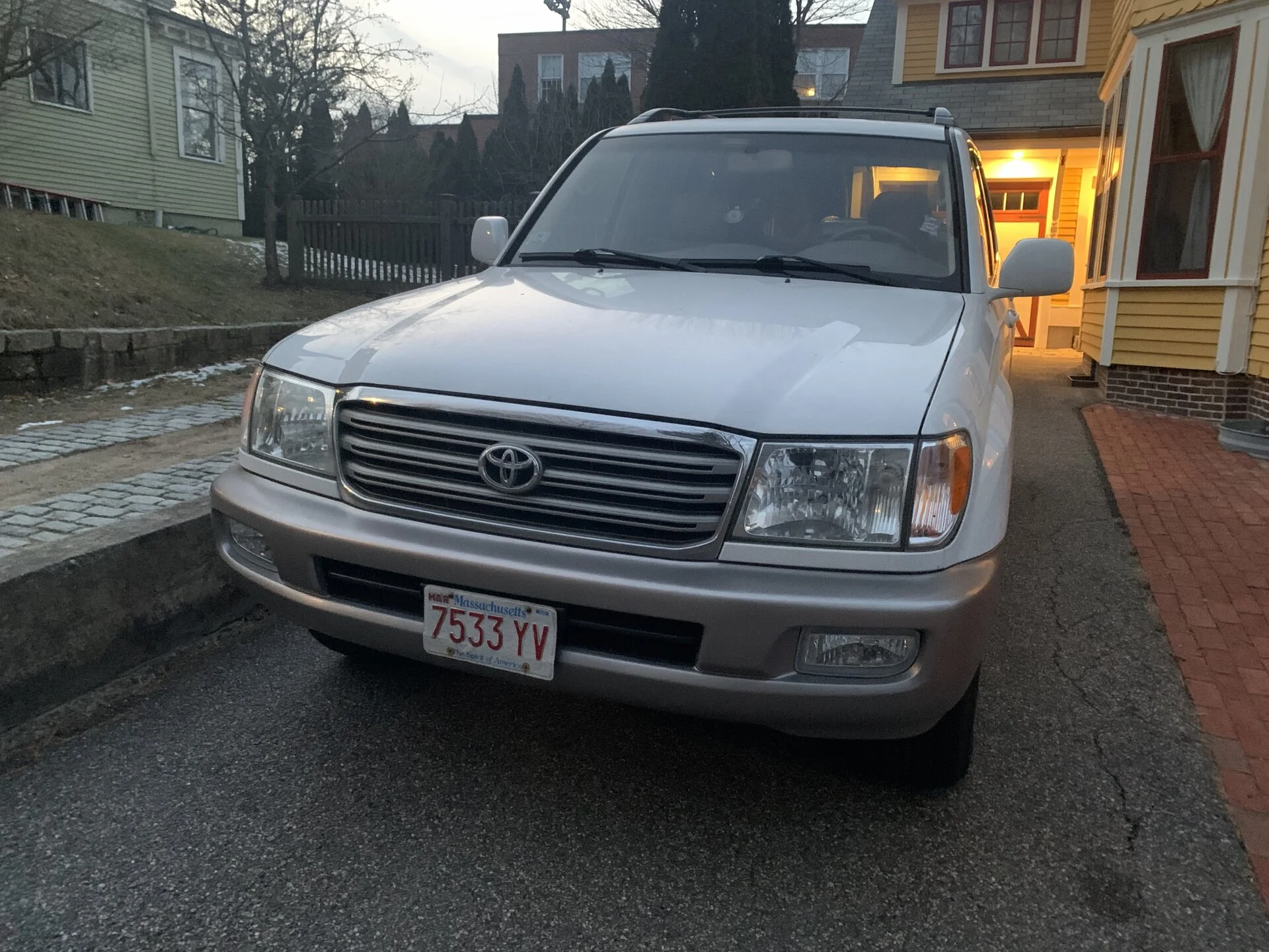

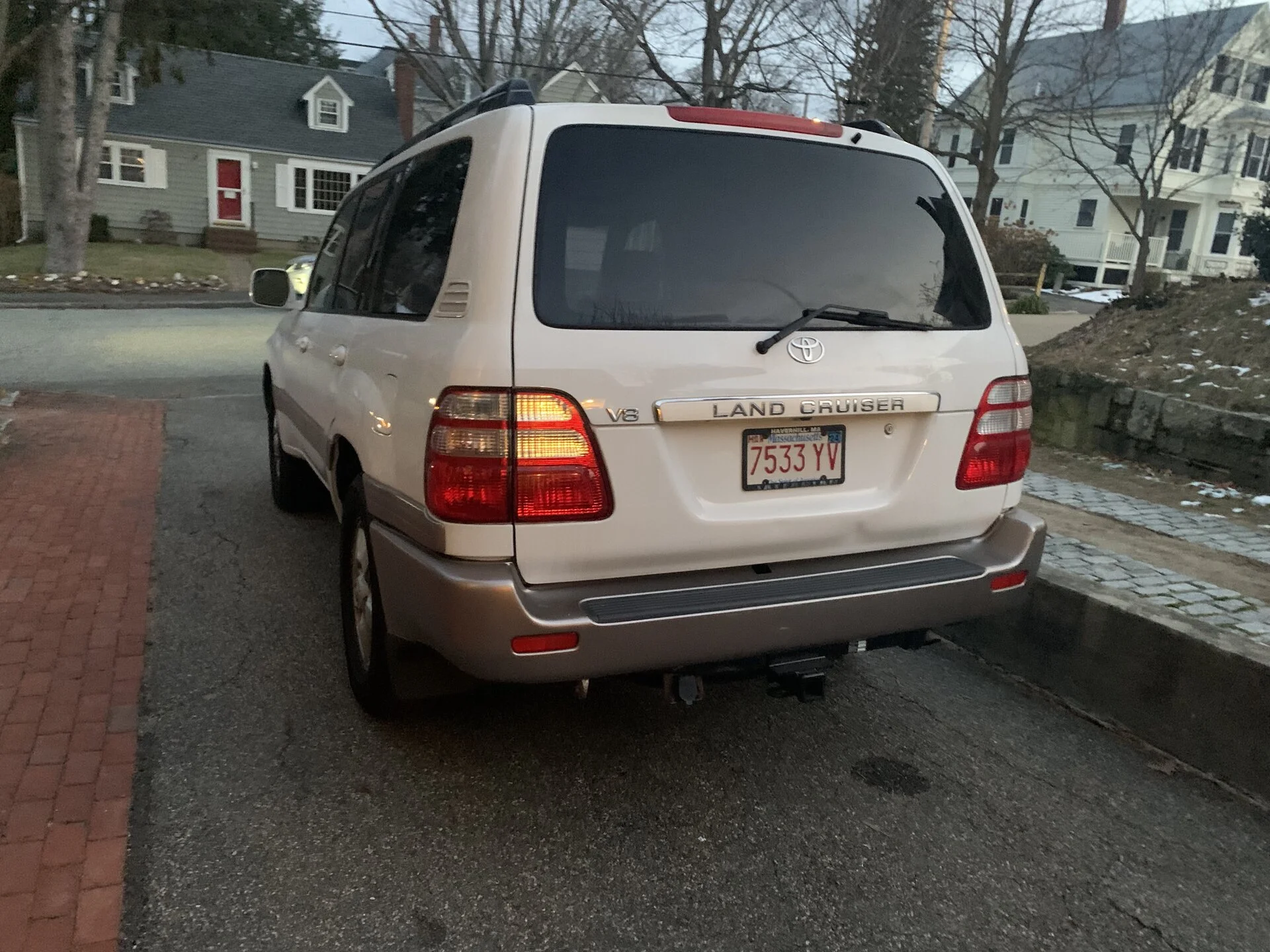

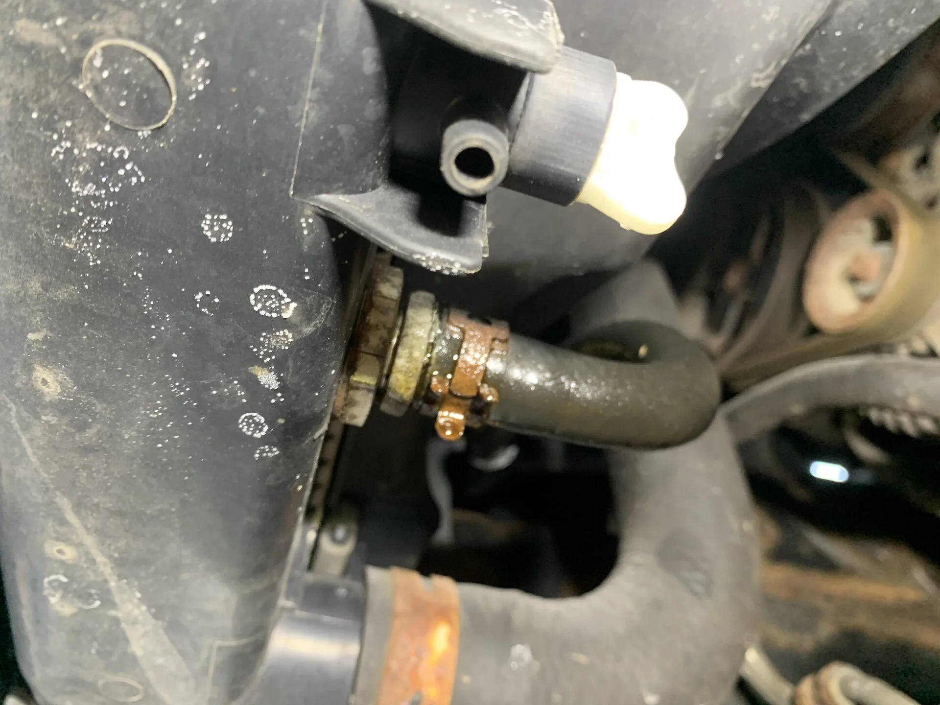

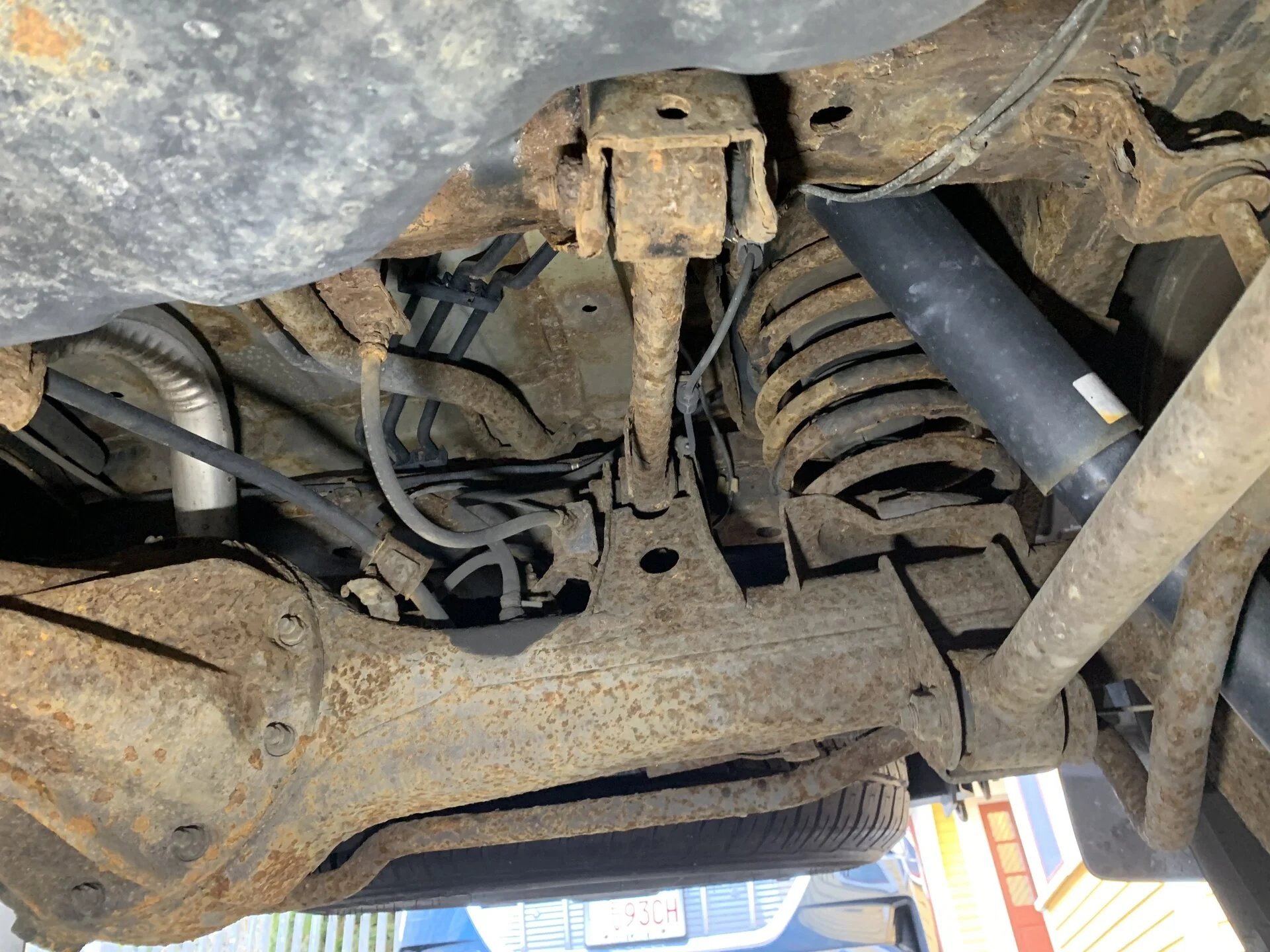

I took the plunge and bought myself a 2004 100-Series LC with 189,000 miles on it. The vehicle has been reasonably well maintained mechanically, but has lived its entire life in New England and was a daily driver for the previous owner. Aside from typical New England rust, the vehicle was used to launch a saltwater boat, so the rear end got a good dip in the ocean twice yearly. It has its strengths and weaknesses. Fortunately, I have 21 pages of service records on the vehicle going back to 2009 and have been able to go through them and see what has been done. The car received a fresh exterior paint job (meaning it wasn't fully stripped, just masked and painted) about 14 months ago, along with new bumpers and fog lights. I've been reading forums and have previous mechanical experience, but mostly with '70s vehicles (my current daily is a '74 VW bus, but I needed something for NE winters), so I'm eager to dive in and fix it up but I'm afraid of all the computers and the significantly greater complexity of nearly every system.
As far as maintenance, its timing belt was changed about 30,000 miles ago, so I'm all good there. Ithink the heater T's need to be replaced, 1 appears to be leaking and I think they're original to the car. The brakes have been replaced recently. The paint job was done by an iffy shop, so some trim was broken and others are missing entirely, so I am curious to hear recommendations for online parts stores. I currently have the check engine light, "RSCA OFF" and "VSC TRAC" lights on in the dash, but I have an OBD2 reader on its way. (If anyone knows a common cause of this mix of lights, please let me know though). Oil was changed fairly regularly along with fresh tires in 2019. I'm aware that far and away, the biggest issue is the rust plaguing the bottom of the vehicle. I've attached photos below. Like I said, the previous owner maintained the vehicle mechanically, so any rust on mechanical components is surface only as far as I can see. Since I'm headed into a long and cold New England winter, I'm planning on coating the underside in cavity wax to get me through the snow and road salt season and I'll address the rust more in the warmer weather.
One piece I desperately need to replace is the pannel that sits under the gas tank and protects it from rust. Mine is about 80% gone. If that is sold aftermarket, please let me know where I could find one, and if its not, I'll start searching the scrapyard. Additional missing/broken pieces are the third brakelight, side windshield screw trim and most plastic covers for the roof rack.
Really all of this is just to get everyone up to speed on where I'm at so I can ask the question of what should I replace/look out for? I've gone through a lot of the "new car" forums already, but I thought I'd post some photos of mine (including a radiator hose leak) so people can offer some advice since I'm pretty new to cars made in the last 30 years.

- Dry and cracked rubber bushings in suspension

Welcome! I too am a new owner in New England with an 04, so happy to read through your intro thread. While a little rusty, that undercarriage doesn't look bad at all IMO. Definitely Fluid Film it and stay on top of any areas that get worse, but that looks very clean for the age and location.

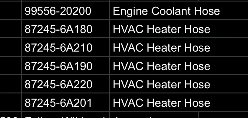

Heres the part numbers for the hoses that connect to the heater t’s. Makes the job ALOT easier. Replace the t’s asap if not replaced

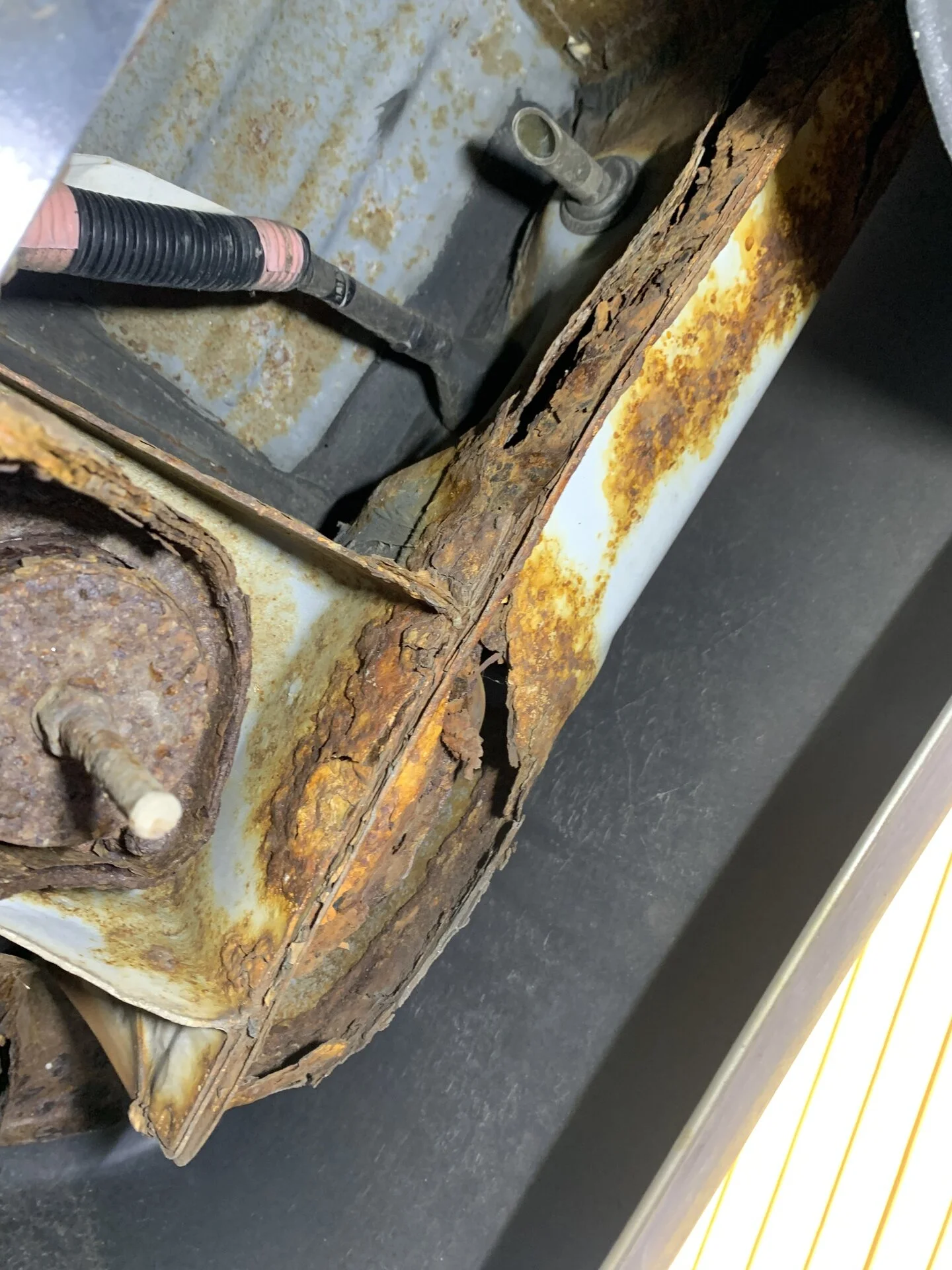

I would highly recommend you spray from fluid film at the bottom of the upper hatch before it rusts out. That is a problem area.
The leaky hose you show in the picture is a transmission fluid line that runs from the radiator to the transmission cooler just behind the grille.

Thank you for all the input guys! I was confused about why the fluid drip looked greenish, and there is a little viewport in front of the rad that shows green fluid. I know the coolant is pink, should the trans fluid be green? I was under the understanding that ATF was always red, but up to this point, all my mechanic experience is with manuals.

Wild to see the front is really not all that bad and just gets worse and worse closer to the back end from that salt water.

  • Transmission fluid should be red and not look burnt
  • Coolant should be pink / red but sometimes people use the green
  • The window in front of radiator you mentioned I believe has to do with your air conditioner not coolant

  • That exhaust mount looks like it's ready to drop, I'd want to address that

And as far as the rust, I'm planning on hitting a lot of it with a wire wheel to take off any scale and see what the metal is really like under it. The exhaust hanger looks more bent than it really is in that photo, but definitely something I'm keeping an eye on. Also, I'm assuming fluid film would just burn off of my engine block, so what should I do there to address rust? If anyone has any advice on rust repair with these 100 series, let me know. Currently, my plan is as follows;

Oh and that dent in the lower tail gate is from someone backing into the tongue of the boat trailer!

And I don't doubt that a boat trailer could have made that dent! 😂
