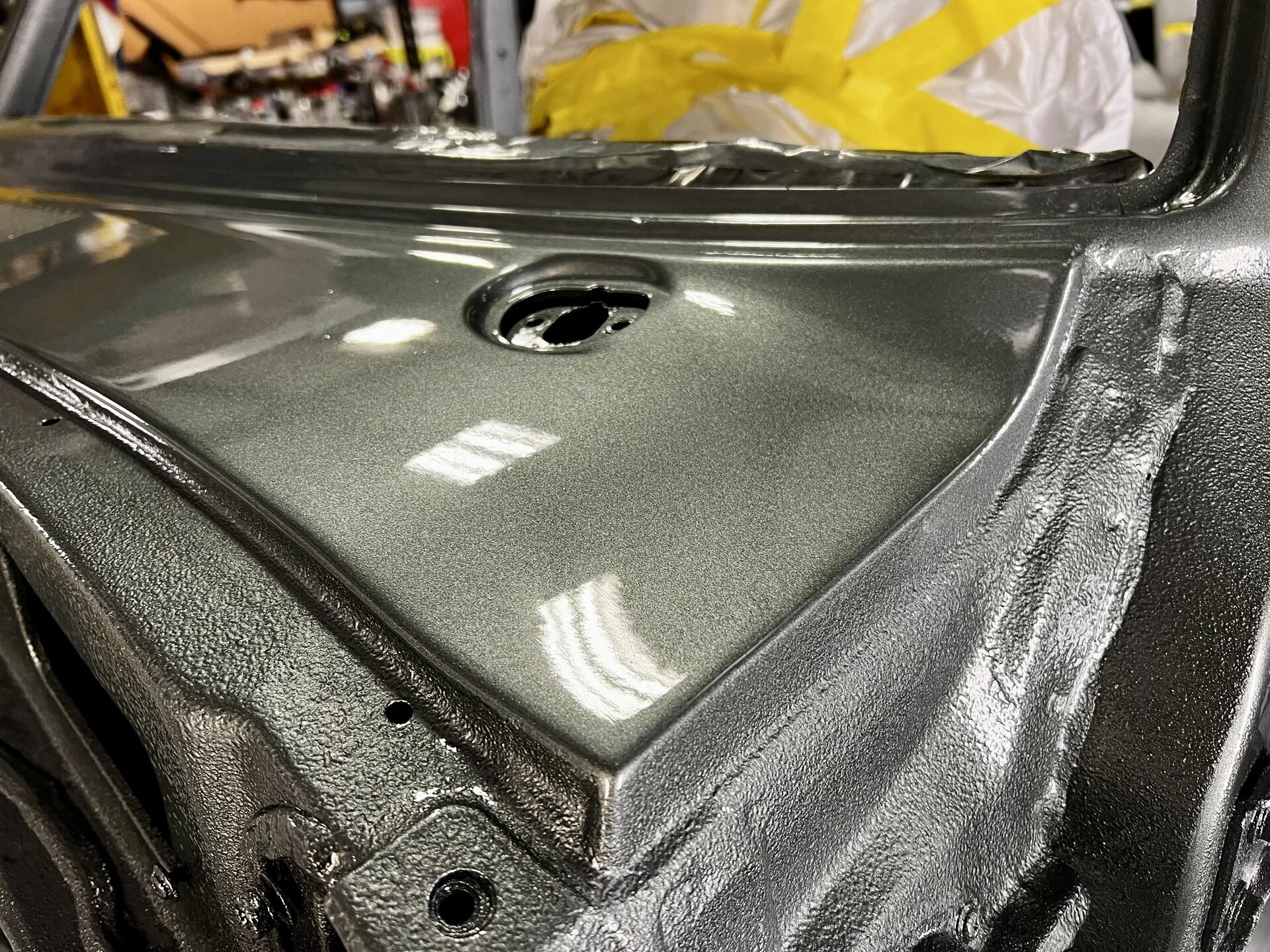

Clarity hard to capture with my phone camera. But the silver flakes in the paint are amazing. Depending on the light, it can look like a glossy silver metallic green or an almost greenish-grey frost. Paint color was the 2nd hardest decision. . .wheels officially captured 1st place!

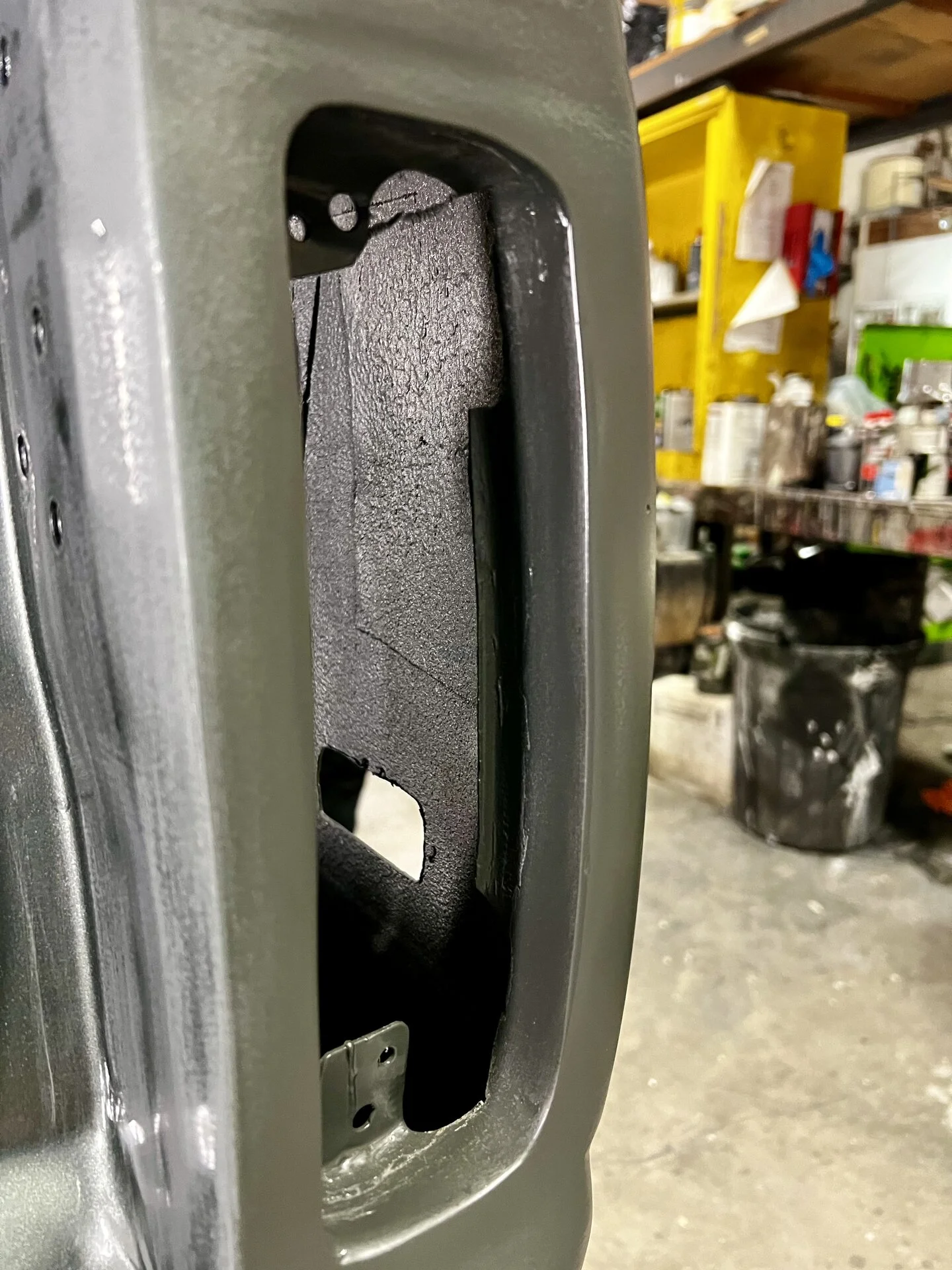

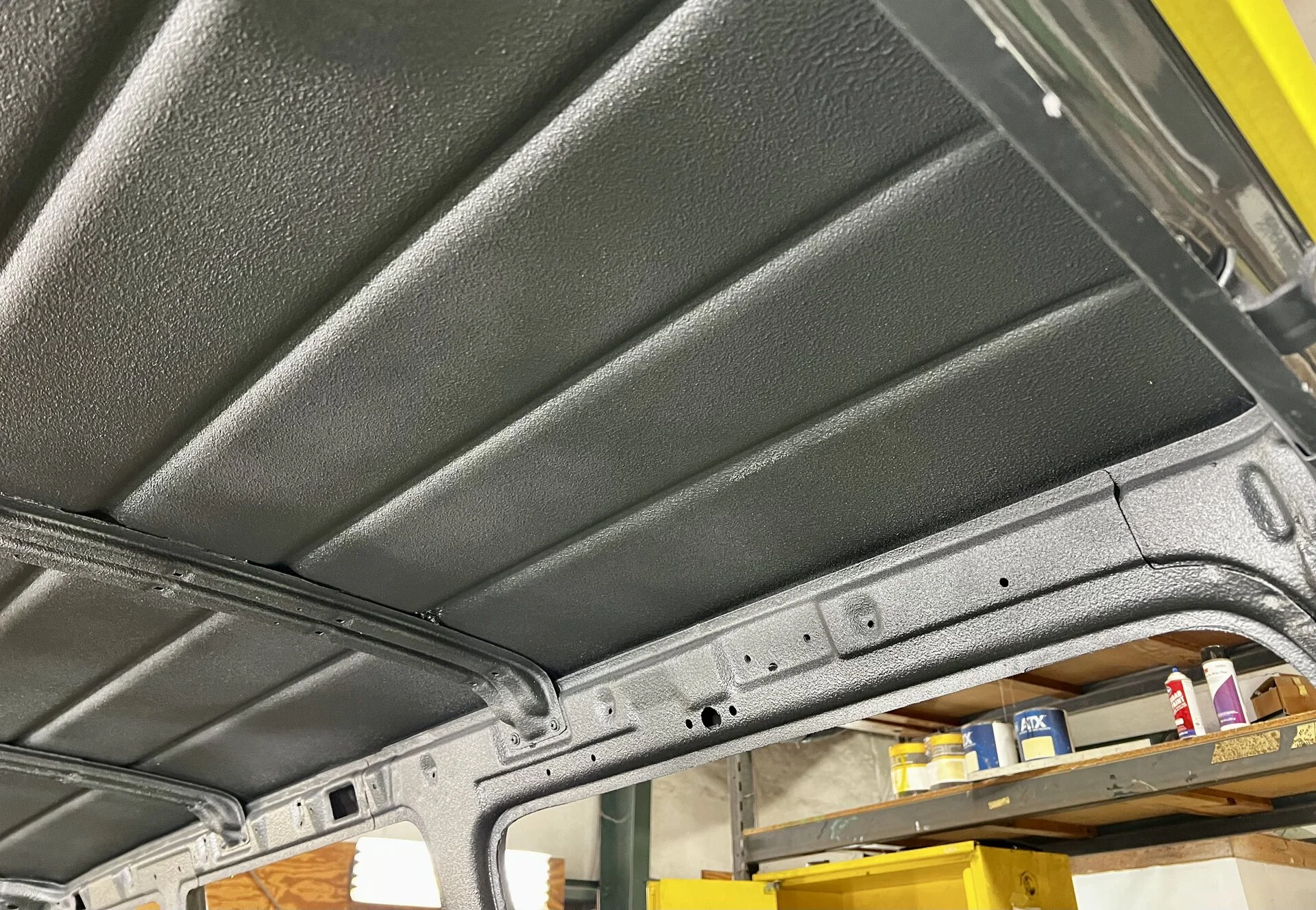

View attachment 3459265View attachment 3459266View attachment 3459267View attachment 3459268View attachment 3459269

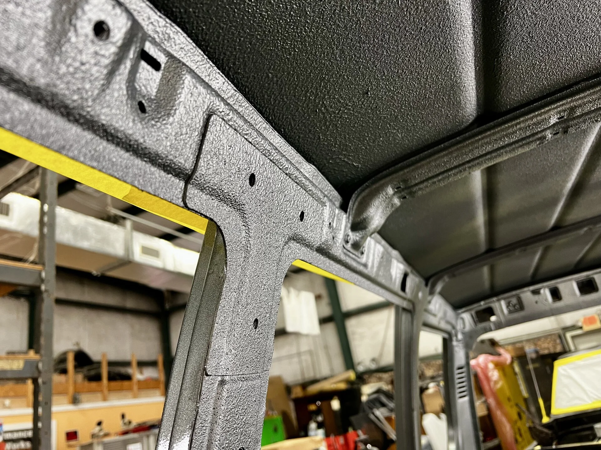

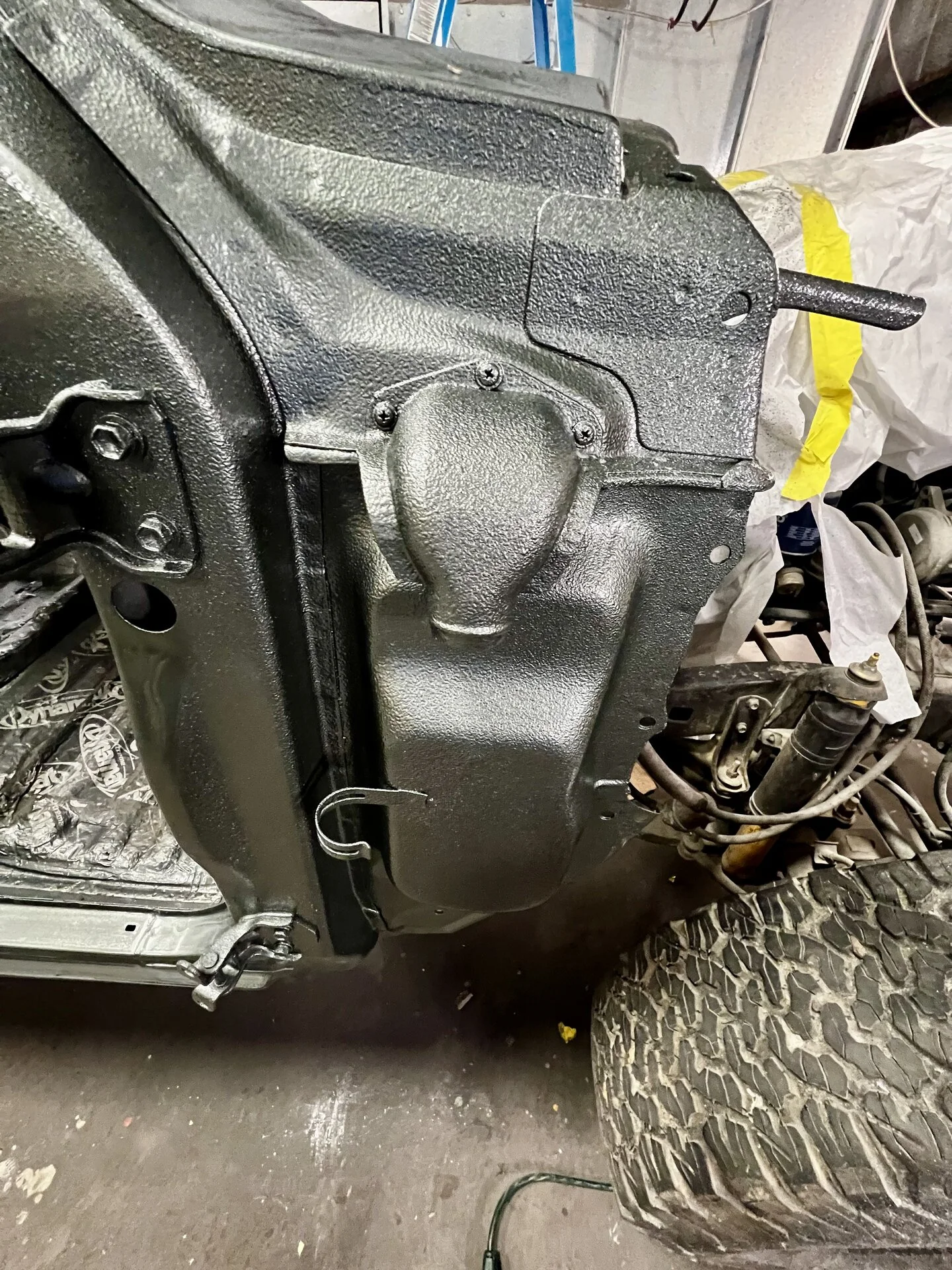

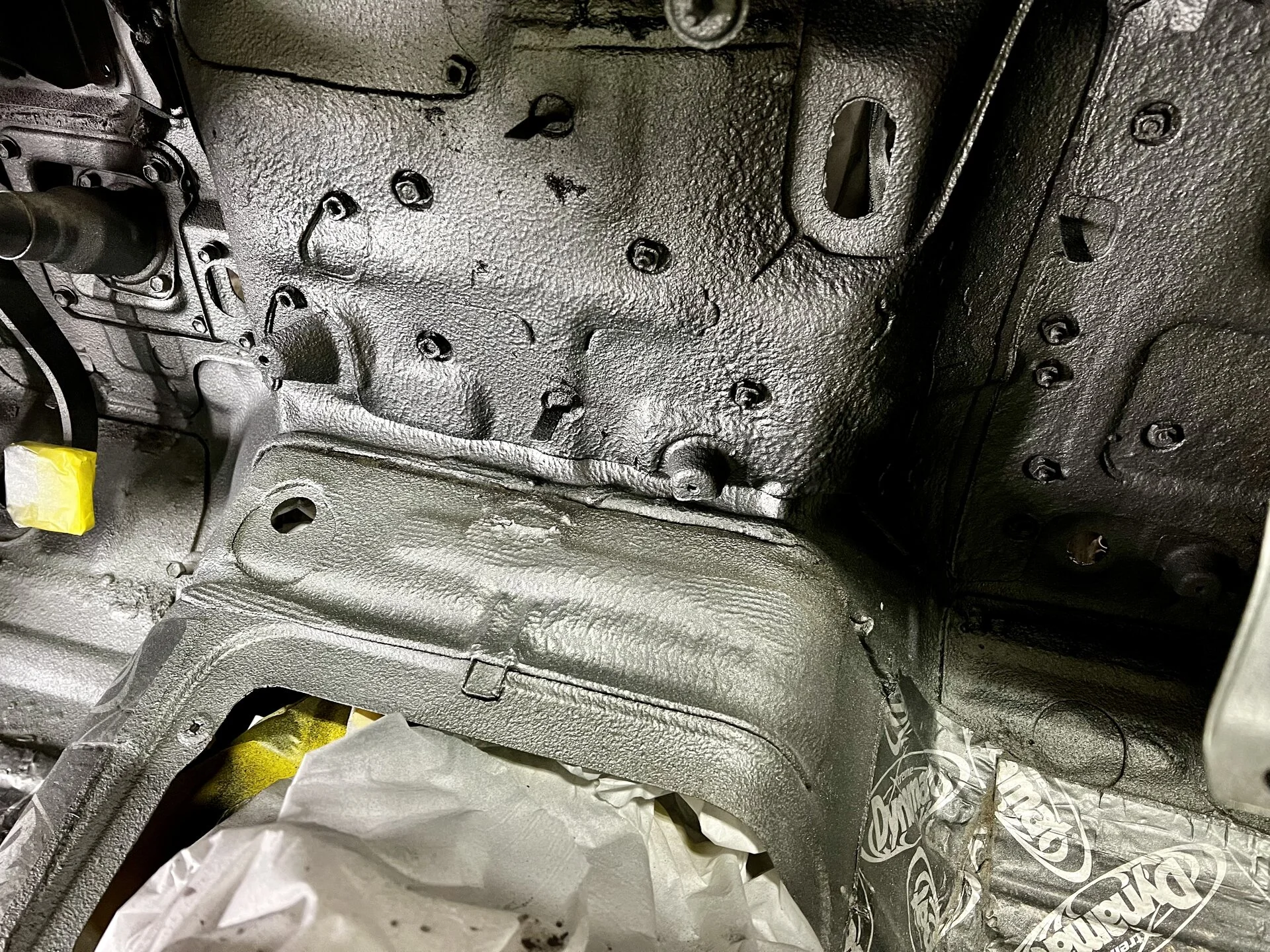

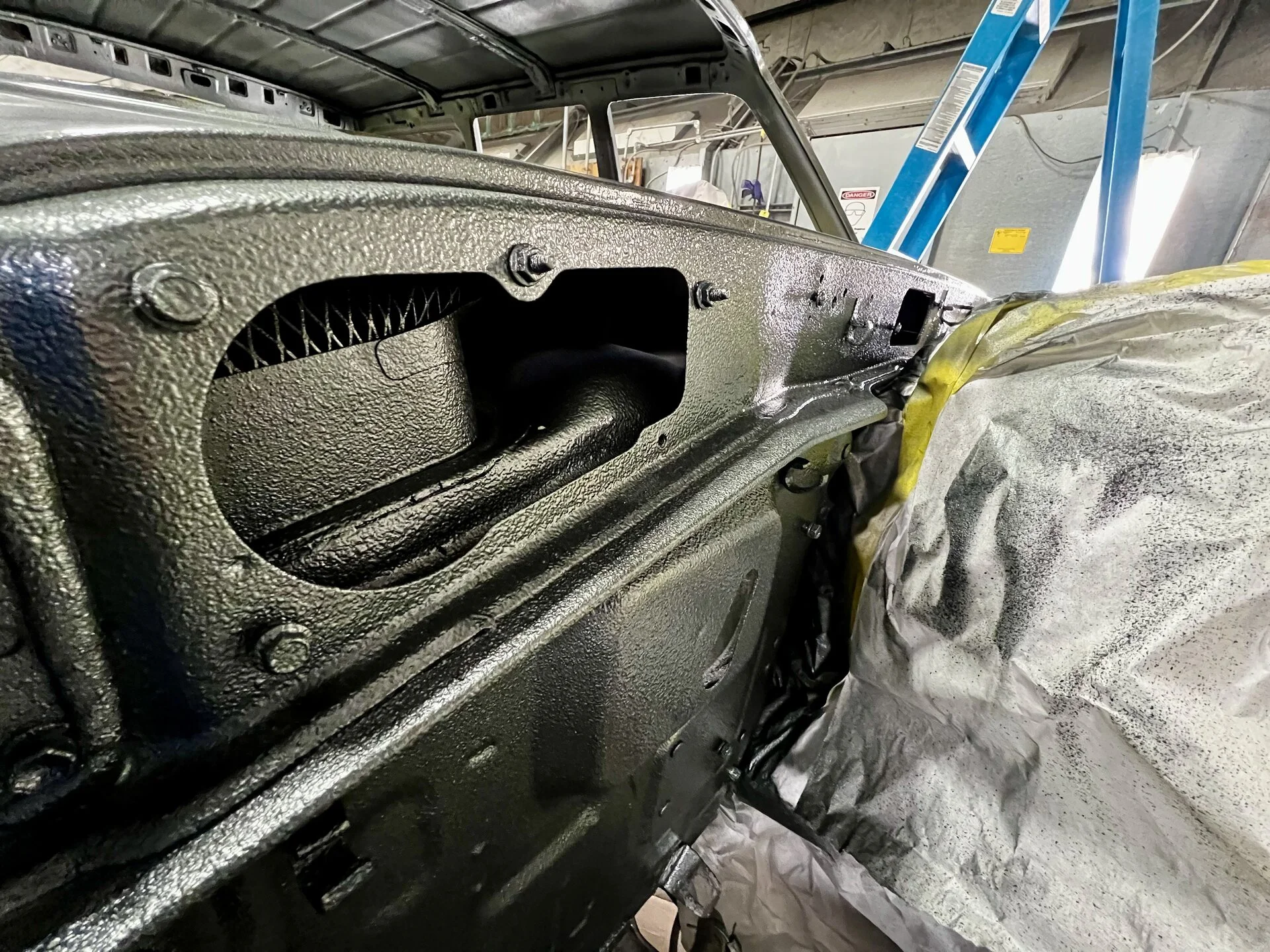

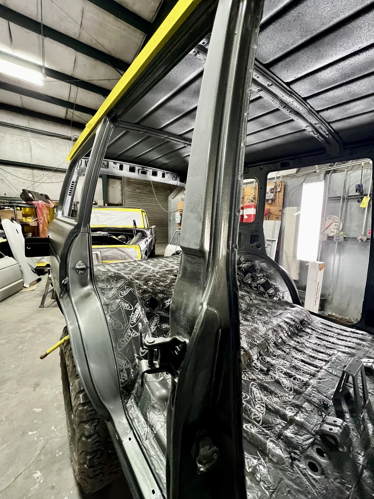

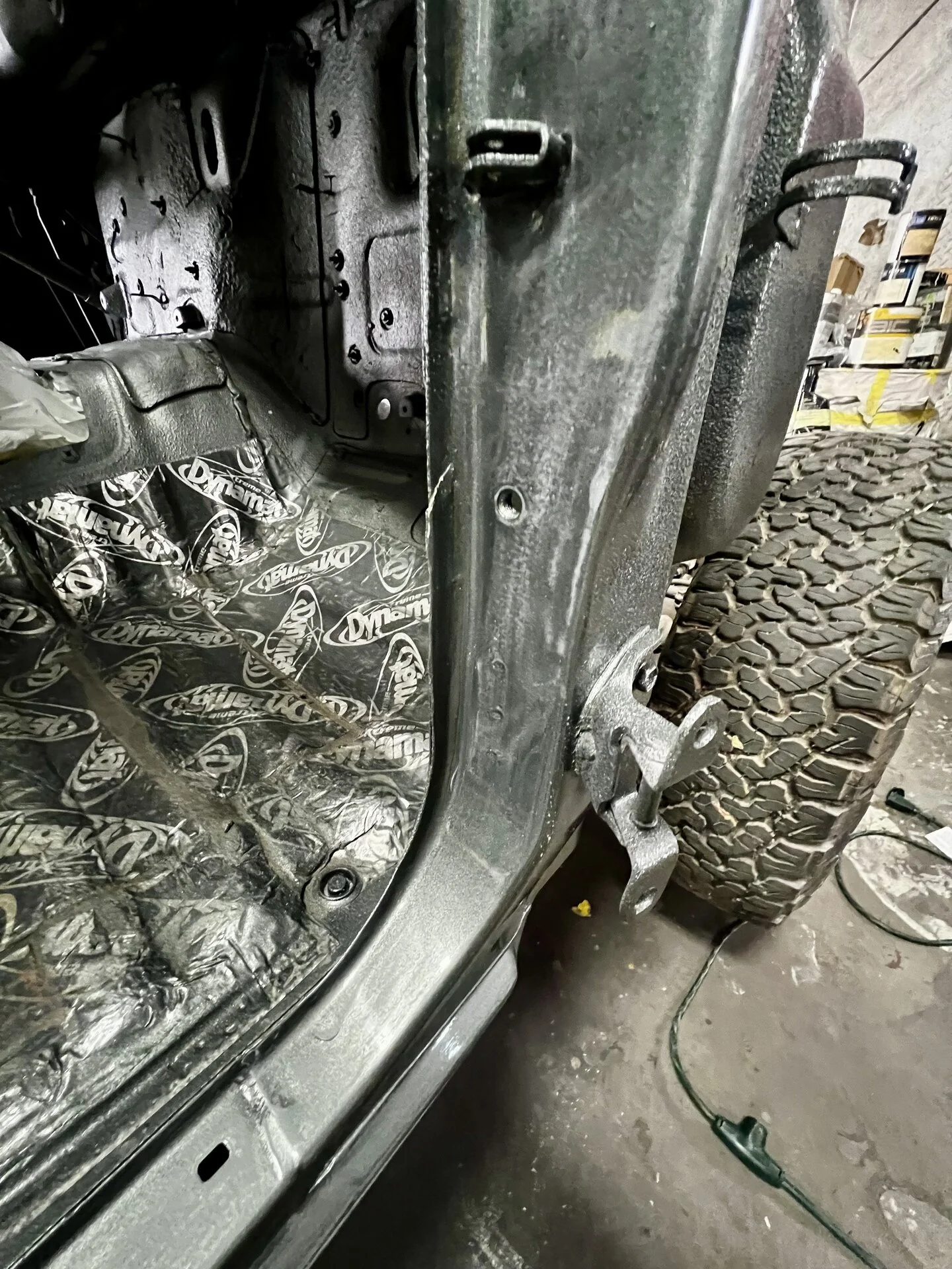

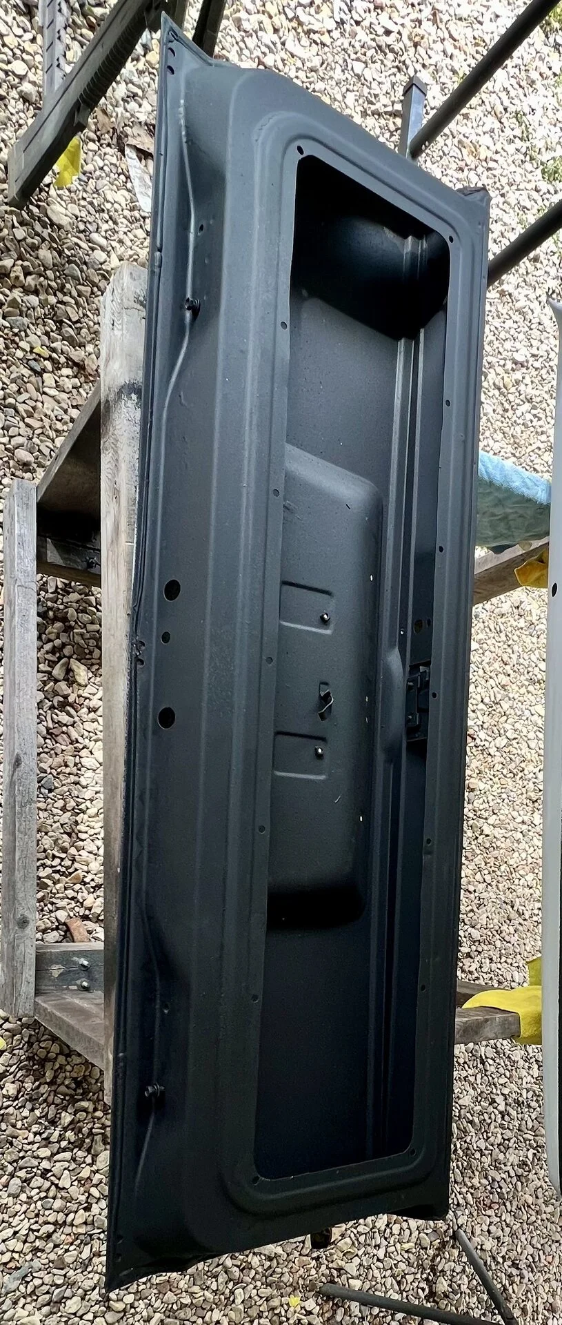

Is this a sound deadener spray on coating? if so what is the brand and how did you like it?

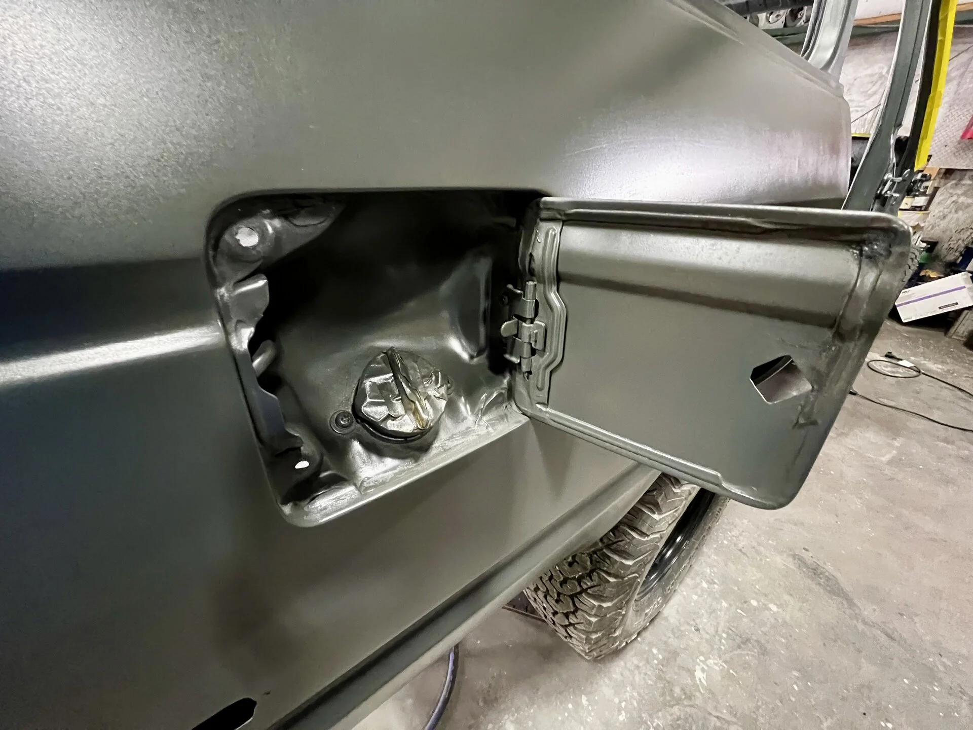

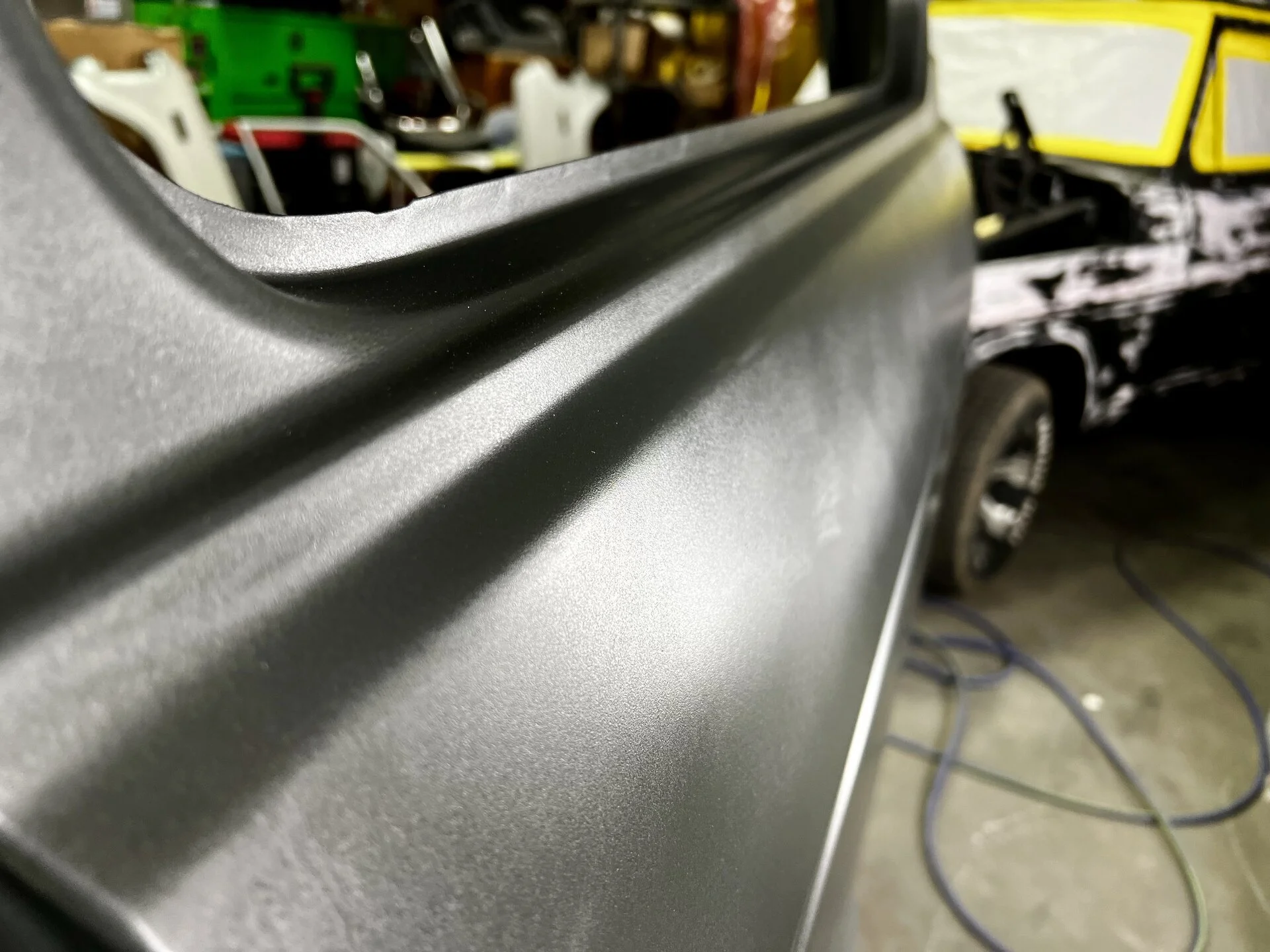

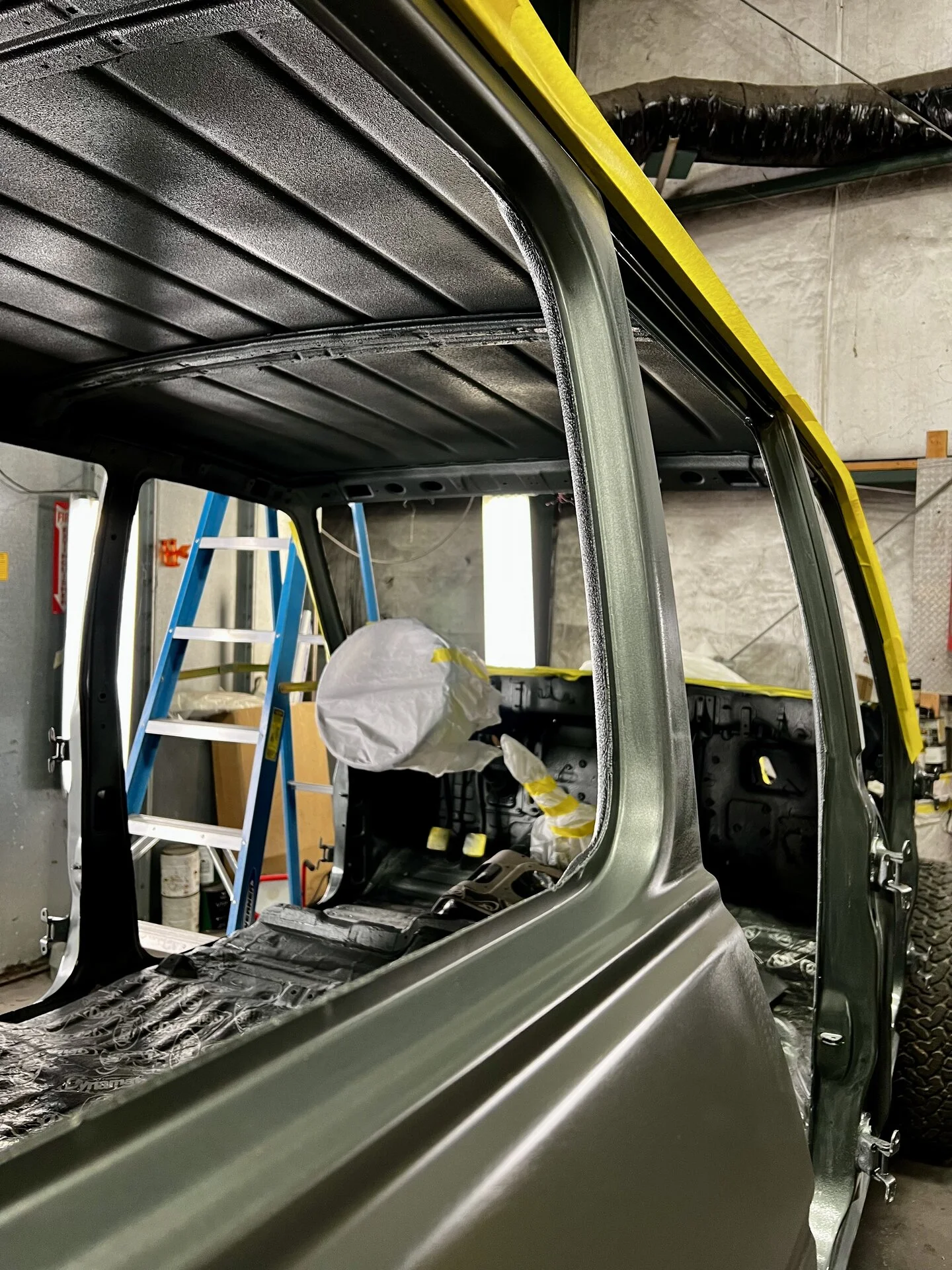

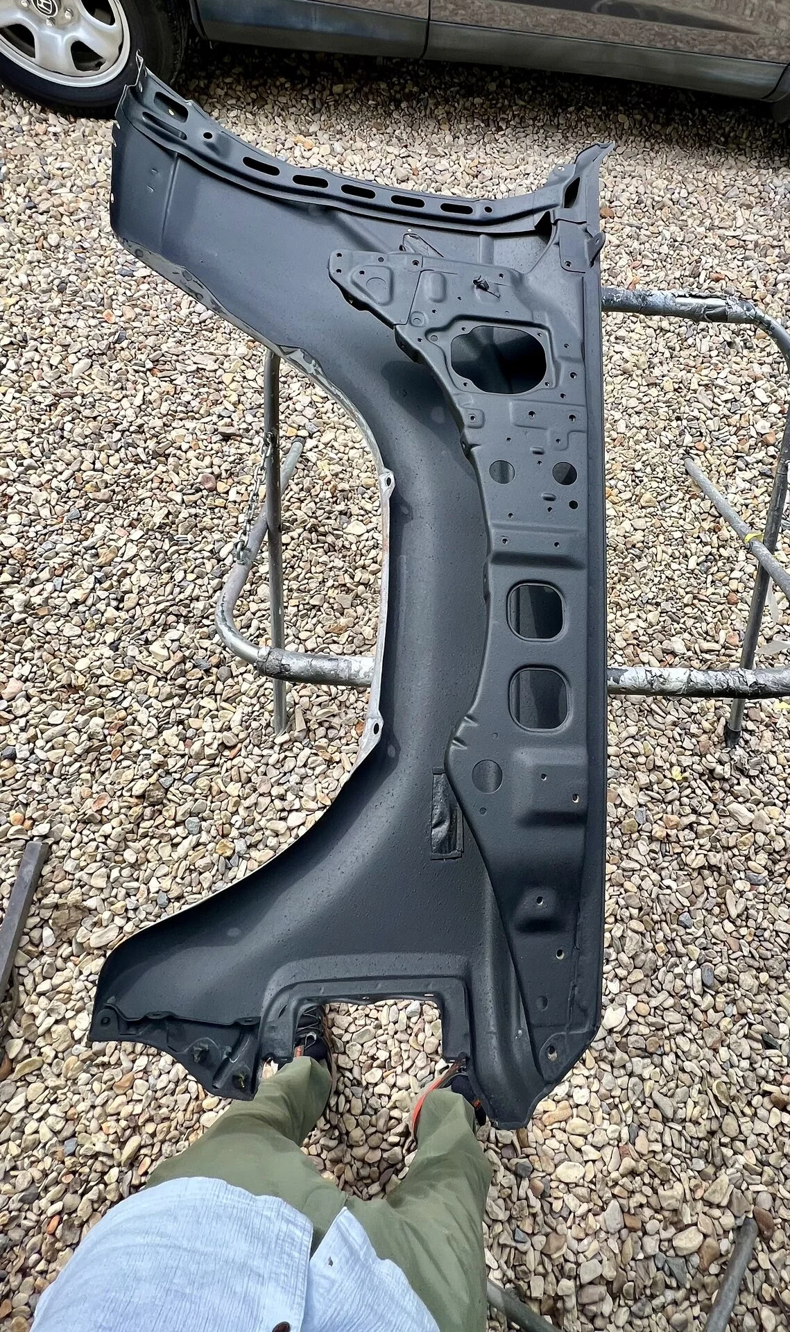

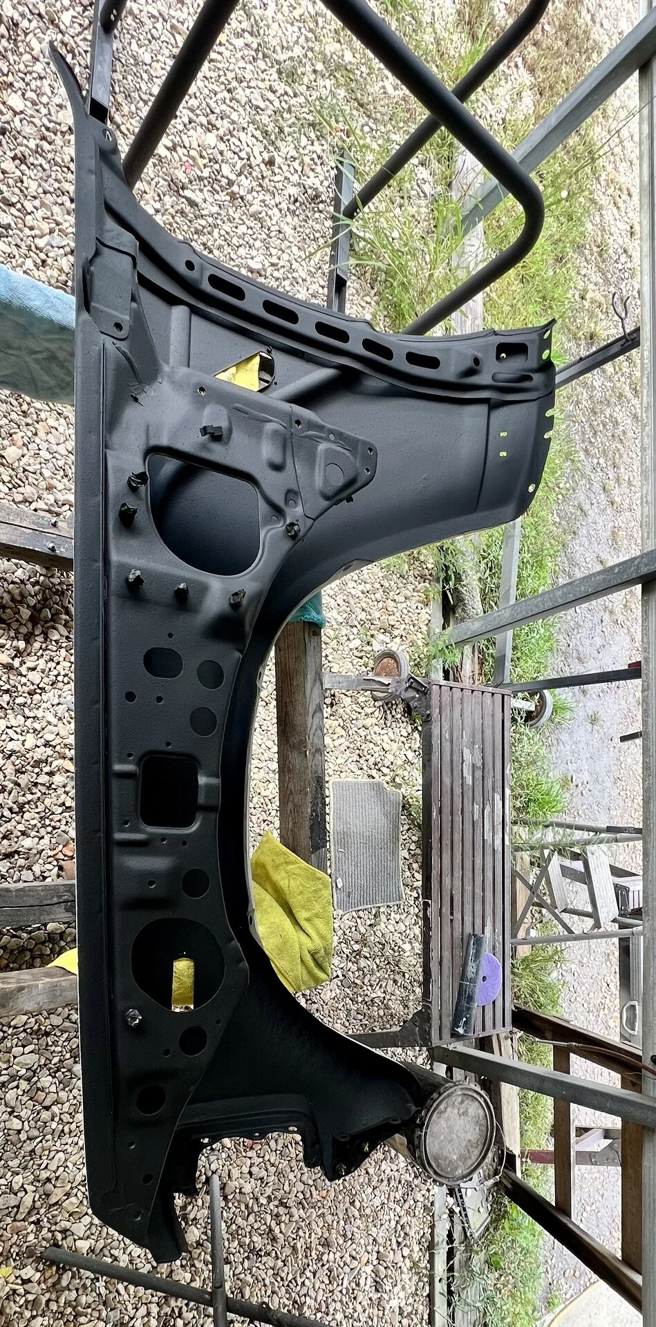

I used a combination of Second Skin (Spectrum) and Lizard Skin (Sound Control & Heat Protection) for sound/heat insulation, 3 products total. I made that choice based on prior experience and numerous builds utilizing the same products. Sprayed 3 coats per spec to every interior panel, under hood, upper/lower tailgate, firewall, and inner fenders; J's doing the underbody when it gets to his shop.
The difference? It's a massive. . .MASSIVE change in perceived harmonics, literally taking you from a tin can Yugo to a Lexus sound quality, or damn near it! The dynamat made a big difference - just put on way too early in my initial rebuild approach (lesson learned). Thankfully, I prepped the area (POR-15) before applying. Purely aesthetics - putting down a layer of Restomod Air's sound deadening after the paint booth. Adding Cascade Audio for roof sound/heat and their door gasket material as well.

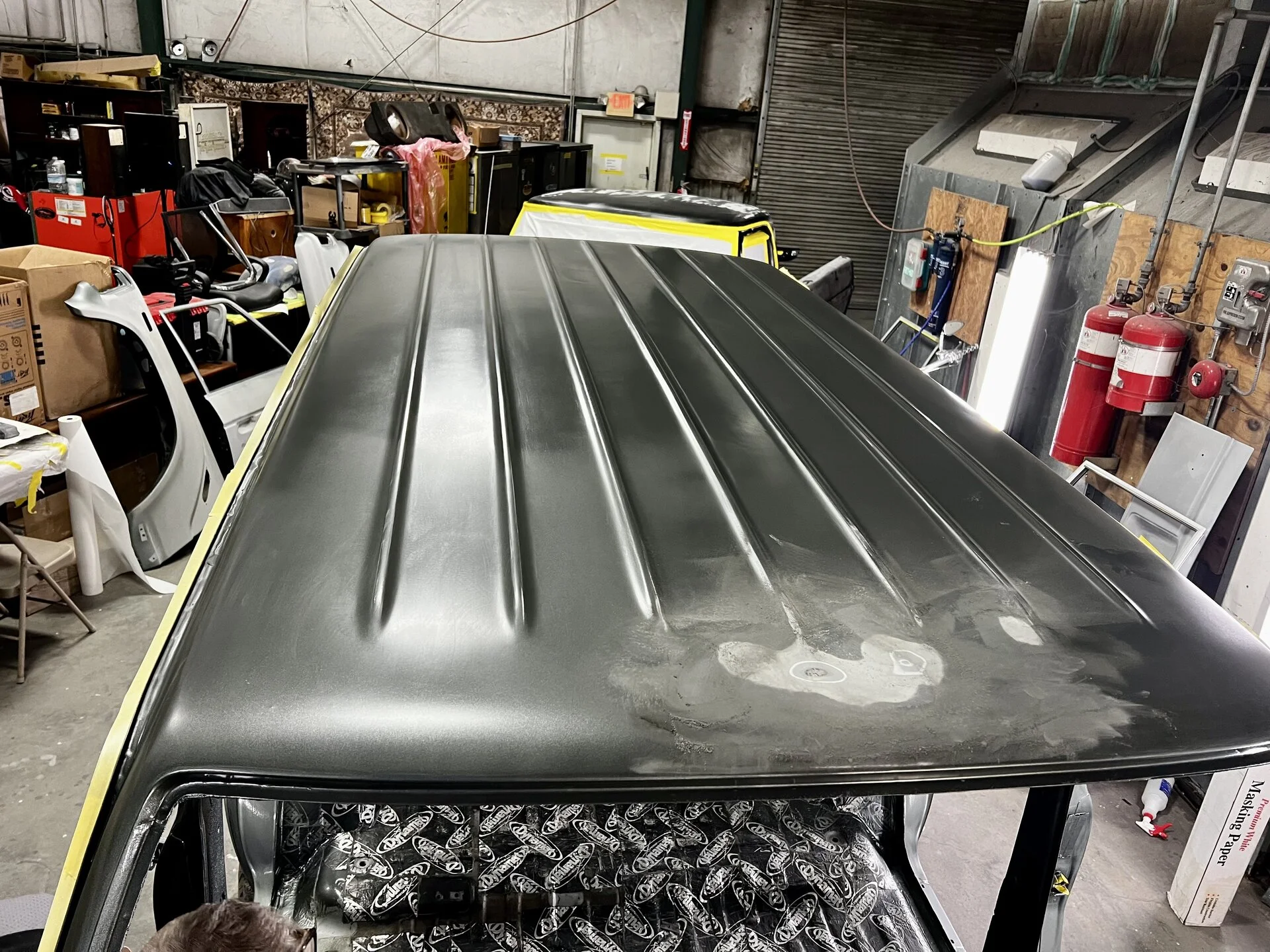

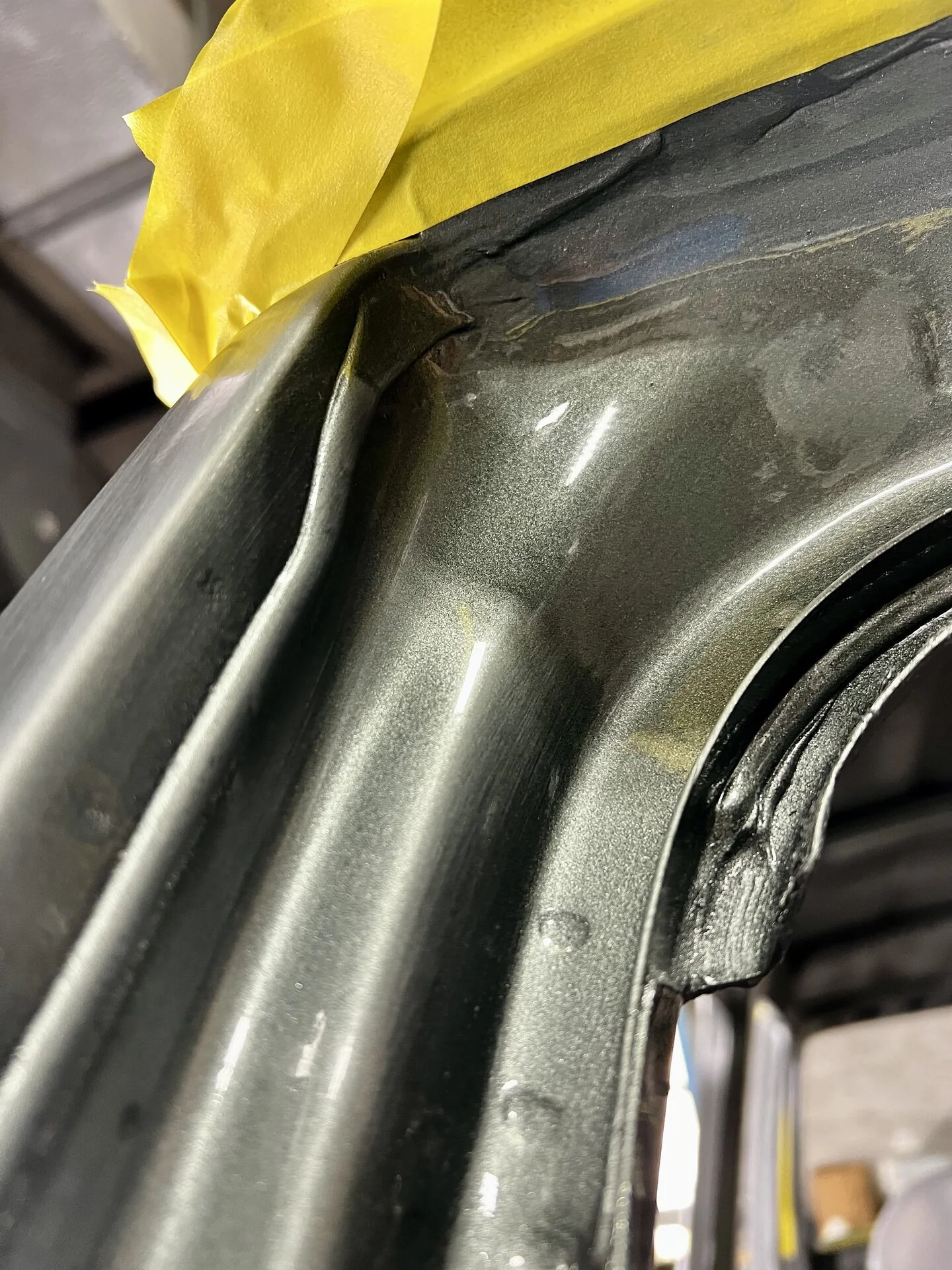

More body pics. Flow coating, wet sanding and correction in the roof:

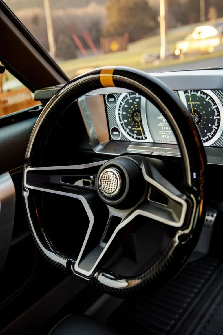

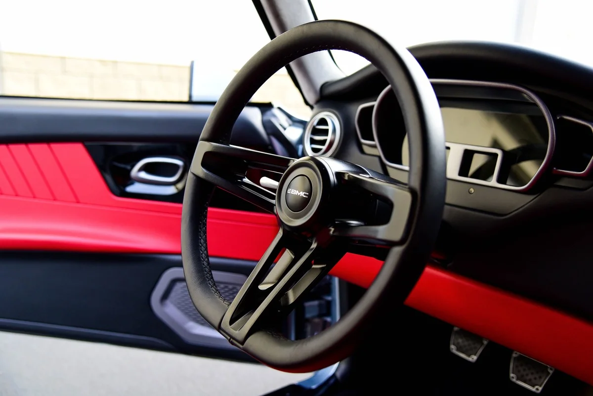

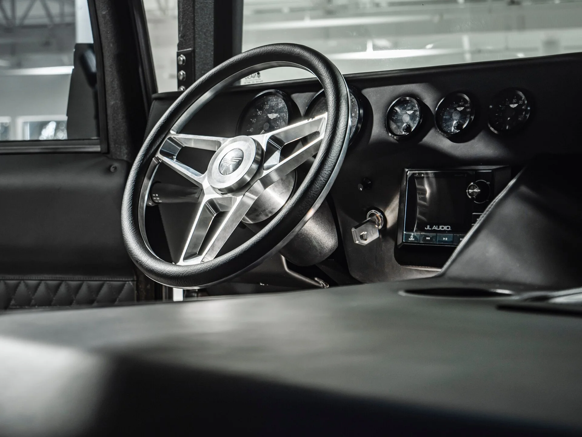

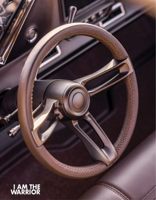

Next up, steering wheel. . .Sparc Industries, Ring Brothers, Billet Specialties, Forever Sharp.
anodized bronze, black leather or carbon wrap, set on a Ididit column.
Sparc's Triple Crown:
