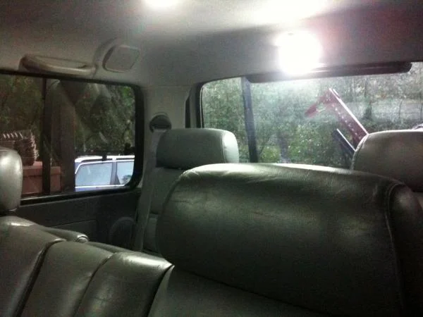

There should be a few threads on here about adding the same light which is over the 2nd row to the rear...I did this a number of years ago, with the light triggered with the 2nd row. Also installed a set of door lights to the hatch. Happy to show you in person as we are in the same county.

The LX has the hard shell headliner, correct? It should be pretty easy to fish two wires from the dome light forward (above the second row). Just remove the second row light and fish the wires back.

id say putting the light on the hatch is best vs. in the cargo area.

I agree that the light on the lift gate gives you more light. I'm still debating if I want to do that. I like the idea of it but don't like that it isn't "factory".

@LS1FJ40 No worries, thanks for the help! I think i'll try the lift gate, My truck is already monstalined so I've already ruined my factory look lol

Just upgrading the interior lights to LED's gave me more than enough light inside the cargo area. :meh:
