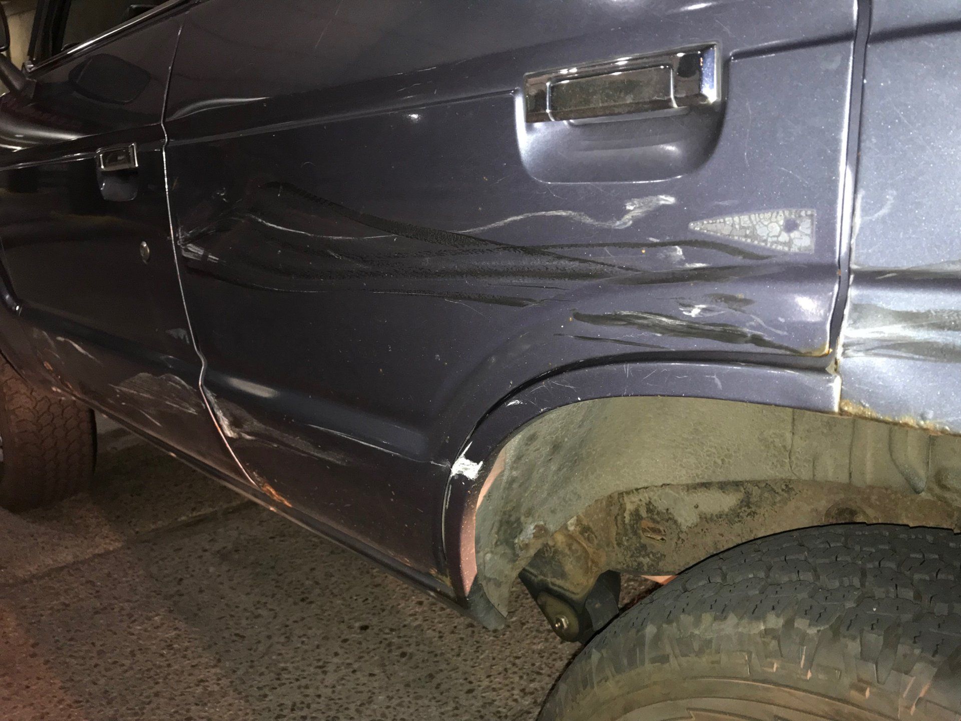

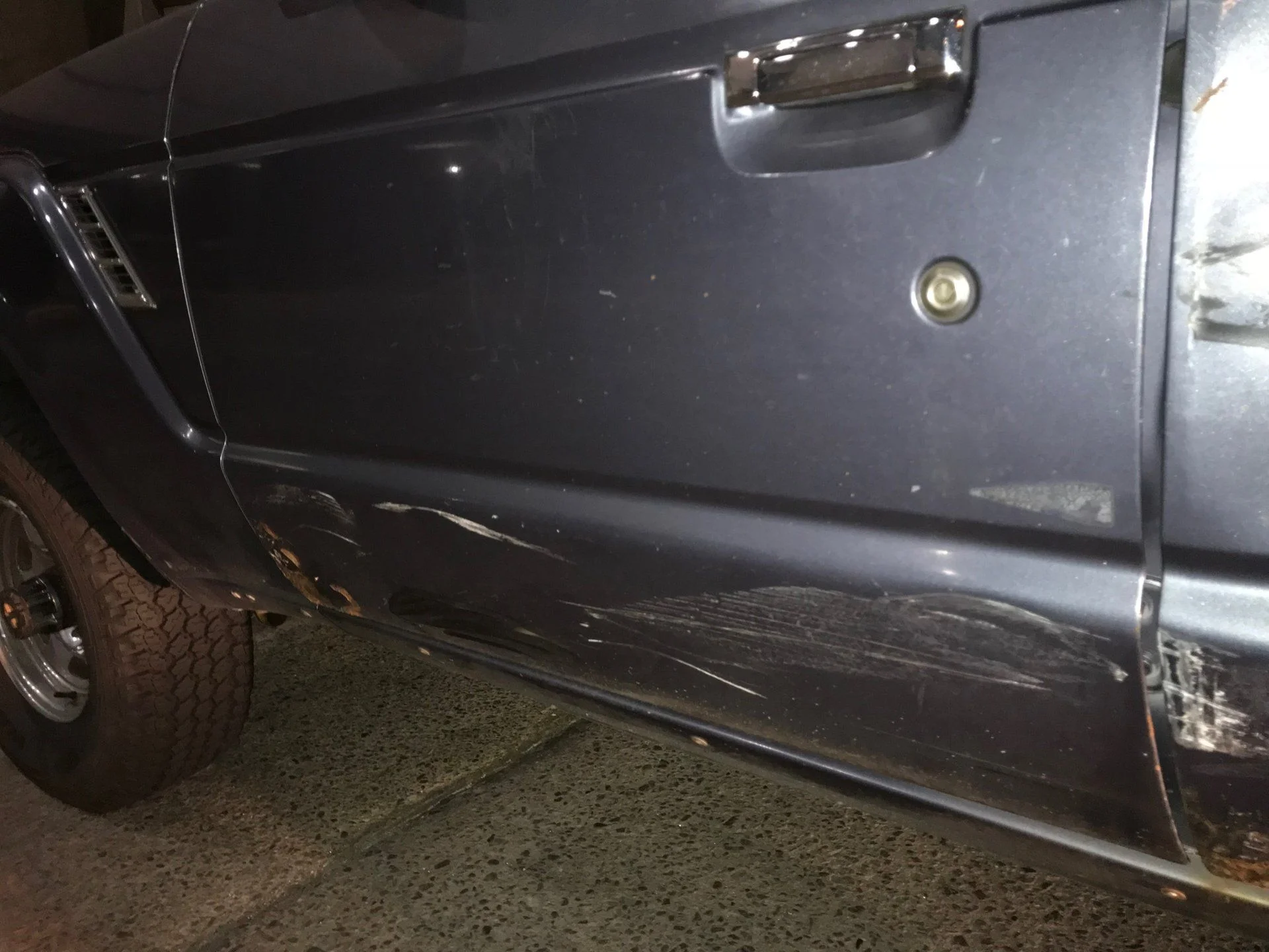

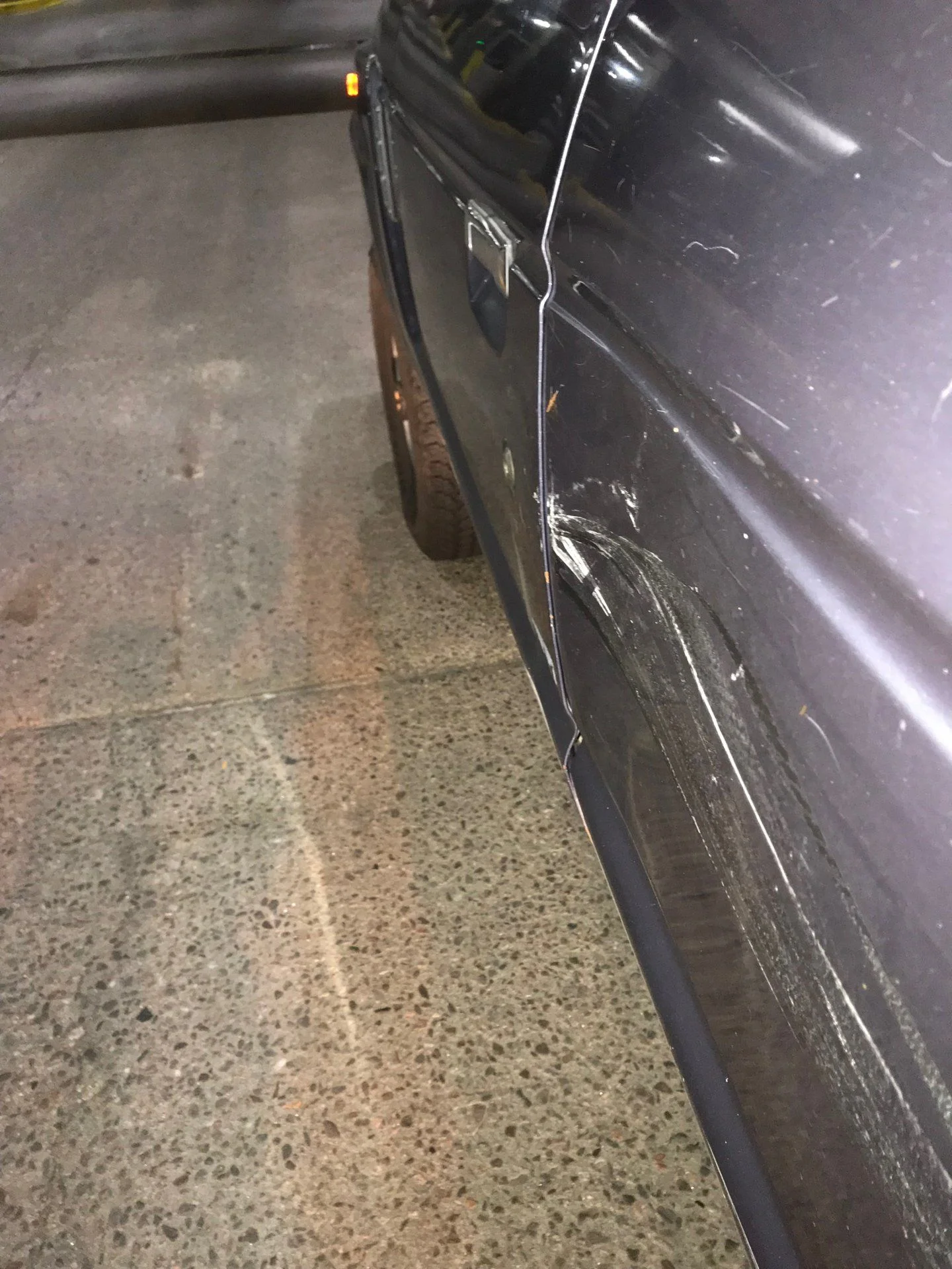

Hey everyone,
A sad day today. The driver's side of the Land Cruiser took a beating from (eh, maybe did more delivering of a beating to..) a little sedan today. Long story short, its first collision in 33 years :(
I guess I'm thankful that it wasn't much worse...but I'm still annoyed at the situation and myself for not avoiding it. I guess in the long run it'll be a small bump in the road to this Cruiser's slow restoration...
I'm still very early on in the process of insurance claims and all that greatness. But the coverage is comprehensive, so they should be issuing a check for the damage. What I'd like your opinion on is:
  1. Any recommendations for body shops with a good reputation for these older bodies would be greatly appreciated (Denver area)
  2. Most of the damage was contained to the driver's side doors. Both of those doors are rusting out at the bottom (especially front corners). I would almost expect the easiest/lowest cost option would be to find donor doors (I'd just need the shells), paint, and slap them on. But I'd be curious to hear if anyone thinks my doors are worth saving given the rust and now damage? Has anyone fixed similar rust on their Cruiser?
I guess the situation is bitter/sweet...okay, a LOT of bitter. But looking back it's almost reassuring how solid it all felt. Granted, it wasn't much of a collision, but still. Makes you appreciate the 5300+lbs of steel and iron :)
Anyway, thanks in advance for your advice! Here are some pics. I'll get better ones in the daylight.

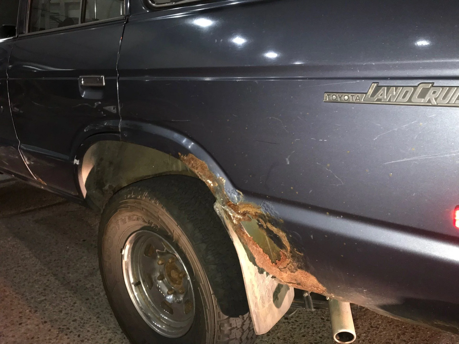

Maybe a little hard to tell in that first shot, but they left some paint on the rusty, gaping hole in my rear quarter panel. Pretty sure that'll buff out though, so no need to waste our time on that ;)
Take the check and cash it. Use it for more important things like transmission and engine issues. I'd just live with the scratches. Especially if there are more pressing issues to deal with.
I think that makes a lot of sense. Body work was always in the long term plan given the rust, but I do have oil leaks and exhaust issues to chase down.
I s'pose I could buff out most of it myself. The large dent in the left passenger door might be hard to look at for a while, but I could at least avoid the cost of any paint work...

One thing to remember is if they paint the doors it will not match the rest of the body. Take the money and either invest in good set of replacement doors (if they are rusted and badly dented) or mechanical.
If you are dealing with the rust later, paint the whole truck then.
For sure. Very valid point. That would almost look worse than the banged up door I have now and certainly wouldn't match its oxidized styling ;)

The door cards come off inside, the window unbolts and comes out, then the hammer and a few body tools go into un mangling the doors. Presto chango the truck is back to 80%. Yes, the experience of an accident or damage to a beloved family member (the truck) is bad but things will look up. Buff out as much of the other cars paint as you can and fix those oil leaks.

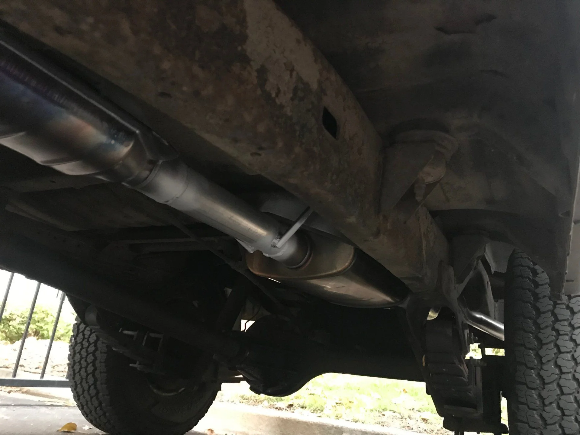

Insurance cut me a check. She's not totaled! Actually not even close. They quoted about $1500 of damage which was less than 20% of what "their system" says its worth (granted that's before looking at the detailed condition of the car, but still).
So I took the advice of "take the check and cash it" and spent that on a new catalytic converter, muffler and pipes. And holy s*#t! Probably some of the best money I've spent on the truck. I've been trying to hunt down a serious lack of power for a while now, replacing most everything I could think of related to fuel, spark, and air. Turns out the CAT was plugged pretty bad. It's running better now then I've ever known it to. It's crazy, she actually accelerates on the highway now :bounce: Not to mention how nice that muffler sounds!
That also seems to have helped with the classic stumbling issue around 1500rpm which I initially thought was the EGR. It was bypassed (maybe that's partly why the CAT was so plugged ;)). But un-cappied those two vaccum lines for the EGR and it doesn't hesitate at all.
Anyway, long story short, I can live with the damage until I'm ready to do body work and I've got a daily driver that I'm actually excited to drive again!
