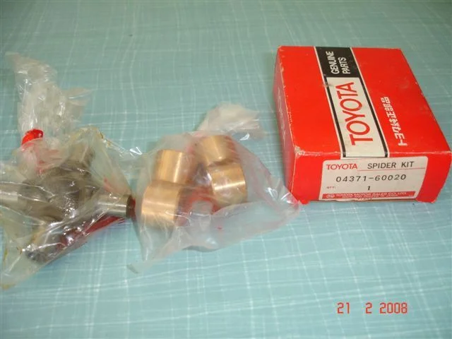

This is on my shelf.

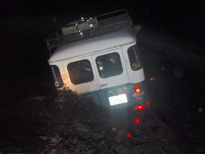

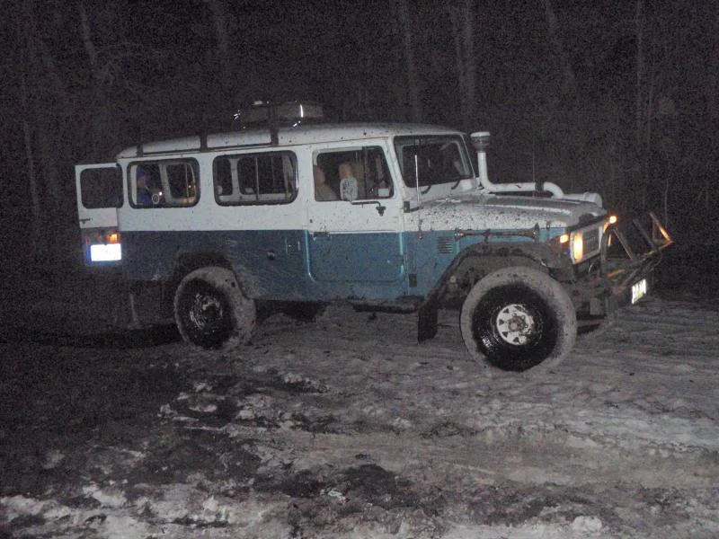

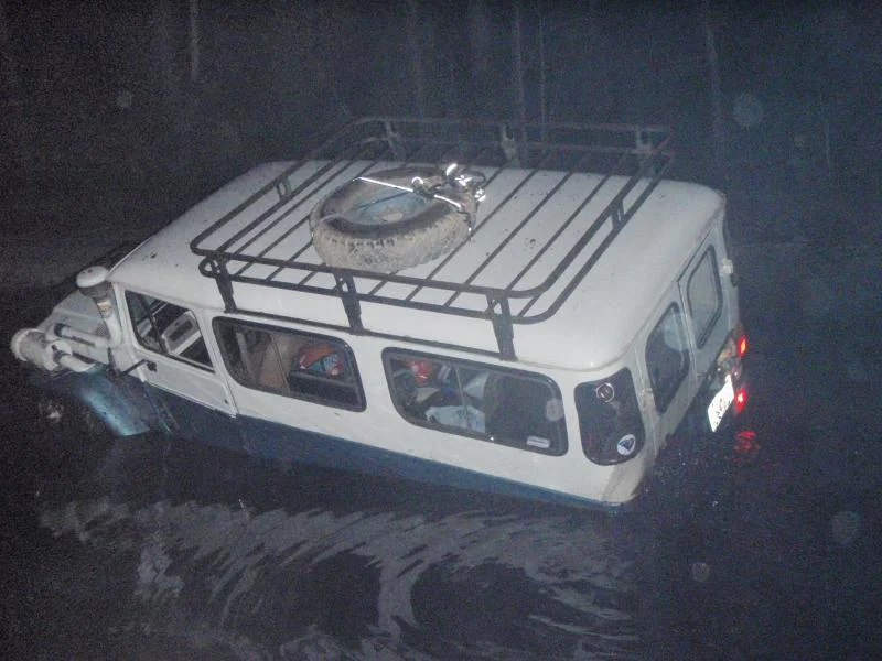

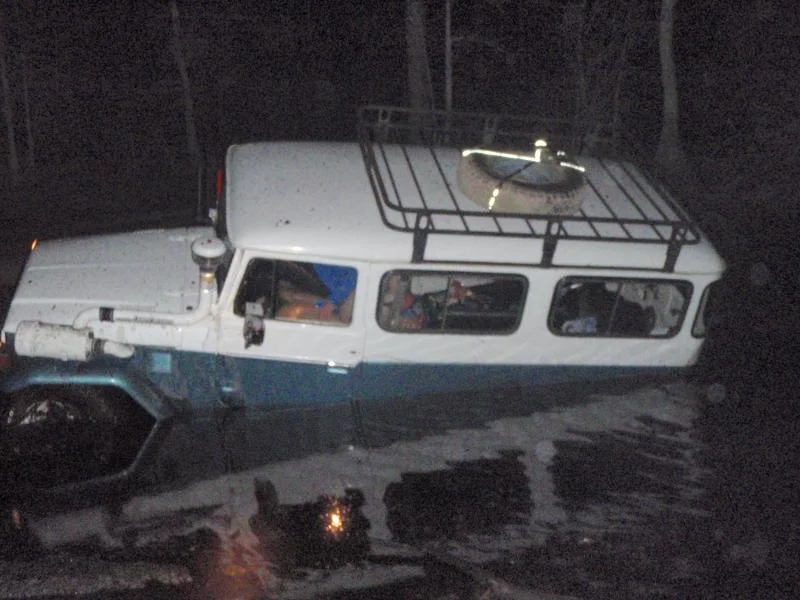

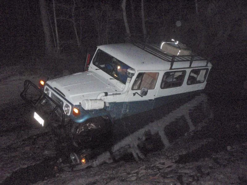

Hey Pete! It was a very nasty "swamp mud" hole. I hit it with a little speed so I'd have the momentum to carry myself through it, but the hole was pretty deep in the middle. So as I tried to stay to the right and keep my right side on dry ground, the left dropped in, where there was no firm bottom, and all my weight shifted to the left side anyway. The stuff was pretty nasty. Out in this particular area, swamp buggies rule the roost. We're talking tractor tire-equipped monster truck-sized vehicles that can deal with the deep water and mud that you find out there. The BFG A/T's are absolute crap in the mud, so they were only a hindrance. The mud here just serves to fill in the tread and give you "slicks". The guy who finally came upon us said he has one of the "biggest buggies out there" and still makes sure he doesn't go near that hole - it's deep, slippery, and he's seen way too many buggies that couldn't get through it, let alone little stuff like my troopy. I was kind of happy to hear that and know that I had little chance of making it, regardless of driving ability, lol....:p
I suppose this thread is not "useless without pics", but I figured they might be appreciated, so see below....:D

MoCoNative: That's a nice little site - will have to bookmark it! You are right...they do show the part number Pete listed and lostmarbles posted a picture of. Not cheap at $43/ea (considering I have 3 that I was considering replacing, not to mention spares while they are still available....) but good to know there might still be a place I can get them!
BUT....
Am still VERY curious about the 2 different part numbers Pete mentioned. According to toyodiy, they recommend the 04371‑10011 Spider! :confused: So can I even use the 04371-60020?? Are they the same part, just one number superseded the other?? I sent a PM to cruiserdan yesterday but have not heard back...:meh:
