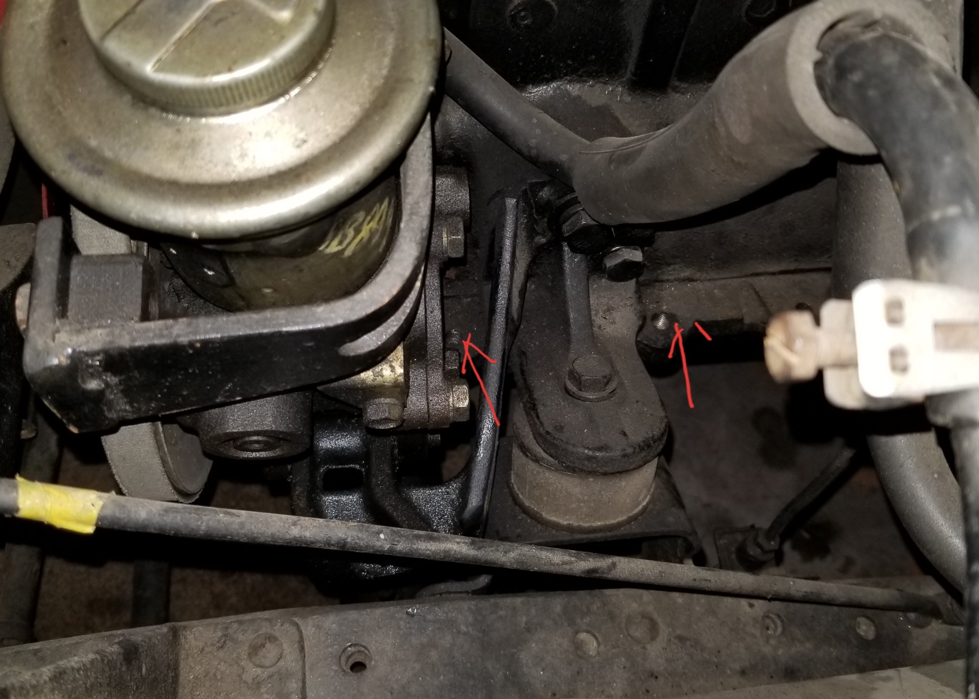

Thats where I got mine. @orangefj45 Great set up and bolts right up using the drivers side front motor mount holes in the block. I went to the junkyard and found a Volvo power steering pump the already had the wider v belt pully

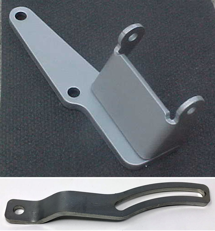

Our bracket, shown above by @landcrusher909 , will do the trick!
You can run the factory air cleaner but you’ll have to rotate it towards the driver fender slightly; just lengthen the bracket that attaches it to the cylinder head. We’ve done the install many times, looks and works great.

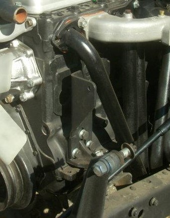

I wheel often in deep water and I wanted to get it up higher so I fabbed this up. Lines up nice, is stout and does not flex.
And some day I'll get the whole conversion done. :(

That gray bracket looks like the one I need if it slides under the drivers side motor mount and the hole spacing is something like 4" center to center. Now, what's the contact info for Mark? Is it Mark's Off Road?
