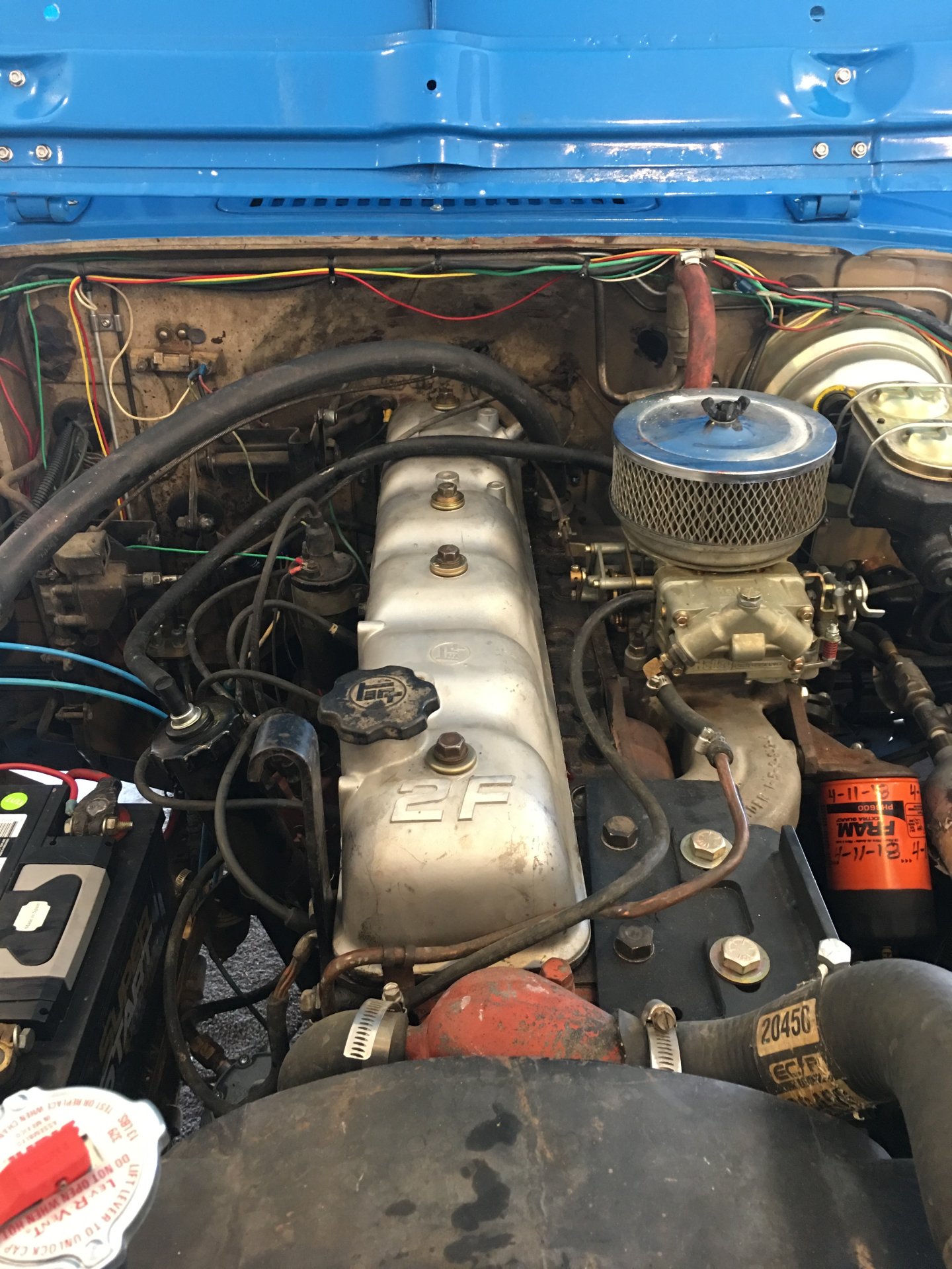

I guess I've already got that bracket, just never been really happy with it.
You could try Mark's bracket and see if you like that better. I can't tell from the picture if the PS box would interfere.

I tried Mark's mount, pump bumped into the Scout box. Mark made me a taller mount, for free, still won't fit. So it'll probably work on other 55s, just not mine.

Yup, tried that one too. Forget why i didn't like it.
I guess i did get this from Georg years ago.
Wish i could align the pulleys better and had a more secure mounting. Haven't had a problem in a while, but it chewed up belts quicky at first.

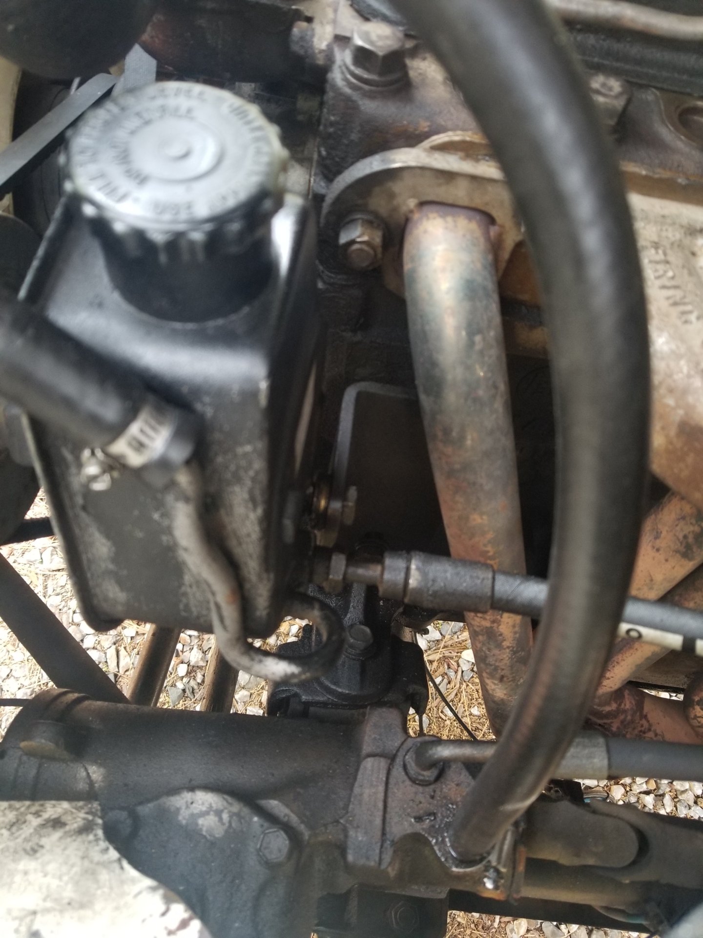

So, landcrusher909's bracket is probably home-made? He is clever that way.
It looks like he added a plate that attaches to a Georg bracket. Maybe to space it forward a little. Maybe he'll provide details.
@landcrusher909
@landcrusher909
Yes I used the bracket I got from @orangefj45 Valley Hybrids and found a scrap yard that had a few Volvo's I used the factory Vovlo bracket that came with the pump drilled a few holes and spaced it out to line up the belt. Here is a picture of the back of the pump you can see the Volvo factory bracket. This was 9 years ago and no leaks or issues
I was trying to find a number on the pump to narrow it down as I remember the pump and brackets came off I think a 76-'84 non-AC 240 Volvo The last picture shows what I started with. I drilled out the Bill Doren bracket to mount the back side of the pump, Using the lower bracket to use as a tensioner and bolting it to one of the lower water pump bolts. Thanks @pjohnson I tried the lower brackets and could never get it to line up correctly after using the ones from @orangefj45 I have done 3 others like this. Plus the Volvo pully works well with the wider belt.

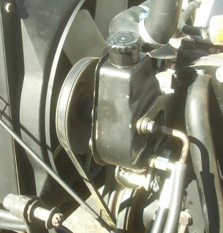

I'm installing PS on my '73 40 and looking for a vendor source for a PS pump bracket. I've already relocated the alternator to passenger side and plan to use a Toyota pump (from an 80s Tercel wagon.) I've got an F motor and would like to retain the stock air cleaner. Anyone know who might still make a suitable bracket?

@Pighead do you mean a P.S. pump bracket like this? I`ll get a better pic tomorrow.
I've decided to fab my own bracket since I can't find one that utilizes a Toyota pump on an F engine. Anyone have any pics or measurements of brackets they've made? What thickness of plate is recommended?
