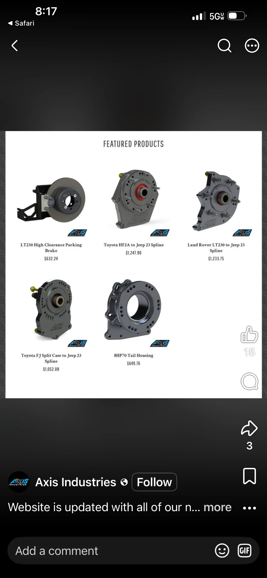

Reach out to axis industries to see if they make what you are after. They used to sell adapters (case AND spline) to adapt the Landcruiser T-cases behind 23 spline jeep trans.
I say used to, because none of these are on their website any longer….i pulled these screenshots from past Facebook posts
View attachment 4215108View attachment 4215109
Yes, I’ve contacted them about it, but they needed a 10 quantity at $1500 or one at $5500. They have actually removed the kit after I contacted them about it, so I’m forced to make my own kit
