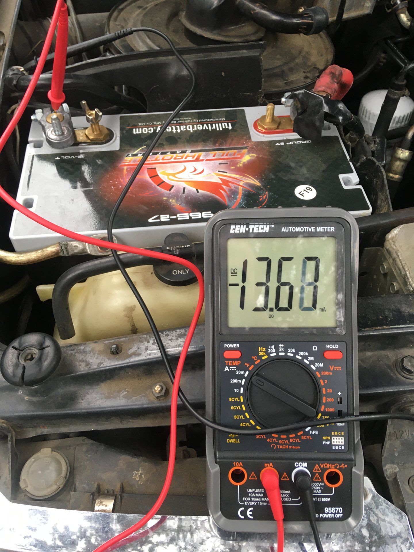

Something is causing a draw when the vehicle is off. I’ve got a multimeter but I’ve never used one before and nobody around with experience. I’ve done some reading but decided to just beg you guys for a hand.
How much of draw is there supposed to be? I took a pic of the reading on my multimeter, hopefully you can tell me if I’m using it correctly. What does that number mean? 13.65 ma is way too high right? Which setting should I be using. I’m as green as it gets when it comes to this.

The pic

I agree your reading seems off in that 13mA seems TOO low. I would try measuring current draw again using the positive side and be sure to plug the red probe into the 10A spot on the multimeter like @landtank said. A 13 amp draw would def kill a group 27 overnight.
And I do that the same way I measured off the negative side? Red line to battery, black to cable?

According to the first picture he is measuring correctly, although the probes are reversed giving him a reading of -13.68 mA because he's measuring off the negative terminal.
It's possible that meter has internal current limiting to avoid blowing it up. I would simply take another reading with the probes reversed to be certain. If the reading is in the range of 20-30 mA of quiescent draw (everything off, doors closed) I would call that good. At that point you're just reading the clock, ECU, and radio.
IMO, a draw of over 30mA is something to be concerned with, depending on what other doo-dads you have installed.
