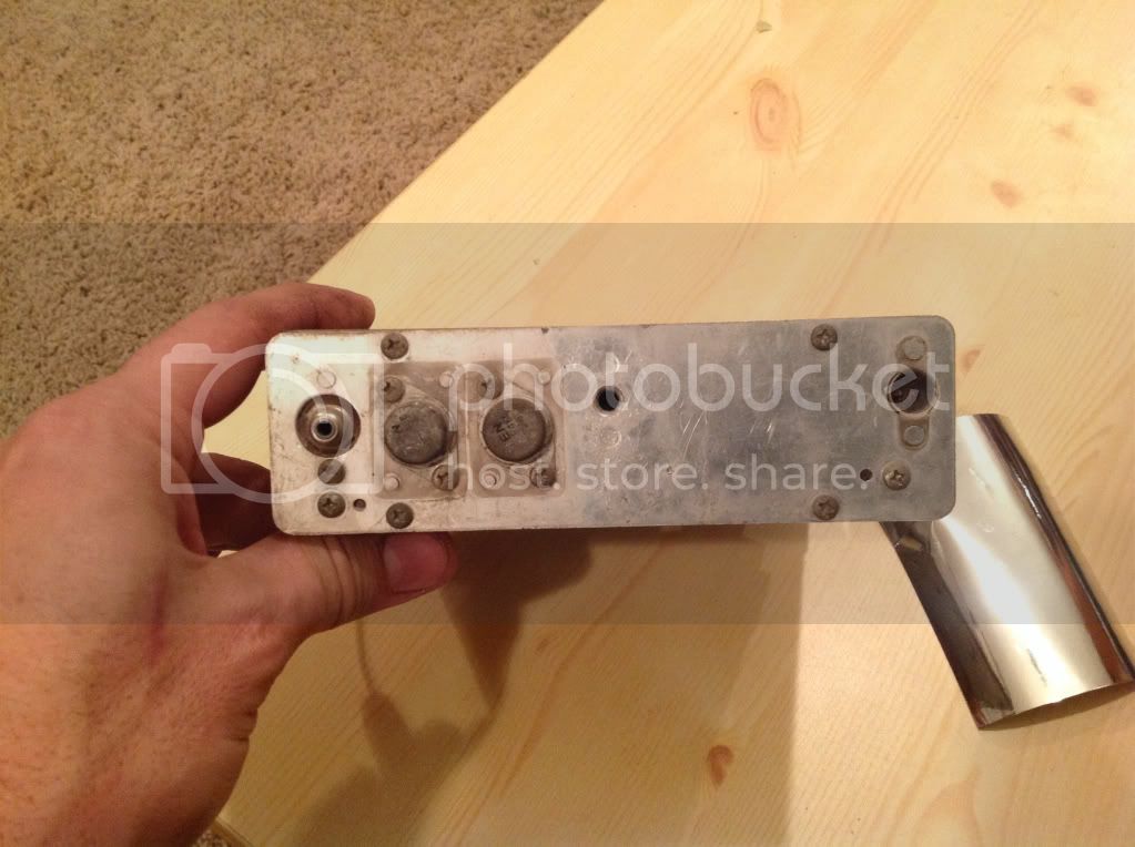

Can you post a pic of the back of that radio?
I want to see if there is the trimmer. It should looks like there is a screw below/under the housing which you can turn through a hole.
Rudi
I just remembered that the antenna trimmer can also be found behind the face plate, around the tuning knob.
For adjustment use a plastic or ceramic screwdriver. NOT metal.
Tune in to a weak station on the high side. Turn the trimmer for maximum reception. The trimmer has no stop so you turn it 360 degrees.

Nothin under here.
But might be the screw on the right side about half way up the radio. You can turn it either direction and it's on the side of the tuning knob.

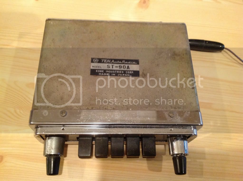

looks very much like the fj55 radio i posted in this thread: https://forum.ih8mud.com/electronic-toys/469434-40-55-series-shaft-style-dual-knob-radios.html
Looks to be in the 67-68 time frame from the number
can you add your pictures to that thread... for reference

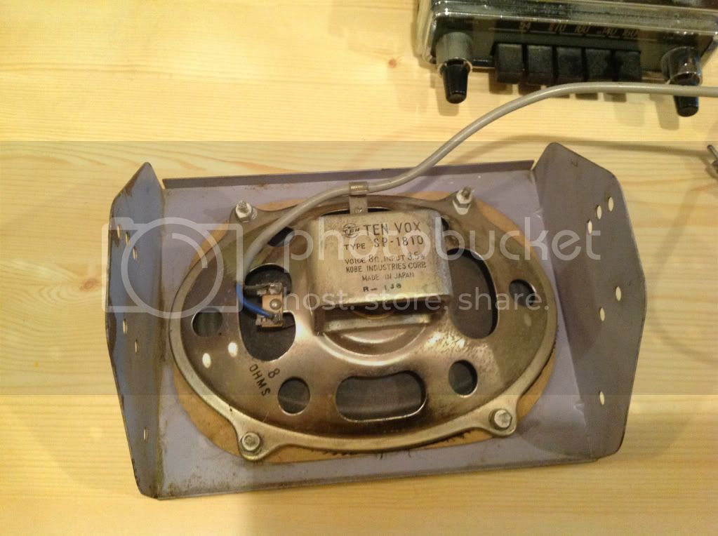

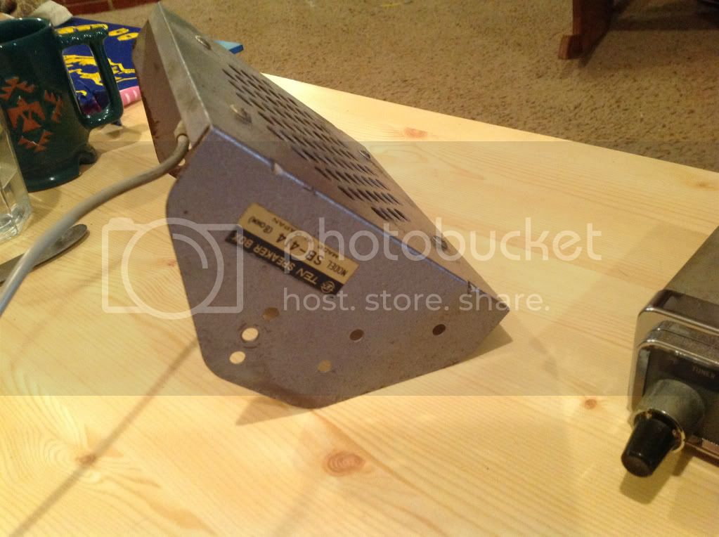

the speaker box have any numbers besides the sticker? printed on cover?

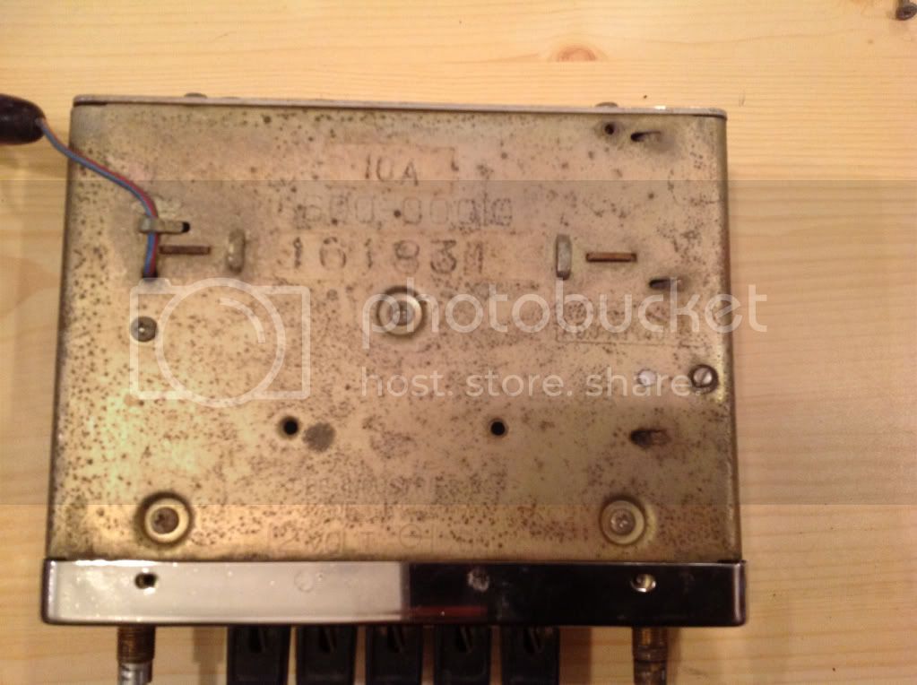

can you make out the TEQ part number printed on the radio... looks like 86600-00010?
The number on the radio is 08600-00010 with 161831 stamped in ink.
No numbers on the speaker box, just the sticker and the ones on the back of the speaker.
