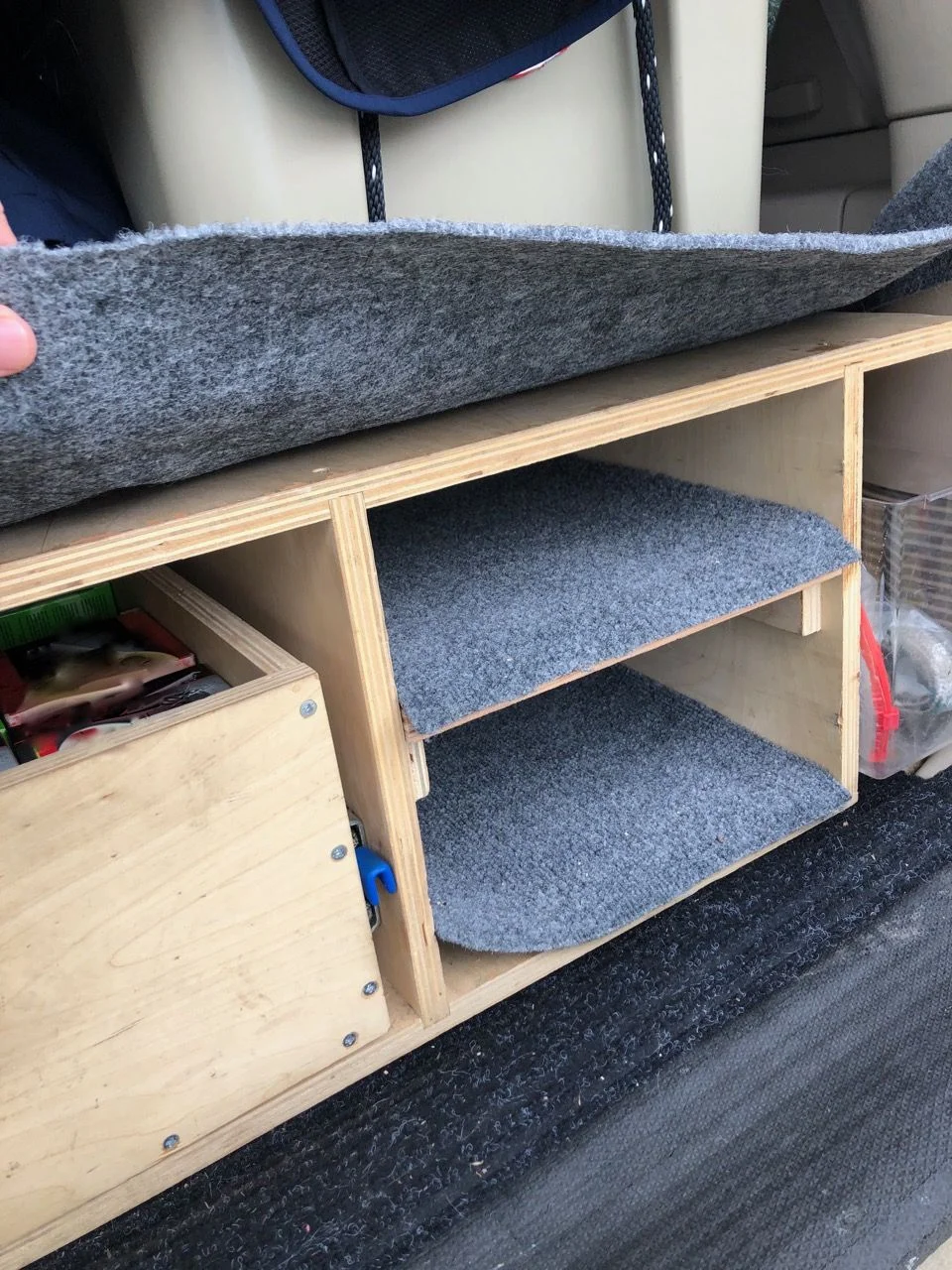

I have been slowly building out my 2004 LC for camping, and am ready to add a slide for my Yeti.
My time is in short supply so rather than build one from heavy duty slides I am thinking of buying a purpose built one from Dometic or ALL-TOP on Amazon.
Do any of you have experience with one of these slides? Or perhaps have another recommendation? Here is the base where it would be mounted:

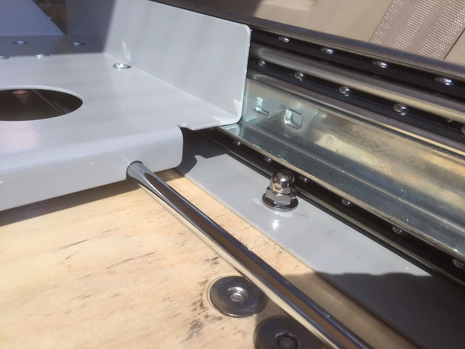

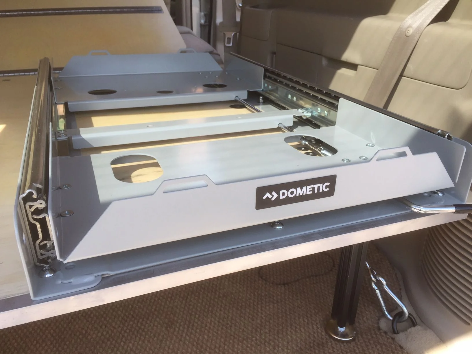

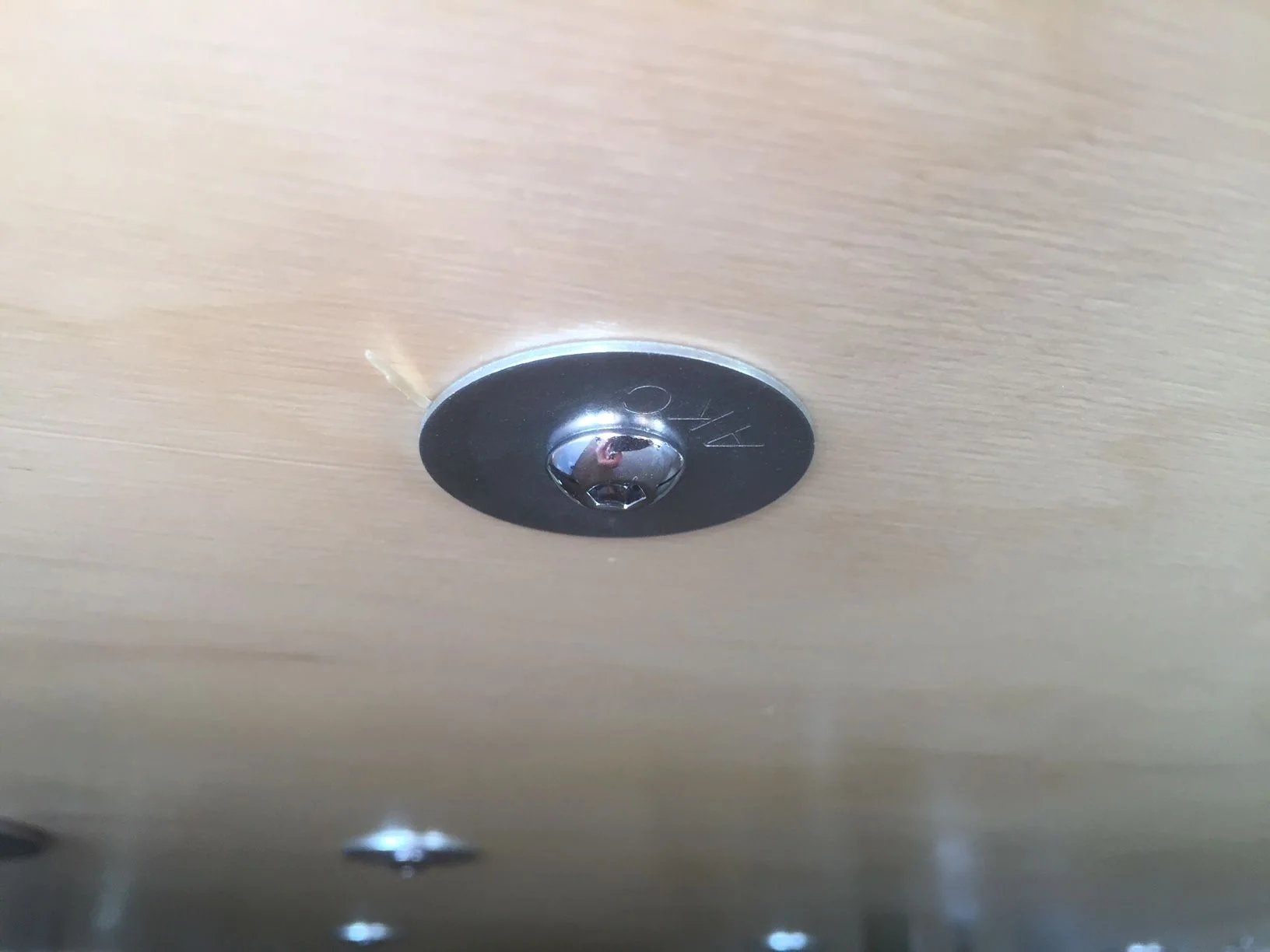

I mounted a Dometic slide a few days ago on a similar wood platform but have not had a chance to try it out yet. I used 5/16 button bolts with large washers mounted upwards to minimize snagging when I slide things in the shelf under the platform. Although to clear the slide mechanism I had to mount the three front bolts downward and use cap nuts.
I was amazed at how heavy and well built it was and it seems like it should be rattle free. However, it sits really high and I kind of wish I had sprung for a tilt slide.

I have the Dometic as well. It works fine and it's pretty heavy duty, especially for the price. As @terrapin said, it will be pretty high up on that platform. Mine is mounted on the floor. I'll try and find a pic. I use it with my ARB as well as a regular cooler on occasion.

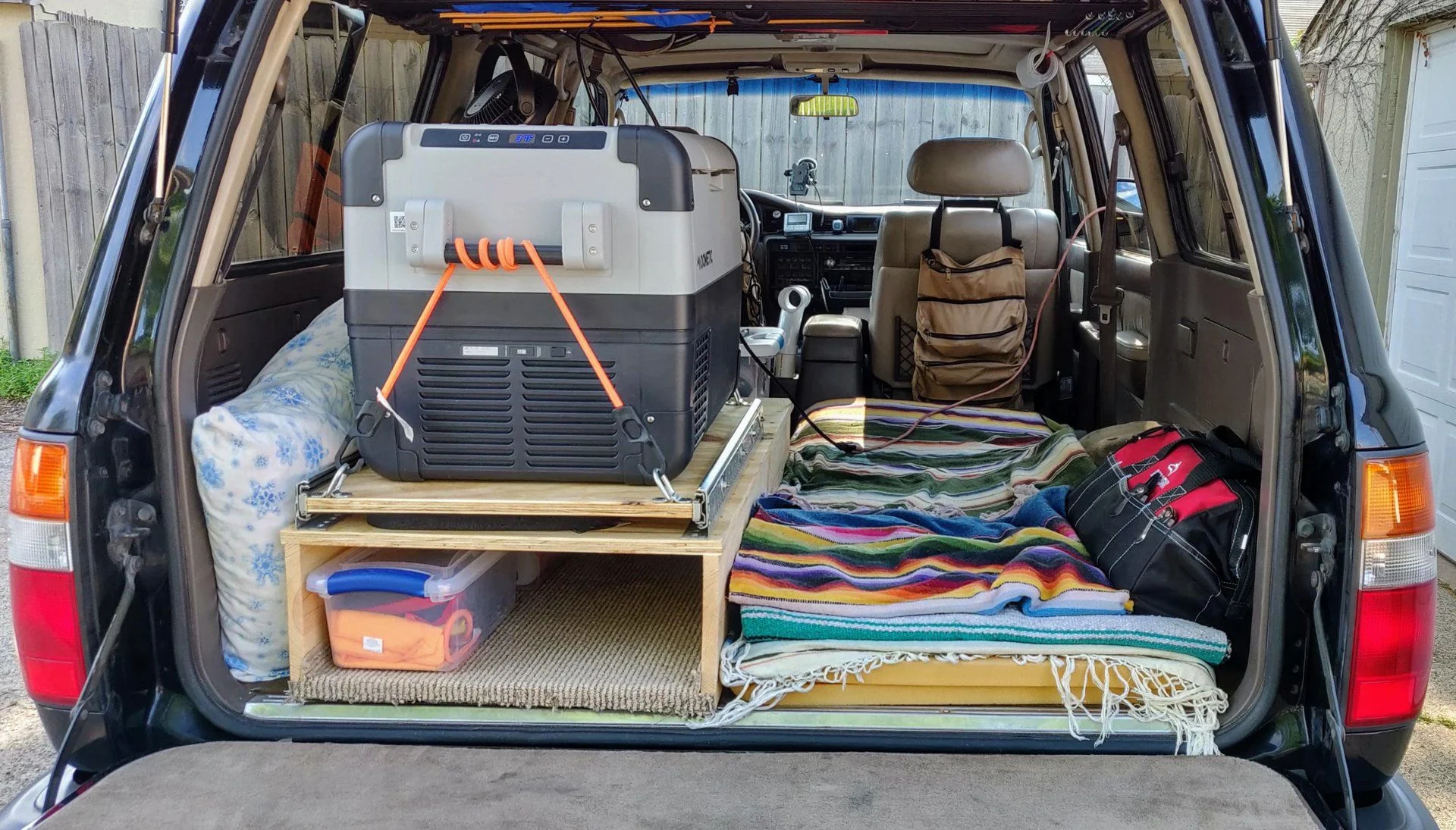

Why don't you just make your own slide? With your platform you are at least 50% done. Looks like you are in MN? I just made my fridge slide and sourced the 250 pound rated, 28 inch slide from a place in Burnsville. Way, WAY cheaper than getting that Dometic slide and a lot less weight for sure.
That looks great. Could you share specifics on the build?

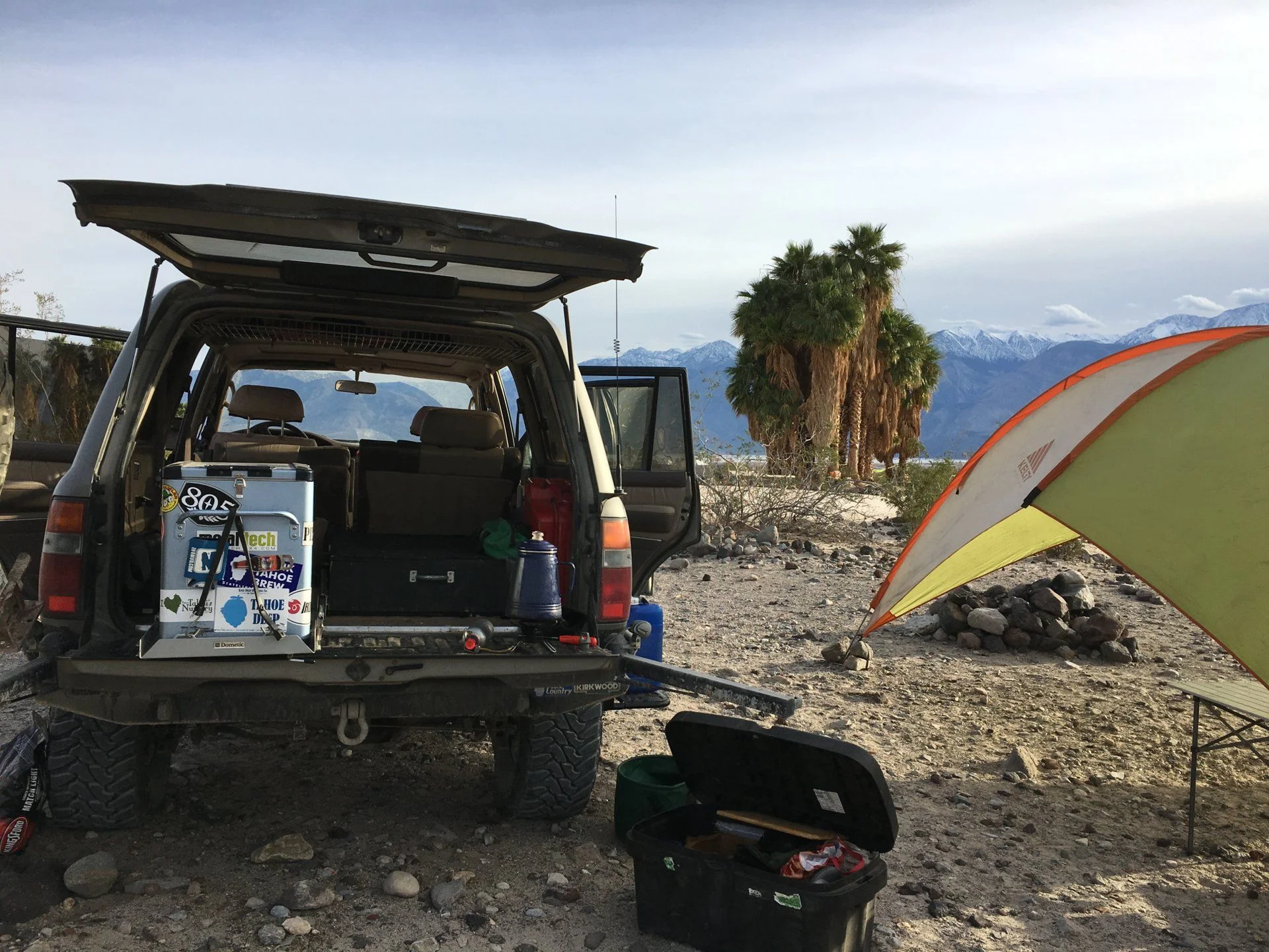

While I have the ability to make my own sliders, just like I have the ability to assemble a car … why would you when a better product is available off the shelf. I bought the extra long ARB. It holds my fridge (now an ARB50), and a Pioneer 5 gallon jug.
