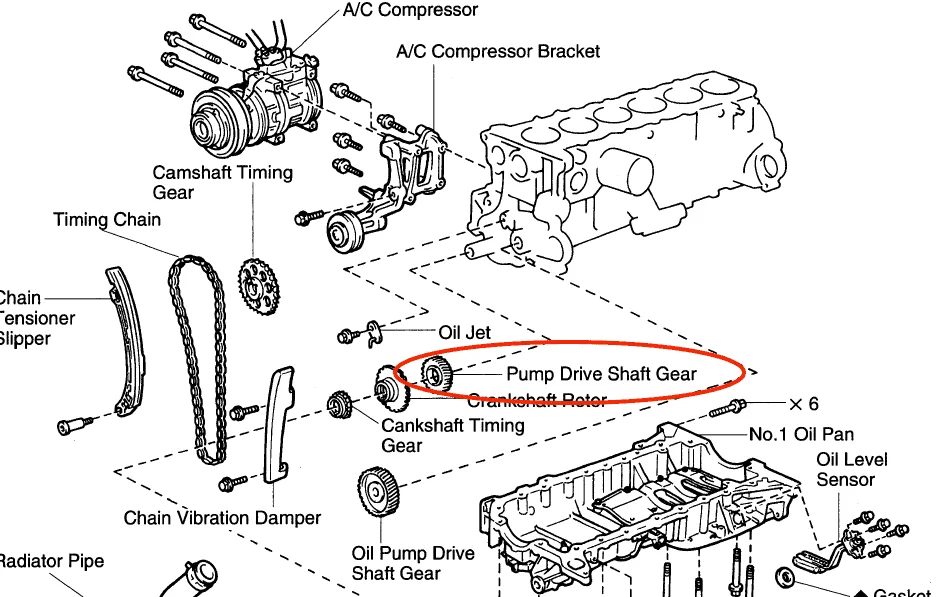

I'm assuming it's this gear behind the crank rotor gear? Looks like oil pan, head, timing gear, has to come off just to replace that gear.
I think you're 1 gear off. I believe the PS pump gear is run by the oil pump gear. However, there are guys on the 80s forum that know this stuff cold. I would ask there before trusting anything I say...at least on this topic ;)
