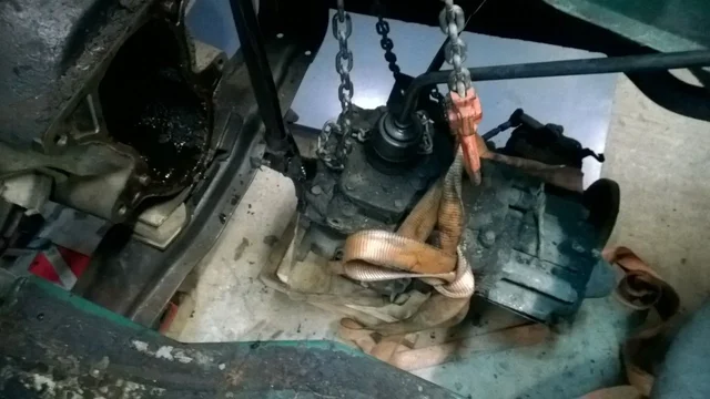

While in the process of getting the transmission out to replace a slipping clutch I got stuck the
stage:
I have it on axle stands, the idea is to lower to the ground. It came back about 1 inch but now seems to be stuck.
What's the trick? Should I split the bell housing form the transmission? Or is is something else?
This is the type with the PTO, so maybe that has to some of first? Or tilt the engine backwards?
This my first time dealing with such a heavy transmission, I am used to much lighter stuff. (Also first time posting.... )
Any advise much appreciated.
Is there a dust shield on the front of the bell housing that is hitting the flywheel. I think most people do separate the transmission from the bell housing when pulling the transmission. Once the input shaft clears the pilot bearing/bushing you can angle down the tail end to gain additional clearance to get it out the rest of the way.
It should just come apart, make sure you're not hitting the rear crossmember with the transfer case and that absolutely EVERYTHING is disconnected. Triple check that.

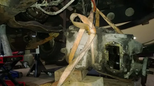

Update on the clutch:
Taking off the PTO and spitting it from the bell housing did the trick, it's out.
With the PTO off I had enough room to pull it out.

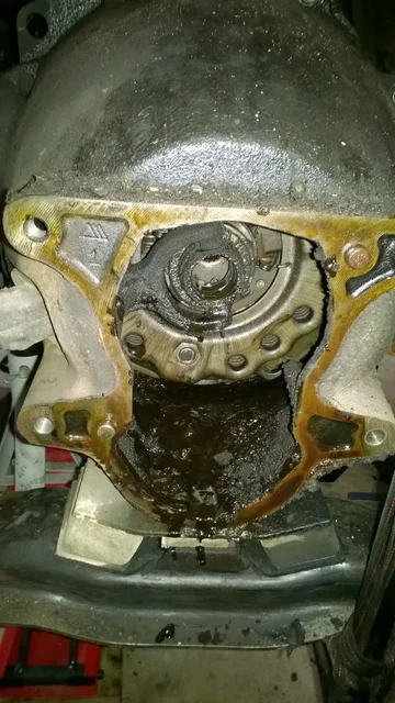

Also I think I found the problem with the slipping clutch. Too much oil :)

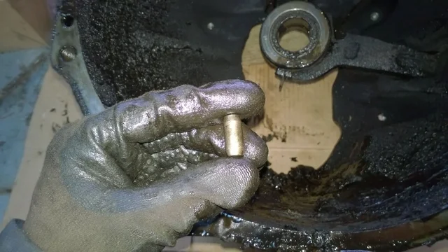

Any idea what I found in the bell housing?
Locating dowel pin for the transmission, should be two in the bell housing.
plan on rebuilding that transmission..
Hi Mace, I hoped I could get away with putting in new seals, but I am afraid you're right. Maybe I'll go for a 5 speed. Does that take the same clutch? I bought the replacement plates and clutch assembly already.
yep, 5 speed uses the same clutch..
