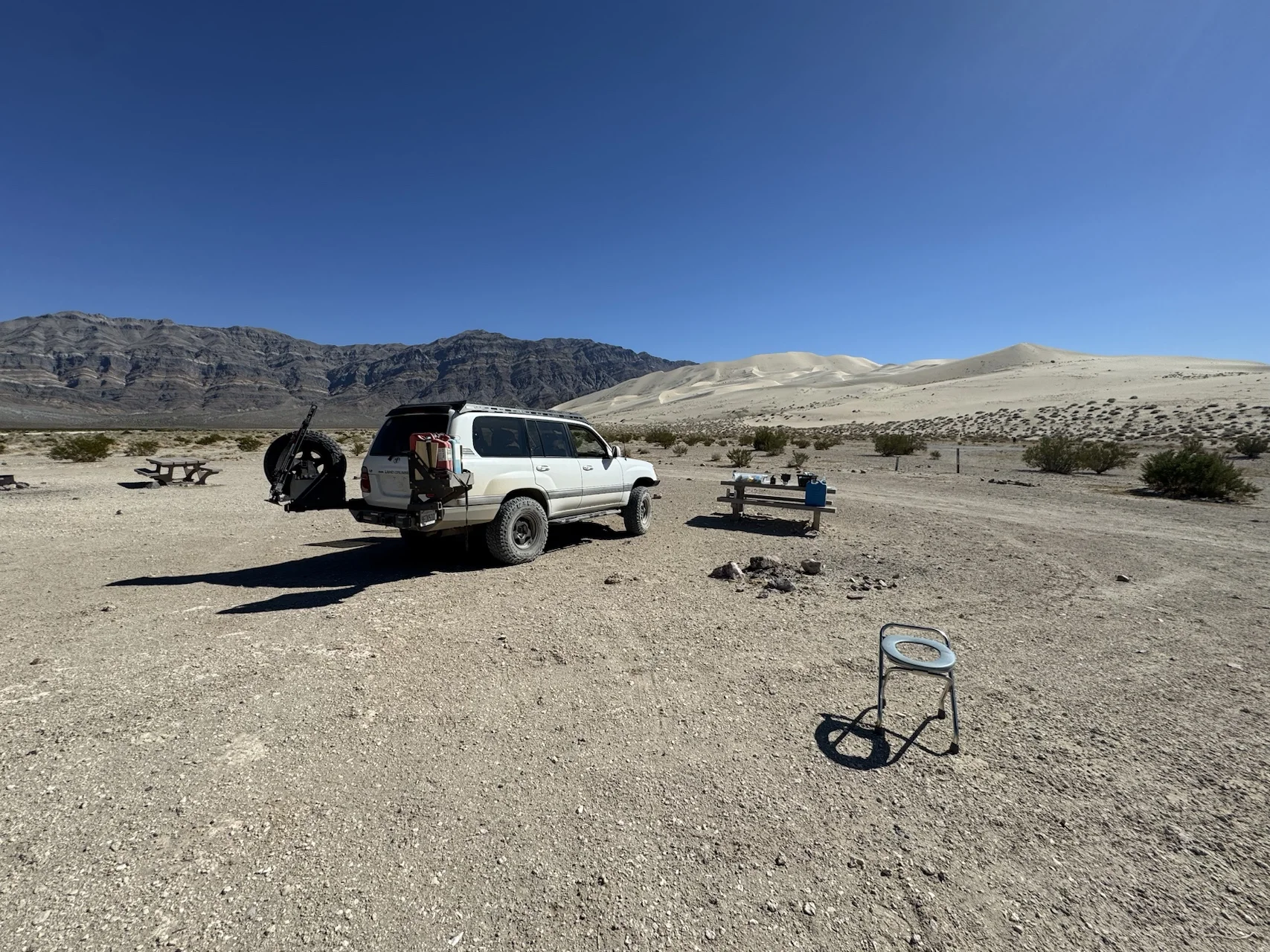

You got a jerry can carrier?
I can load 3 cans, one gas two water (plastic jerry cans).
Then I’m opting for regular water gallon packs. With sticker/ plastic wrap = drinking water. Without = washing.
Having 1.5 gallon per day per person has always been more than enough. Keep in mind: you’re max staying a night alone as someone else can go and get help…
Bandaids and enough beer! Hasn’t been mentioned before.
Attached mine at Eureka Dunes with “the exhaust side of things” 😂
U joints and beer. Check. Jerry can carrier and roof rack being investigated. The second row seat delete /storage / sleep platform looks interesting
